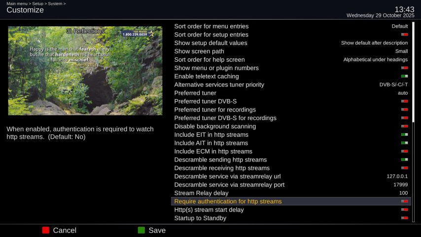

But still, with most current updated TNAP 6, when I try to stream via webif, or an app like Potplayer or VLC, then I'm presented with the login screen shown above in Post #1 or similar. Entering the original login credentials still doesn't work. It just prompts again. What other login info is there for the box?

When all else fails, search using Google. I found the answer from a 10-year old post on another forum. For some reason, authentication was turned on for streams. When I turned authentication off, then streaming was possible again. Based on the symptom, this makes sense.
