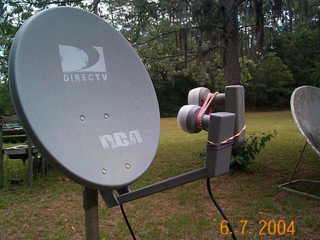

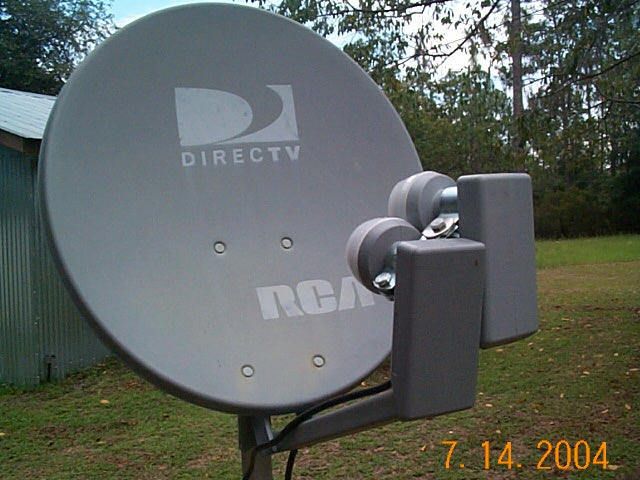

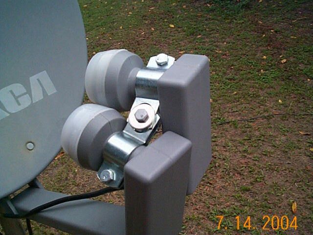

Impatient said:
Nope. It has a receiving angle of 3 degrees. Rainbow 1 is at 61.5 and the new one is at 72 degrees. So, they are too far apart, and require an elliptical dish that has multiple focus points to catch both birds.
Sorry but you are wrong, You could even get it with a 18" dish.
All you need is a lnb, and buy two pipe clamps under two bucks as my pics show and your in.
The pics shown are for E* one at 110 and one at 119, so it can be done if you are inpatient waiting for a V* oval dish.
The pics are not of my dish they are of pics I found on the internet.
You can also do it with ruberbands.
Who knows if V* sees this they might come up with there own version for a quick fix to there existing customers until they can catch up with their new dish.

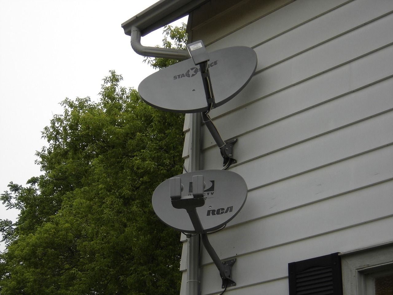

Here's what an eliptical dish might look like for Voom...
OK well can one of you tech savvy folks help me figure out how far apart these two birds will be from one another? 9 degrees mean nothing to me. In other words, will the position of our current dish need to be changed? or will the new dish (in the same location ) be able to pick up both birds?
I'm concerned because I have lots of trees (the current position of my dish is the only clear view).
__________________
Don't get caught up in the technology of this too much. When they have the Satellite and when they have the channels I think they will give us what we need to receive it.
My reception is great and I love it. Don't try to fix something that isn't broken.
The top dish is what voom will most likely use, willing to bet on it!
