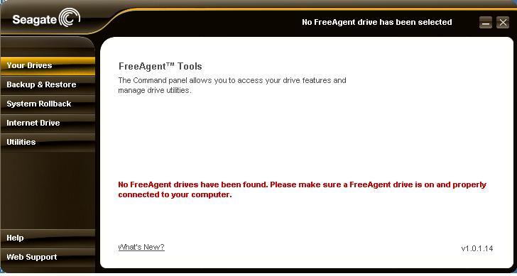

When you install it, it installs freeagenttools.exe, which is correct. I told them I wanted to turn off the "sleep" mode and thats the link they gave me.
It installs this on the drive or on my PC? Readme seems to say it will ask where to install and says to select the letter associated with the Seagate. Won't this cause Dish to reformat it when re-connected and therefore lose my recordings?
I went to the chat and got the zip file but I don't see a utilities option I am not a windows guy but do have to plug in the drive to pc and put the tools on the drive to get that option thanks
I chatted with a seagate tech and he told me that you can only make that change on a pro model but I still did not see a utilities option in that zip file
I chatted with a Seagate tech and he told me that you can only make that change on a pro model but I still did not see a utilities option in that zip file
I don't know what to tell you. It worked just fine for me and I have a Desktop model.
at this point I think I'll try leaving my 622 on. I went ahead and disabled the inactivity option so it won't turn off and see if that works until I find that download. is there anyway to copy and paste in this forum? other people seem to be getting the same desktop recovery exe, maybe we didn't talk to the right rep at seagate.

1. Connect my "FreeAgent Desktop External Hard-drive" to my PC. (In my case, I have Windows XP for my PC and the HD which was reformatted by MOXI was not recognized. I had to click yes to "initialize" the HD when asked upon physical connection. To get a letter designation, I went in to Control Panel / Administrative Tools / Computer management / Storage / Disk management and found that the new HD was assigned as Disk 5. By right-clicking the black bar on the right side of the Disk 5 entry, I got a "partition…" option which eventually got the Windows XP to give the new HD a letter designation - J.)
2. Down load a "desktop-recovery" zip file from www.seagate.com/support/freeagent/desktop-recovery-efigs.zip and save it in the new "FreeAgent Desktop External Hard-drive" - J. This file contains the recovery software that can reload software to the FreeAgent Pro drive in the event that the original software was missing. In my case, this software was never offered with the HD - FreeAgent Desktop Drive. This zip file is very large (196 MB). It took 20 minutes at 127 KB / sec to download. This is the first file of the entire procedure.
3. After unzipping, the recovery software can be executed. It installs the "Install FreeAgent Tools.exe" on your new FreeAgent HD with its support files. The unzipped file is the second file and the "Install Tools.exe" is the third.
4. Run the "Install FreeAgent Tools.exe" program to install "FreeAgent Tools" in the Program / Seagate folder of your C-Drive which is the fourth file of the procedure.
5. Run the "FreeAgent Tools" to set the sleep interval to "never".
