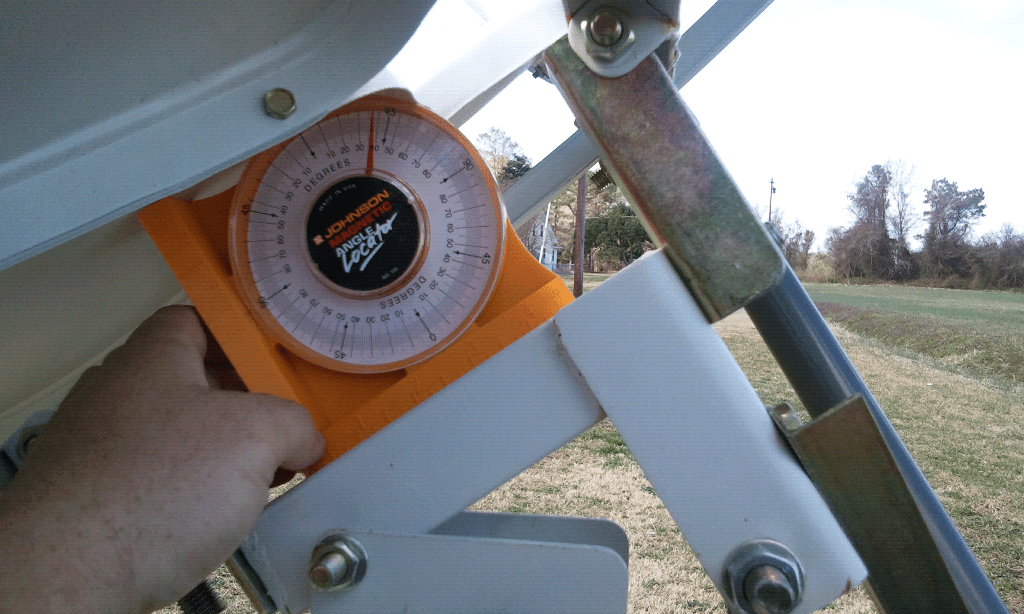

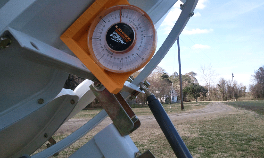

Yeah where do I put my meter for correct elevation.I need a step by step I sweat onceci get it ill be dug.lol
I know you guys r getting frustrated with me.so it goes on the square tube closest to the dish.I've been sticking it on top.I'm gonna add pics

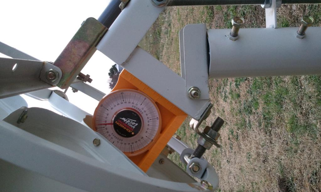

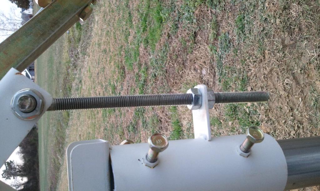

If you can look at my pics here.my first 2 showed my meter which is correct. Also the next 2 my long elevation screw I've been going from 36.5 to 47 .which is the correct one for this screw. Also 72 w has only one cband transponder is it even on

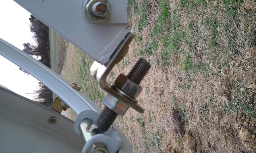

Ok I set my elevation to 37. Now what do I need to do making progress here

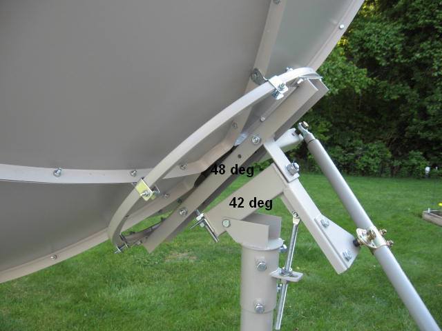

Did you checkout the video i linked above!it does explain things abit.Heres my dish!The declimation angle in my case is 48-42=6.(the differance between the two angles).

Here's what I did. I set my elevation on my polar axis angle to 37. I put the meter on the ring and I got it to 42 degrees adding my declination.I'm I correct on that and how come my elevation is listed as 47.7 and my lattitude is 36.5 which is what I'm guessing I set my elevation too on the polar axis angle.I'm slowly understanding it
ok lets see if i got this right!If your latitute is 36.5!then Looking on the modified polar chart that gives you a elevation angle of 37 and a declination of 5.22.so you add 37+5.22 making the polar angle 42.22. So your 37 would be my 42 and your 42.22 would be my 46.
That's how I have it set now.gonna try looking for a signal again later.aleast I feel I have something to work with
