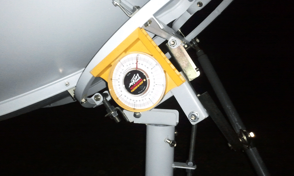

Thanks for everyones help. Here is whats happening.its set as described.the 47 was what I was getting at the top of the back ring. My signal goes from 2 to 42 and like 6 to 8 quality.the quality doesn't move much but the 2 to 42 is a fast moving like a pulse.think my cabling is bad.it was a piece I had from my old directv install from a few years back.I'm puting a pic of where I got my declination setting is it right f so I have my angles right

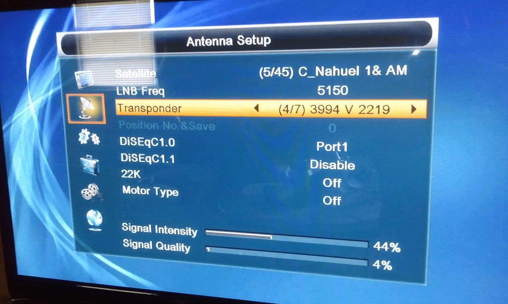

Doug is my last picture right.I have two receivers the openbox and the nfusion nova. Settings are standard 5150 frequency. It is a dmx741u and its cband so I thought I could keep it on standard
Ok I read some things I've had my lnb at the 6 o'clock position and I learned it has a built in disque switch so I guess I need to set that as well. Think that will change anything for me

Make sure you have active TP's programmed.
24/7 TP's on 72w I have: 3995 V 2220 (DVB-S ?) and 3937 V 2825 (Pretty sure this one's S2).
(PA cable net moved off this sat a while ago, The LIST needs an update here, it's now on 83w)
Standard C band, 5150 L.O. is perfect for settings.
DMX741U, I think diseqc should be port 1 for C band, The Ku settings are not needed until later.

~5.8 (the more accurately you can measure and adjust this makes all the rest a bit easier, as inaccuracies will show up as not tracking the opposite side of the arc as accurately, but don't worry, there's an easy way to fix it)
polar angle = (latitude 36.5) or 90 -36.5 = (53.5 polar elevation)
your post #59
Why does dishpointer give me a elevation of 47.---
(53.5 polar elevation) - (dec. 5.8) = (47.7 dish elevation)
36.5 + 5.8 = 42.3 = the dish extreme angle (90 - 42.3 = 47.7=arc elevation at zenith)
or (polar elevation 53.5) - 5.8 = (47.7 dish elevation, at the highest point in the arc)
The only difference in the above numbers is the reference, so they are 90+_ and measured with the other face of the angle finder.
Pic 1 in post #60 looks to be measuring polar latitude ~37 OK
Pic 4 appears to be measuring Dish elevation ~47 OK (add these two numbers with dec, =~90, thats good)
Pic in post #64 is measuring "extreme" angle, subtract reading from 90 for the elevation, or measure as previously in post 60.
I would think you should be close enough to give it a go.
Your most south sat is 72W, a bit east of your location, so move the dish a bit east of the center, (it's highest) with the actuator. Dishpointer.com has a azimuth of 172.8(true) so move it about 7 degrees. dishpointer.com has 72w at an Elevation: 47.4° Which confirms the calculations. moving the dish off of center will lower the dish elevation. SLOWELY, and in SMALL incrementws, twist the mount on the pole, and wait for the receiver to lock signal. Lower SR's require more time. 10 seconds is not unheard of. Once you get lock, peak Q with the polar elevation adjustment. Then move the dish, WITH THE ACTUATOR ONLY, to sats further and further from center. Adjust the Azimuth, (twist of the mount on the pole) ONLY, to peak your Q readings. When you get all the way to the end, lock it down and check the elevation at center again. If only a very small correction is necessary, you should be good, check the other side of the arc. You should track C band perfectly, before attempting Ku.

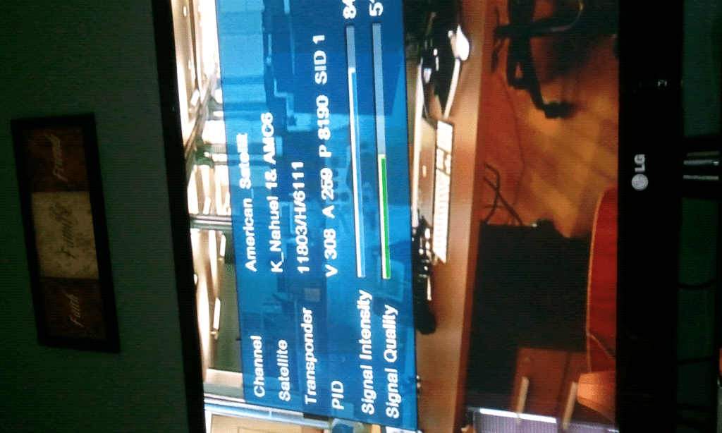

What channel is this it says I'm on 72w ku transponder 11803 h 6111 v 308 audio 259 p 8190 sid 1. Its was a transponder already on the openbox.crazy is I'm getting nothing cband which leads me to think its nit 72w.

Mac, I'm not sure as you might not be on 72W. Did you blindscan it? Hopefully a channel or two might pop up and it will make it easier to identify. My worst nightmare was my first attempt at a fixed KU dish. Took me over a week and I finally got my cousin who installed cband back in the day, to help me. Within minutes he had 97west for me. I've hacked my way thru enough stuff over the last couple of years so that I've got it down pretty good. My main setup I wont adjust, touch, or sneeze on it lol...i works and I'm leaving it as is. I will say I can line up a cband dish in about 5-10 minutes now just by knowing where it should be pointing and dumb luck too. Ku is still a hassle at times. Hang in there your doing good so far. Blind
If that pic that you posted is what was received, your on 72west but on the Ku side. Your Dish settings (LNB)(Switch) must be set on KU ?
As you can see on the Link below, there's not much to get at 72w on CBand.
Nahuel 1 & AMC 6 at 72.0°W - LyngSat

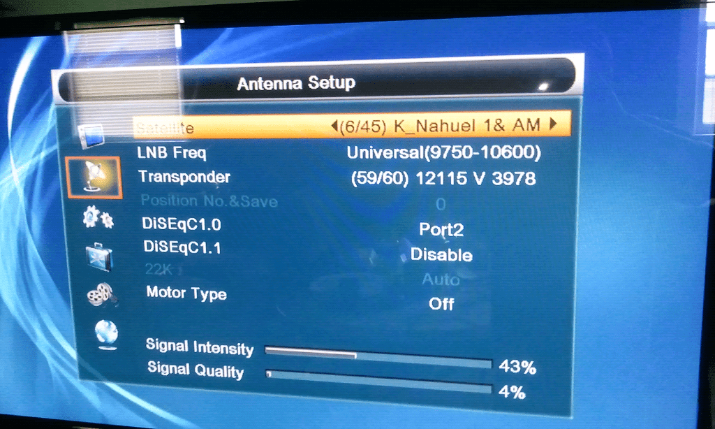

I haven't been able to find the TP you reported. Double check the paperwork that came with the LNBF for proper settings and connections. FWIW, picture: 741U CKU C and Ku Band Linear Circular Universal Ku HDTV LNB LNBF for BUD and C Band And that Ku is UNIVERSAL so i'm thinking your LO setting is not the actual LO so the reported TP actually isn't 11803 h 6111, but 150 Mhz higher/lower (10750[normal] -10600[universal])11953 Or 10750 -9750 for TP at 12803, Heck, it could be a C band TP also. (& the polarity might be actually vertical) (I do have an active Ku tp with 11781 H 6110 on H2 - 74w) 72W just lit up on 3980 H 26680 Strong!! Just another thought- disconnect the Ku portion of the LNB (Remove jumper) Then there is no confusion as to what band/freq - the lnb is standard C, 5150 L.O.??

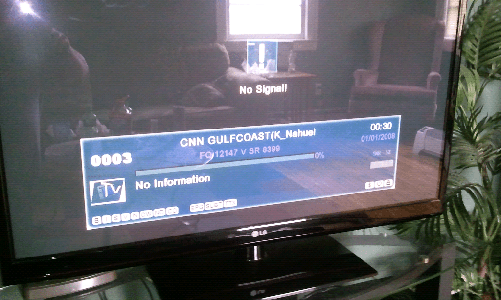

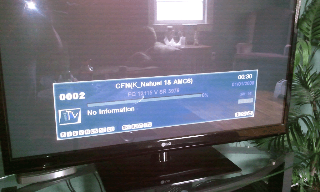

Ok guys I've been outside sorry.I continued this morning and played with my focus on the lnb and moved the elevation up just a tad and I got these two channels.the cannot gulfstream was 1080i had about 30 quality but played for a bit.the other was 480i. Both were feeds the cannot one had a nasa guy.anyway I continued to bump the actuator and I lost signal but I figured id wait till my gbox came later and let it move it for me.I have not touched the azmith on the dish cause I was scared id lose 72 if it was what I had. Here is the pics
