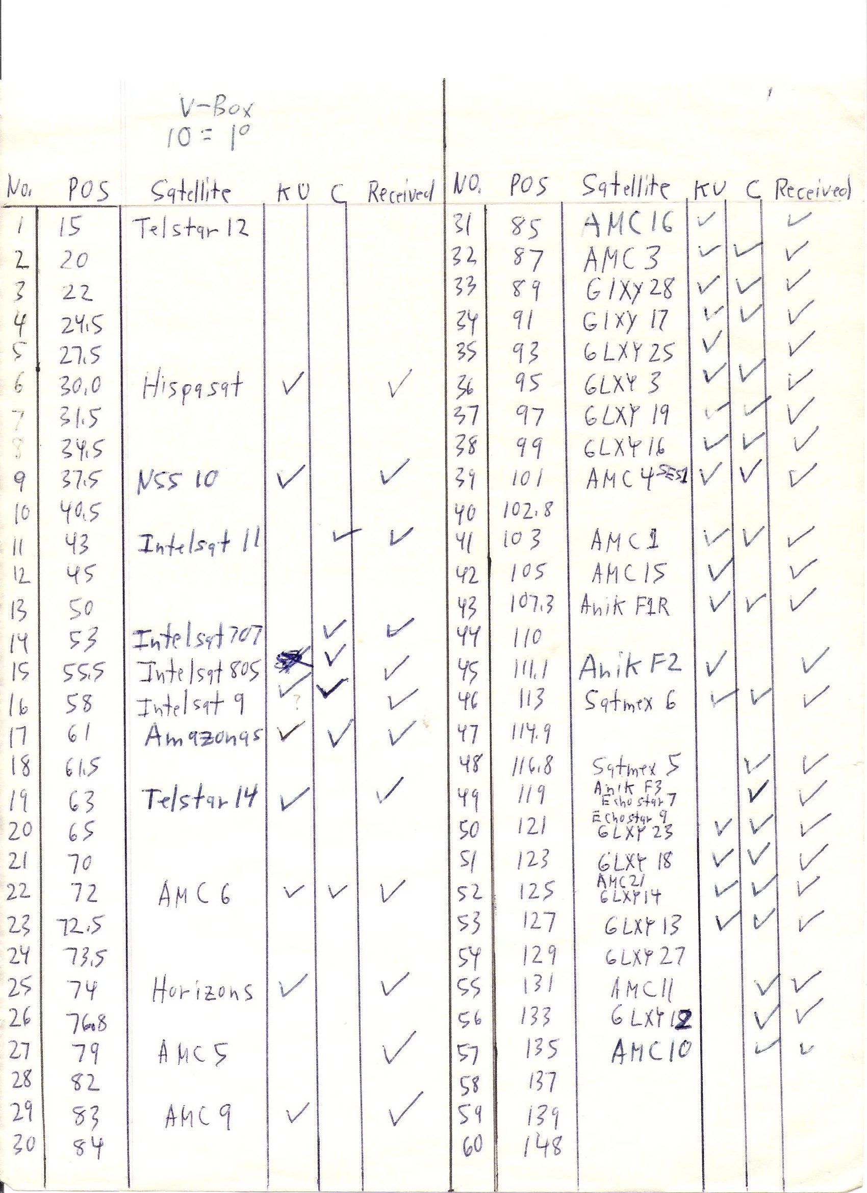

On the KU side! see if you can get RTV and Tuff on AMC9 83w 11735/h/4440. On the c side PA cable network should come in on 3805/v/4166.Depending on which v or g box you have you can calculate the number of button clicks (pulses) it takes to move the dish 1 degree!For me its about 10.So if my box shows a number of 100 for 72w then 110 would be 73w and 83w would be 100+110 or 210.This isn't an exact way to find where a satellite is but should get you into the ballpark.For now i would just keep going one satellite at a time east and west of 72 and see how many you get!this way you can find out how good your tracking the arc.Save the p number on your g box every time you get a satellite lock.Example!! for me 72w is p22.and 83w is p29! To store all known satellites i could get in order i make p1 as 15 west (telestar12) to p59 139w(AMC8).Heres a chart i made for my satellite tracking.
