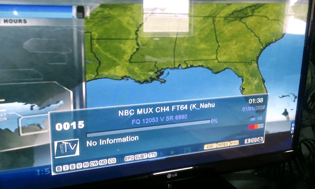

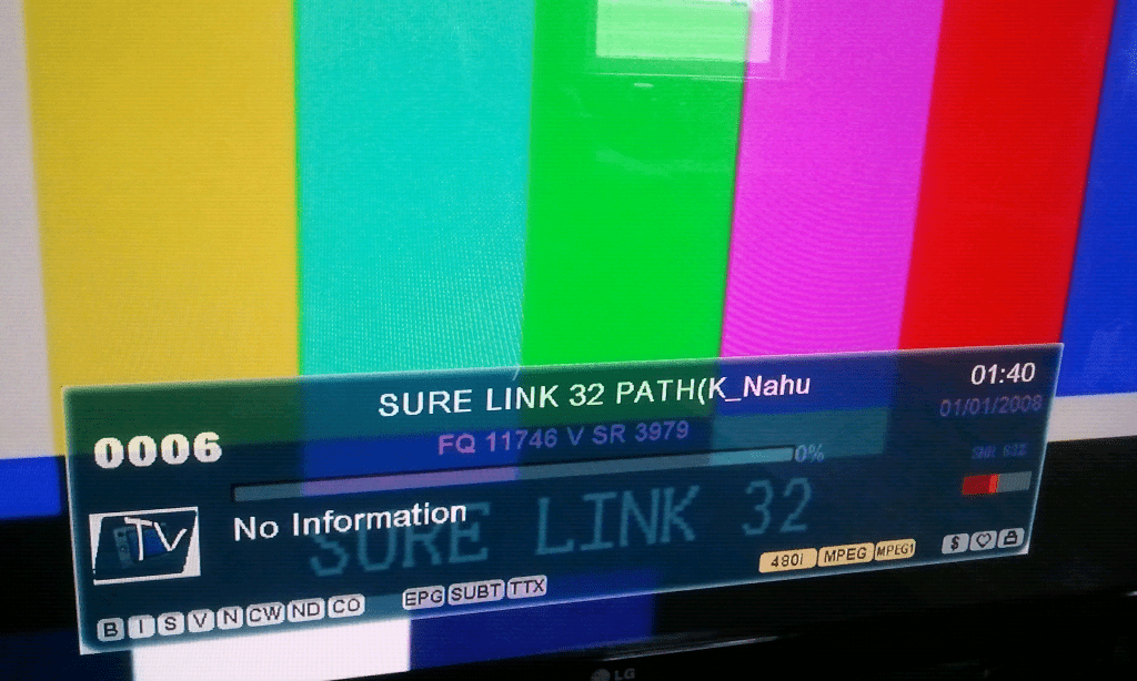

Feeds that disappear make it near impossible to tell where you are. I have a feeling you're on H2 at 74 as it does not have any 24/7 TP's. Really have to find a 24/7 TP to know where you are. (Even if the freq is reported incorrectly, because of incorrect programming) If you haven't moved the dish since those channels disappeared (in your last pics) do a blind scan. sr 3977 looks popular on 72w
I've moved it cause I am hooking up my g box.is how far out is my actuator supposed to be out at my zenith
Yep! your on 74w Horizon. Did a scan and came up with what you got The Tp that LAk7 mentioned above is the NBC Mux channels that are just about always there on AMC6 72w ku PS good Progress! your on your way now!!

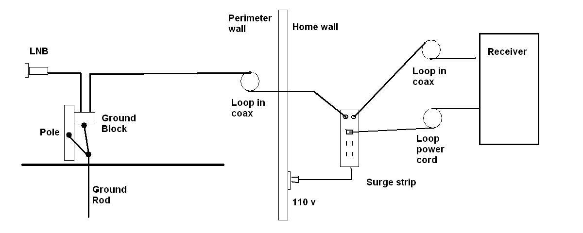

How do I ground the coax wire?
You'd mount a "GROUND BLOCK" on or near the dish and run the coax from the lnb to it, then to the receiver. Ideally, there would also be a GROUND ROD buried close to the dish, that is also wired to the ground block and dish pole. ( if the mount pole is buried, I think the "CODE" still requires a ground rod. )
DO NOT install another ground block, or ground, inside the house.
Surge supressor power strip, yes. I also put a loop in wires just before they enter the house, and loop the power cord and coax of my receiver going to the suppressor strip.
If there are any unused wires that run from the inside to outside, ground them at the dish/ground block/ground rod ONLY. Never inside the house.

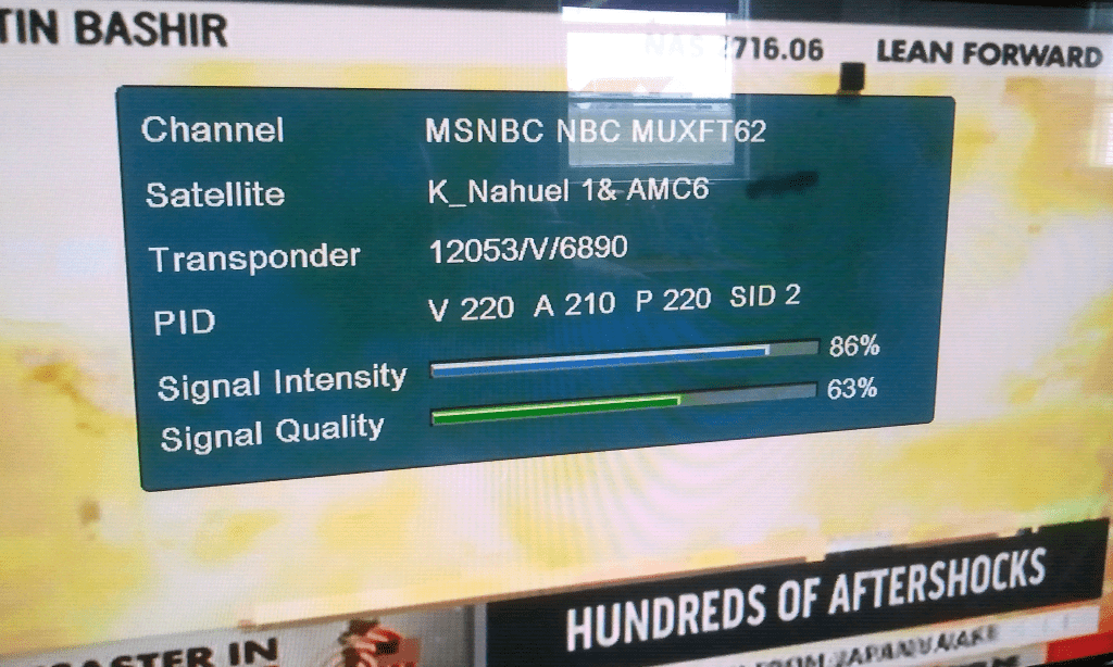

Ok guys update I rechecked stuff lined my dish true south put it on the nbc mux on 72 w and bumped the gbox east a bit and boom it lit up.I scanned sure enough I had the four nbc mux (msnbc weather channel) I then put it on the cband side and scanned and the ion networks showed up there ill post some pics in a few
Here is the pics
