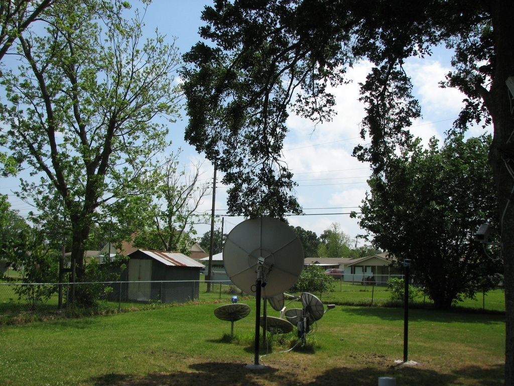

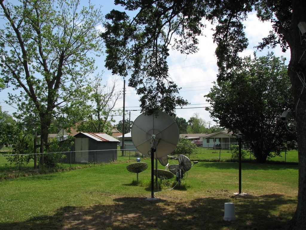

Ok, I have a new problem but that's nothing you guys can help me with. There's a tree limb that hangs low over the dish. Well, we are having strong winds today and the limb is whipping around and it comes down and touches the dish. Frequently. This is not good..
The only thing I know to do is take the dish back down, throw a rope around the limb, tie it to my John Deere and pull the bleeping thing down. Redneck tree trimming.. :rolleyes:
Actually there is one over where the BIG dish is going so I'll need to pull that one down too.

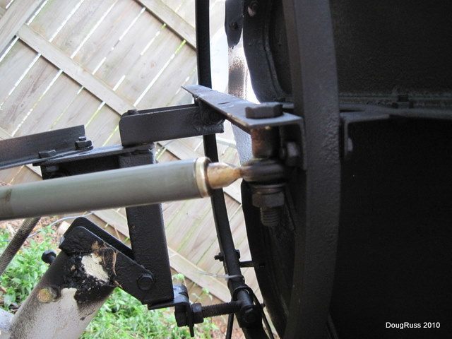

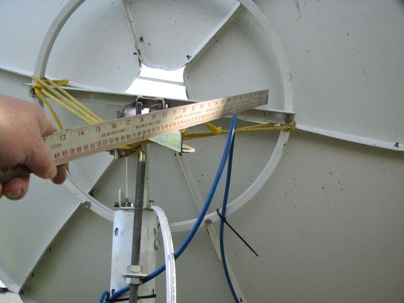

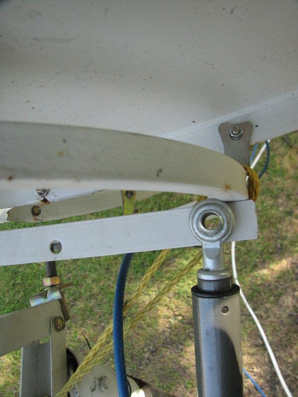

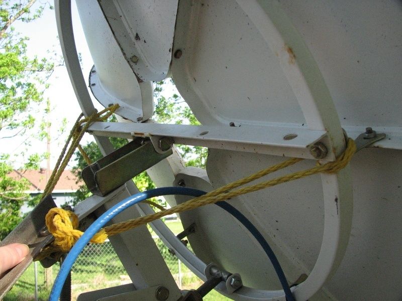

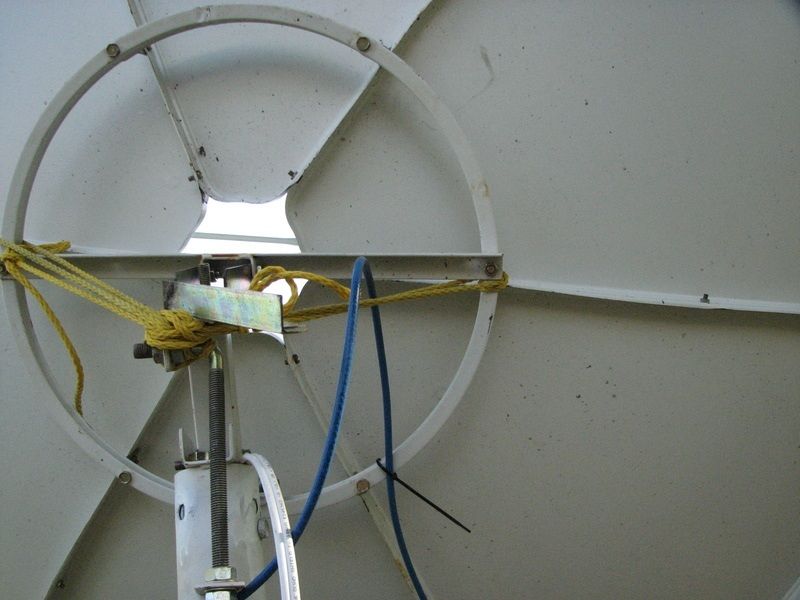

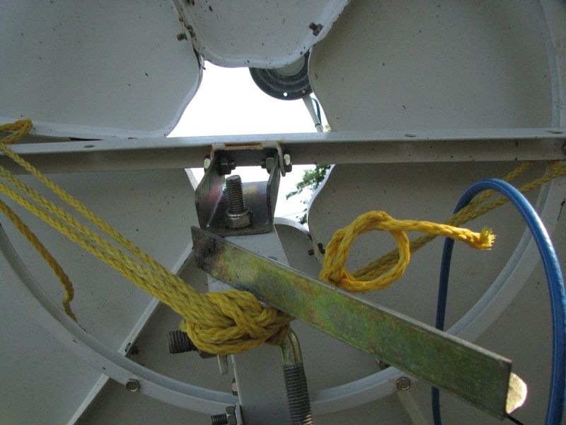

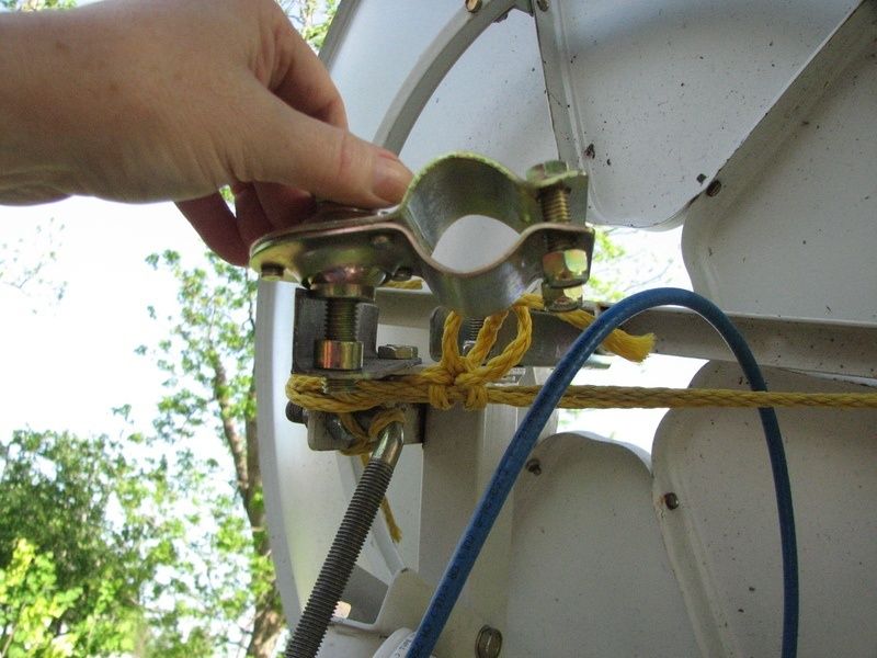

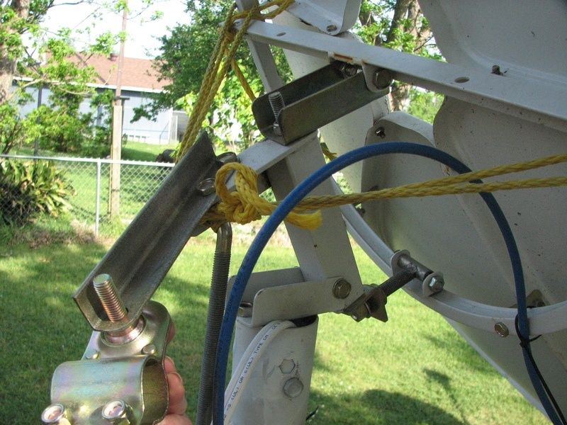

Ok, this is just impossible....... :(

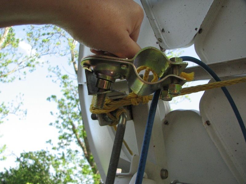

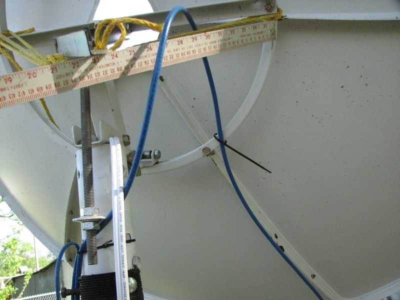

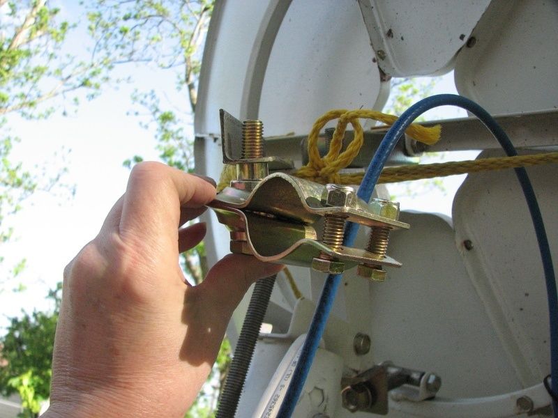

I am reasonably certain that I have put some of the parts on upside down now.
There is NO WAY for that motor arm to have a straight path.
You bolt the motor to pieces of angle iron. Because of the way the motor clamp is, you can not bolt it into the angle of the angle iron on the pole mount piece, it has to be bolted to the outside of the angle because the clamp is so large. Even attempting to use the spacer that came with it is not enough to clear the angle.
And the same thing with the end of the arm on the back of the dish. The knot on the end that the bolt goes through, will not fit inside the angle iron on the back of the dish..
BUT, the way the angle iron on the dish is, it's lined up dead center of the dish. If I take it all apart and flip it, it will no longer be centered and the dish will be offset from center of the main mount pivot part.
The spacers are of no use. I have no idea why they are there.
This whole thing is a joke.
I'm thinking that my best best is to just totally forget the motor completely on this dish, have my dad make up a part to bolt in place of the motor so that the dish is simply a fixed position like the little ku dishes. Then aim it at 87 and LEAVE IT ALONE.
I can worry about the BIG dish and it's motor then in a few weeks when my dad finishes making repairs to it. It needs some welding done on the ring mount thing.
This little dish is already rusted up pretty good, paint is peeling off and it's bent up just from me trying to assemble it. It won't be here by the time hurricane season is over. After we get a good storm through I'll take the remains down and toss it to the curb and write it off then get on craiglist and try to find a replacement someone doesn't want anymore.
I'm so freaking p:censored:ed off that someone stole that 8' dish I was going to have brought here. I could CHOKE those men that left it out to be stolen rather than delivered it like they were supposed to do or at least put it inside the fence where it would have stood a chance. :mad::rant:
I wasted my money on this one.. :o
Oh well..
So yeah, I think trying to put all this work into a dish that won't be here long anyway is fruitless. I'll just get my dad to make a bracket to bolt up where the motor would go and call it good.
I'll save this motor for the dish that will inevitably replace this one in the near future.

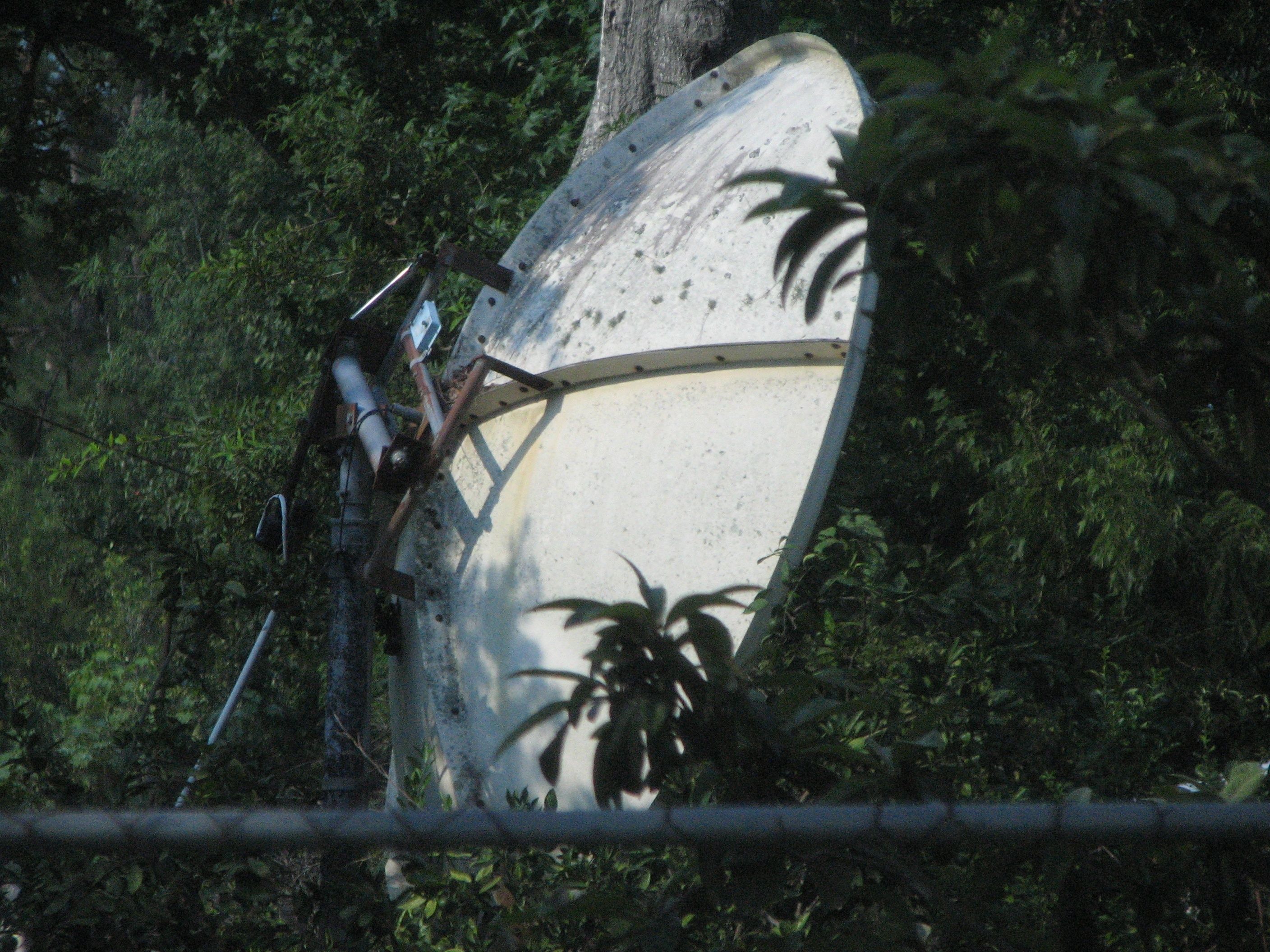

You MUST have some neighbors with a C-band dish. Go ask them if you can look it over, and take some pictures on how it's assembled. That's what I did on my second c-band dish, which was an 11 foot square fiberglas dish, that used to belong to a motel. It was given to me completely disassembled, and I had to figure out how to put it together. Luckily for me, a guy 10 miles away had EXACTLY the same dish. I went over, knocked on the door, and asked. I then took some pics, and was all set. I would have had major issues figuring it out on my own, but I'm all for shortcuts! It's much easier than you are making out, your brain is just fighting you. If you keep trying to "figure it out", but mull the wrong info over and over in your brain, you will LOSE the battle! CHEAT! You can only figure it out in your brain, once you have the proper info to "input".
This is somebodies video, but 1/2 to 3/4 way through, it actually gives you some good views of what you need to do. YouTube - 8' C Band Antenna Dish Refurbishment

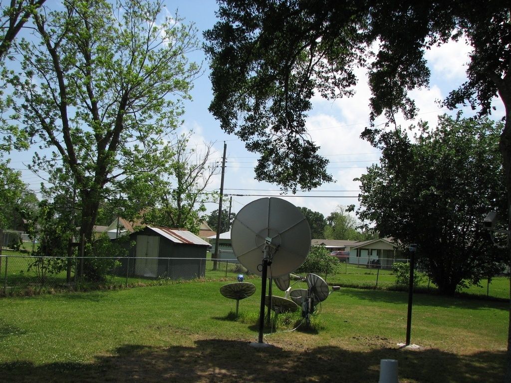

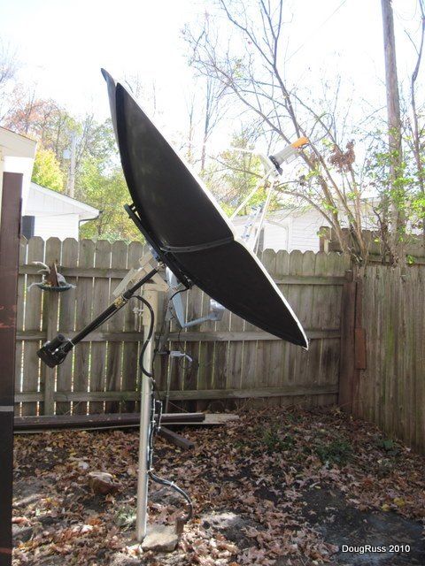

I backed off awhile and then took another re-think at this.
I have an idea that I'm going to try tomorrow, one more try at it to see if I can get that stupid motor on there.
I also realized that I need to tighten all the bolts up, they are all super loose and the whole mess is all flopping around. We are having some fierce winds and they are gonna destroy the thing loose like it is.
I found out that I can't put my iPhone up to the metal, I guess it has a real compass in it. I thought it was electronic but the metal totally messed the compass up. I think what I will do is clamp a looooong stick to the mount to move the iPhone several feet away from the metal then hold the phone to the stick.
It appears I have to point the mount towards true south. Do that first. Then start tightening up loose bolts. Then set the tilt. There's two tilts to set. I don't understand them but I'll figure it out somehow from the videos. I frickin HATE math.. And I double hate geometry! :mad:
Once I get the tilts set then I will see if I can get the motor mounted. That's going to be another thing that's gonna make me crazy.
And then there's the lnb. OMG.... There seems to be this focal depth thing to figure out. Then I have to figure out which way to rotate it..
Man! Why is this stuff so complicated?????

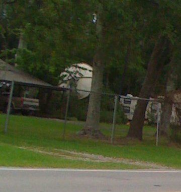

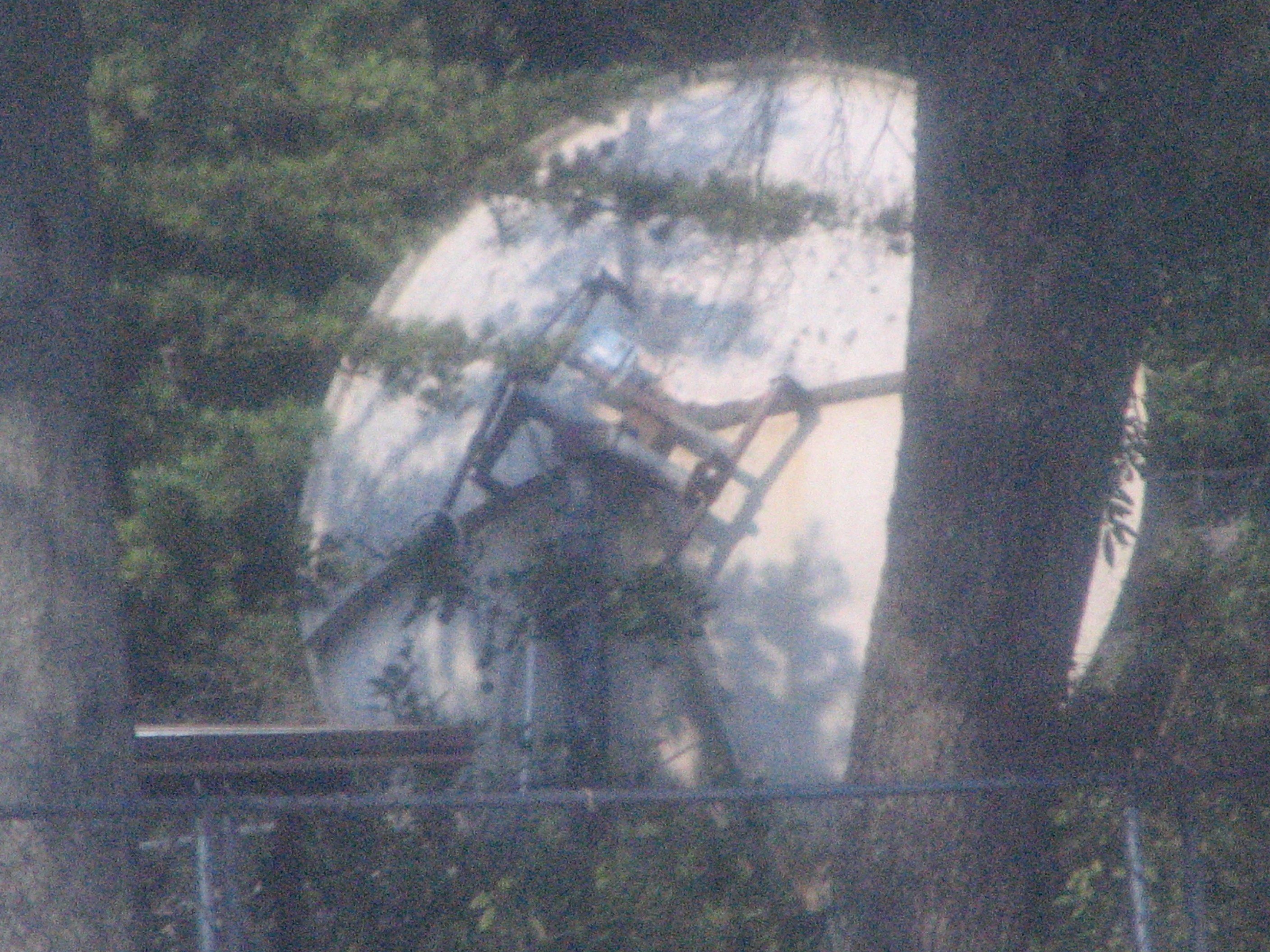

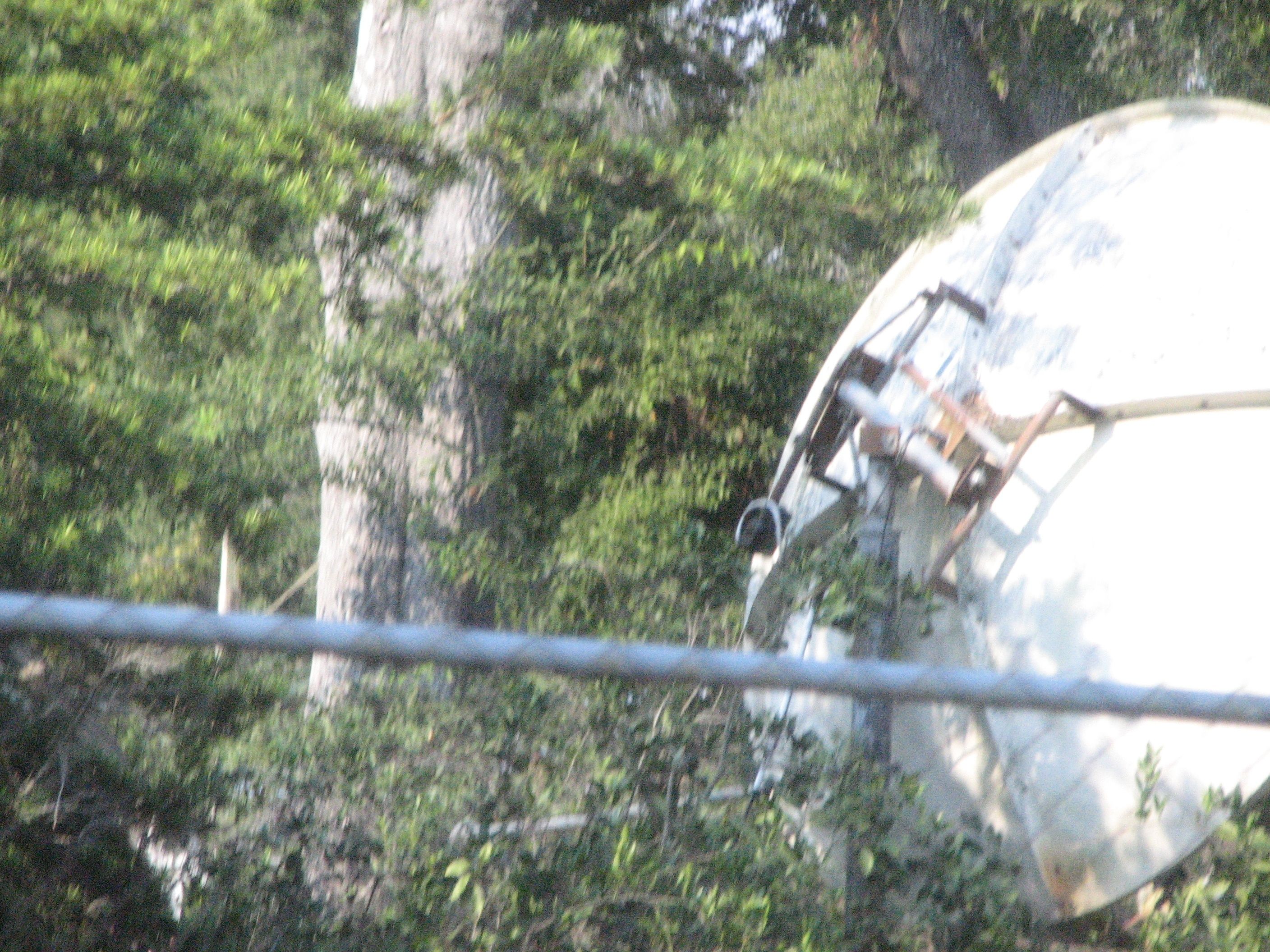

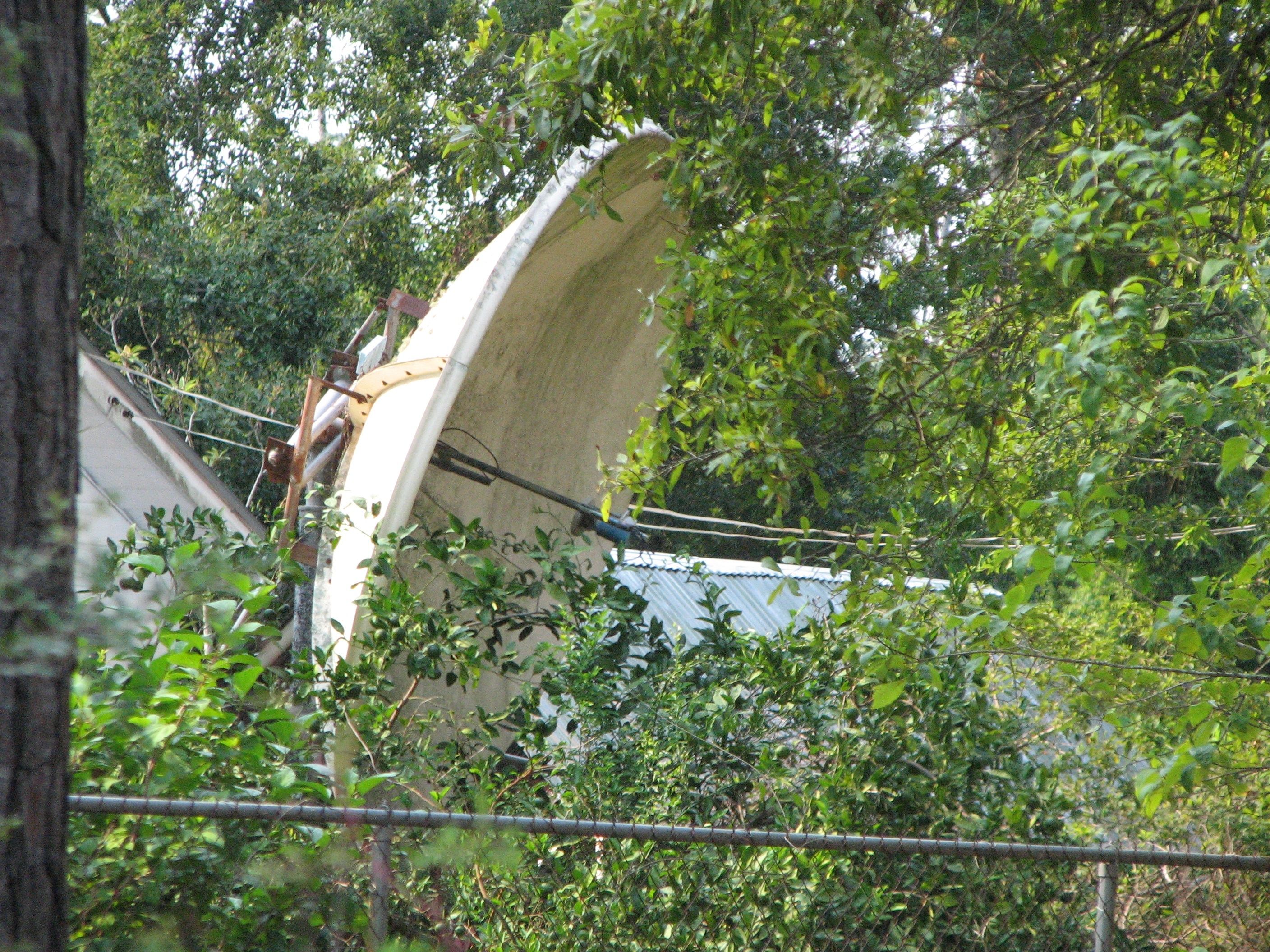

Oh, and no, I have not seen ANYONE with a big satellite dish around here. Not one. I do look as I drive around, since I lost that stash of dishes last year to stupidity, I have had it in mind that if I could spot one somewhere I would go ring their bell and see if they want to get rid of it. I have no idea how I would take it down or cart it away but I guess I would run it past my dad for suggestions. But no, I haven't seen a big satellite dish in anyone's yard for years.
Except last year, when my late friend and I saw an enormous 16 foot dish out in the country. I'll bet you could talk to Mars on that thing!
I could tell from the position it was pointed that it was not in use but jeez, that thing would take a crane and an 18 wheeler to move it then it would take a dump truck full of cement and a bulldozer to dig a hole for it. A pole would probably cost a thousand dollars for that thing!
Just getting that thing taken down, moved and re-planted here, would cost several thousand dollars.
As cool as it would be to have it, it's insane to even consider such a task..

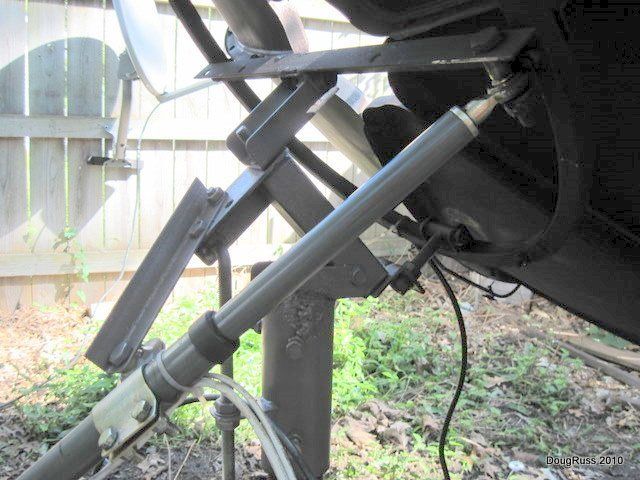

Dee get the dishpointer app for your iphone.I used it and it gives you picture of the arc u just can't get to close to metal. As far as the dish I have the same setup look at my posts. It takes two spacers and a longer 1 7/8 bolt. Also the pivot bolt that come with it is too loose it was the real long bolt with the nylon nut on top. It makes it real sloopy. First just get it lined up with true south. Get your motor on and it doesn't have to be perfect. Ill post a pic of mine later. Just do that lol. It took me wayyyy longer as I did the same as you. Try to do to many things at once and second guessing myself changing stuff.
I too had problems with the paint chipping and peeling on the Dish. I lightly sanded those spots and sprayed a few coats of Rustoleum Primer. Then I painted the whole dish. As for the back,where most of the paint problems were at, I sprayed ( 3 cans) of Rubberized Undercoating over the whole thing.

Dee, a few things come to mind.
First, you are looking for TRUE south, not MAGNETIC south. Go back to dishpointer or where ever you found the original direction to aim your KU band dishes, true south is true south for KU as well as C Band. OR, if you have a clear sky tonight, go out and find the NORTH Star, place something on the ground pointing AT the North Star using the pole as the base to aim from, then the next day, point the dish in the opposite direction, THAT will be TRUE SOUTH, no other way to think about that one, and no compass needed.
Second, skew on your dish is NOT going to be a problem once you have it lined up for your true south. Just as with the KU dishes, as the dish moves, so will the skew, it'll be automatic, so there's one less thing to worry about.
Third, which would be cheaper, replace your iPhone when you drop it when trying to measure angles on your dish, or paying about $10 for the mag mount meter you watched on the video you posted about yesterday? You may want to rethink that one.
Fourth, stop thinking so damn negative. We have ALL tried to get you to stop doing that to yourself. Once you have that dish up and working there is NO LAW that says the darn thing will come down in the first big wind. And on the one chance that it DOES come down in that or the tenth storm coming, look at the experiance you will have gained. You are already thinking about replacing this dish, I wish I were that rich, but at least you HAVE this dish, work with it, learn on this one, the BIG dish will be a heck of a lot easier once you get your feet wet learning on this one.
Fifth, it's not too late to cut some of that pole off and lower this thing closer to the ground. If as you say it is that difficult to think of this dish blowing away, it's going to have less wind resistance closer to the ground, and MUCH easier to work on at a lower elevation.
