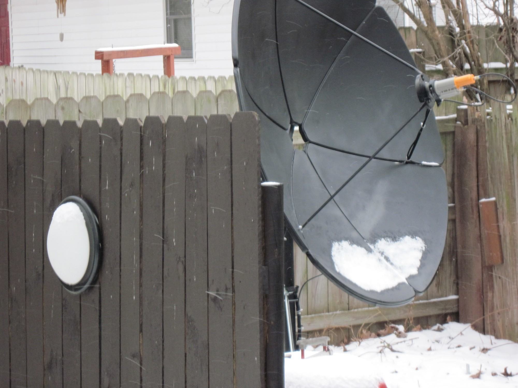

What did you paint the dish with? Did you compare signal S and Q before and after painting the dish? :)
I used Rustoleum's "Satin Black" on the Face of the Dish.
There was NO change in S and Q after painting it.

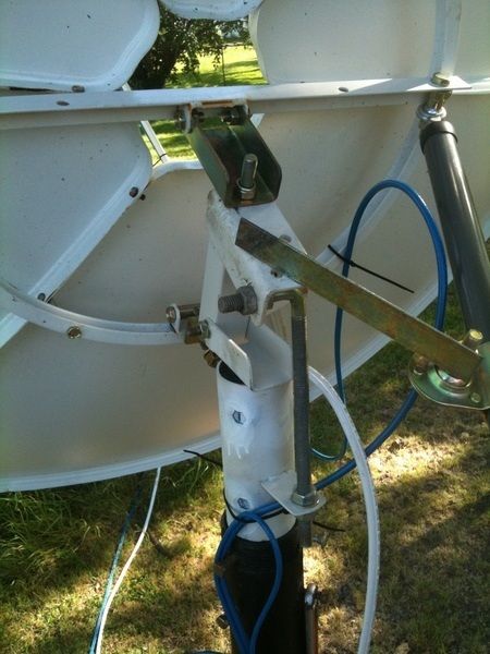

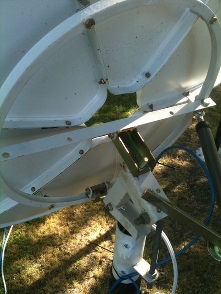

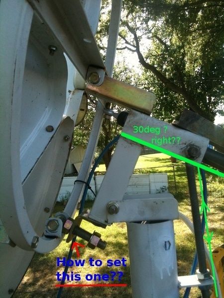

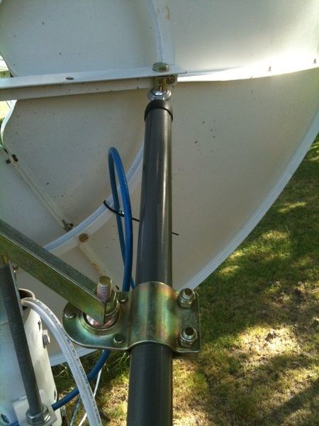

Progress... I think.........
Ok... So I went out there today and for starters, I figured out a way to mount the motor that looks like it's not in some weird angled up binding goofiness.
Then I did my best to set point the dish towards true south, by eye. Oh my... :rolleyes:
Then, I tightened up all the loose bolts. There were a LOT of them.
And of course I do not have the right tools so that made it more fun than I needed it to be.
My dad has been trying to "tool me up" so I will have some basic tools for simple home repairs and a few loaners to get these dishes put up. But of course I don't know what tools to ask for to borrow so I have all the wrong tools. Anyway....
So, I went to dishpointer.com and got my PRECISE location of the dish to the inch spotted on the map and told it I need the setting for a motorized dish. I saw an entry for a Superjack DG120 which I ~think~ is a C-band motor for a big dish. Right?
Here is the info it gave me for setting the dish.
Motor Latitude: 30.0°
Declination Angle: 5.0°
Dish Elevation: 35°
Azimuth (true): 180.0°
Azimuth (magn.): 177.6°
I then took my iPhone and brought up the angle meter app and set the phone on top of the mount and adjusted the BIG vertical bolt up and down until the meter read 30 degrees then tightened it up.
Right??
And now I am at a stopping point.
I put the phone against various places on the dish and I couldn't even come remotely close to finding anything that reads 5 degrees. That bolt on the bottom that tips the dish up and down, it won't let me tip the dish down to 5 degrees. At best I can get it tipped down to like 12 degrees.
So obviously I am doing something wrong there. I may have the meter in the wrong place or I may be adjusting the wrong bolt or maybe the dishpointer site is showing me the wrong info..
I think I may be able to eventually do this. I guess I need one of those magnetic meters you guys keep showing.

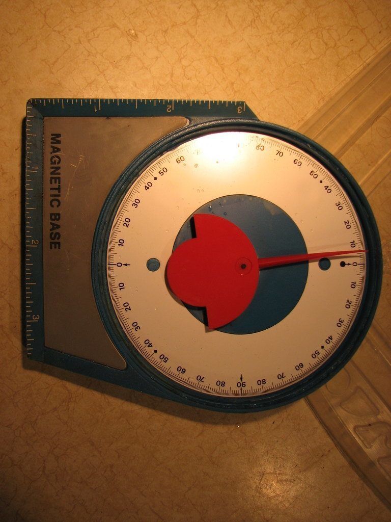

Yep a magnetic base angle-meter is almost a necessity, once I finally got one I saw how useful they are. The declination on a polar mount dish is set once, and usually you don't ever have to change it again. I can't tell from the bottom of that last picture you posted, but I think the bolt that attaches the bottom of the dish to the botton of the mount is where you can adjust the declination. Knowing where to place the meter to measure the angle, now, is another story lol. Maybe I can do a mock-up on one of mine tomorrow and post it for you, so you'll "get it". It's easier than try to explain it! You are going to be an experienced installer very soon, hehe.
You're doin' fine. Look what you've already accomplished. I have 100% confidence in ya.

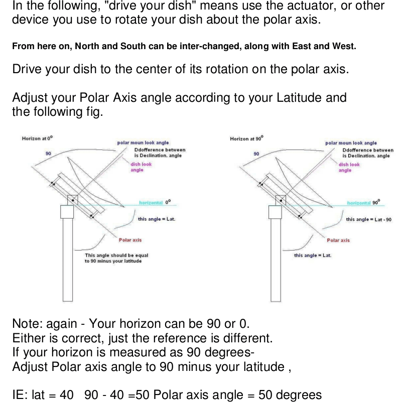

Now, here's what declination is: Footprints by Dish Size - Latitude Declination Chart - C/Ku-Band Satellite Listing
And here are pictures showing the two simple angles you need to set on your dish, when it's aimed at the top of the arc (true south):
I am sure I gave you these before, but maybe too early and certainly in a different thread.
Give 'em a read when you are relaxed.
Don't worry about all the mumbo-jumbo, just look at the pictures.
They convey the most info.

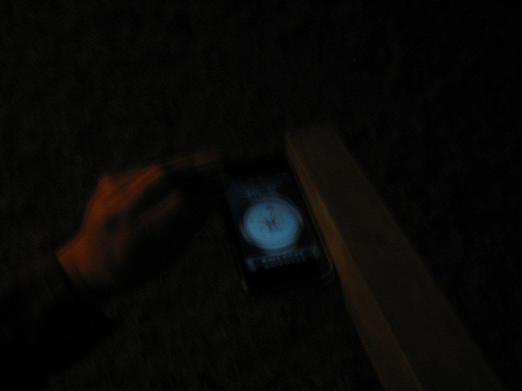

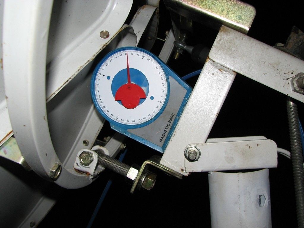

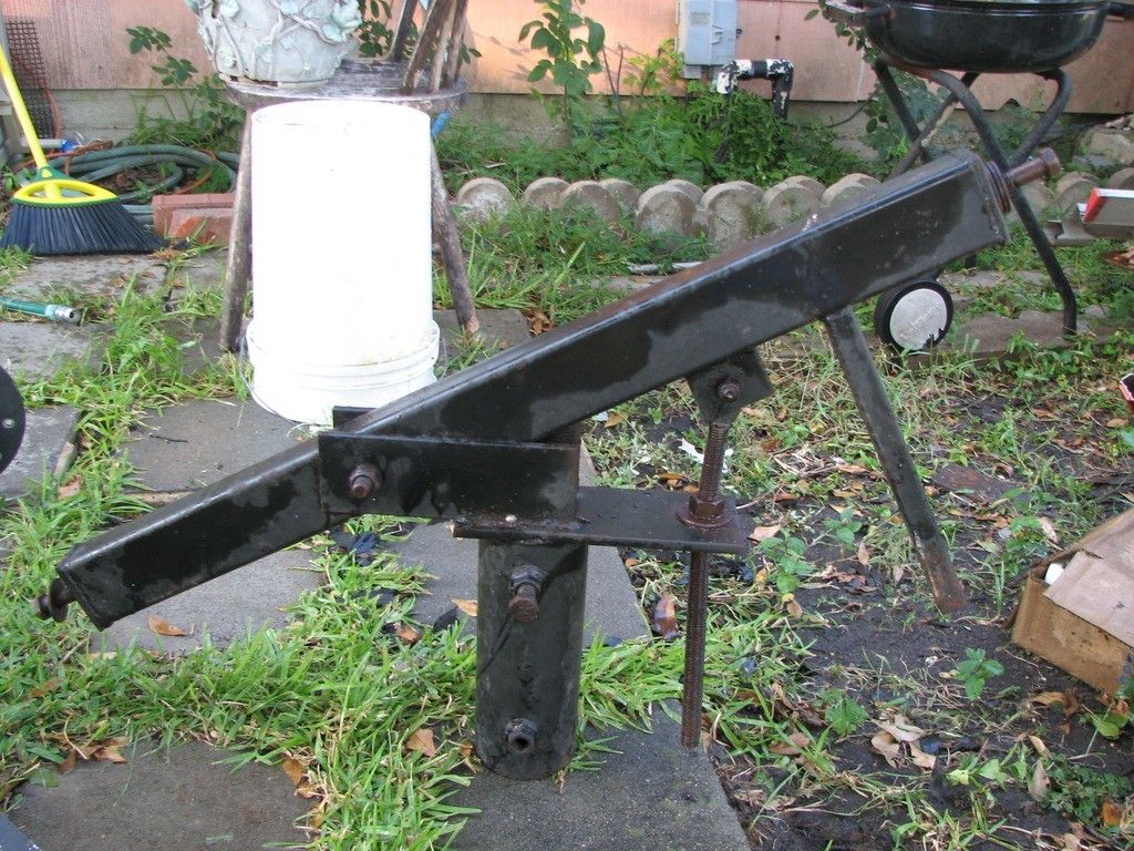

So. I got to thinking that I was putting the angle meter (my iPhone) on the wrong part of the dish mount.
So I checked it again and moved it to another spot right dead center in the hole in the middle of the dish, right above the hinge pivot where it tilts up and down.
Still showing 30 degrees either way I put it.
The thing that I can not grasp / comprehend though is this, "Declination Angle: 5.0°"
No place on the dish or any of it's parts or brackets or mounts can I get a reading of 5 degrees no matter how I tip things around. :(
Whoooooooooooosh! Right over my head!
Anyway..

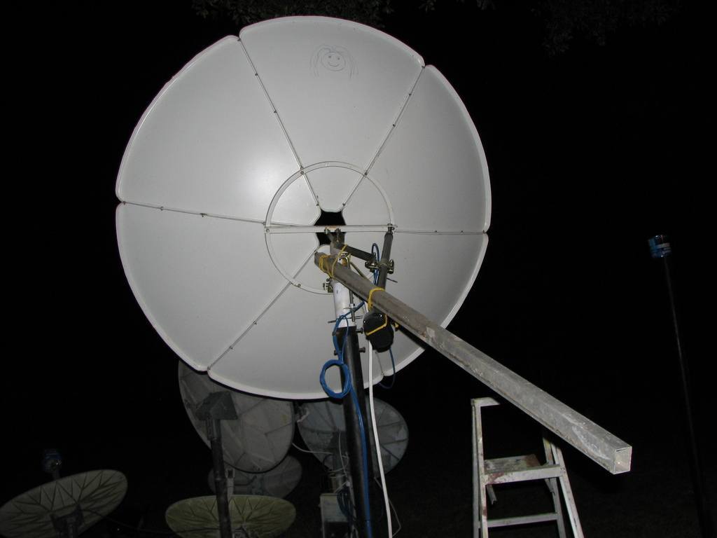

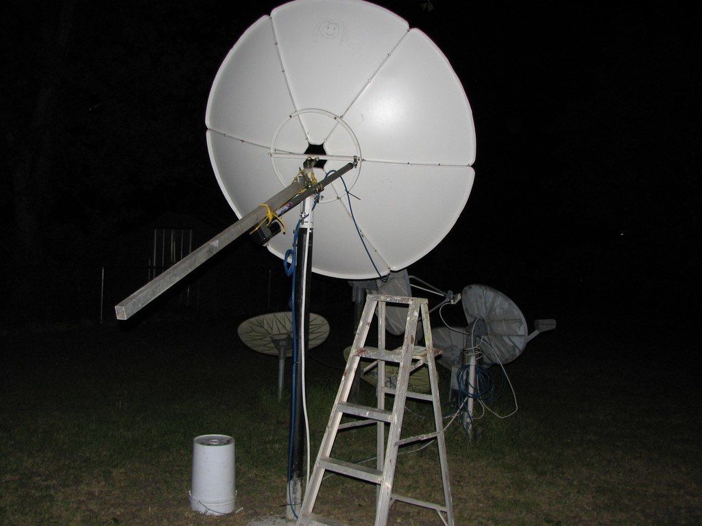

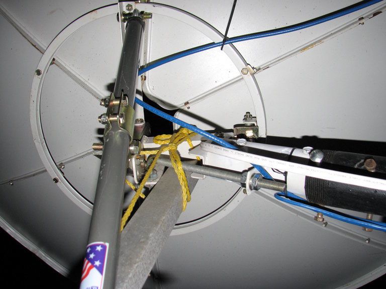

I found a very long piece of aluminum square tubing. I think it's left over from our old patio doors. It's pure aluminum.
I found out earlier that when I get too close to the dish with the iPhone in compass mode it goes bonkers and renders the compass useless.
Fine..
So I took this piece of aluminum waaaaay out in the yard, laid it on the ground and moved the iPhone back and forth right over it and it had zero effect on the compass. I was pretty sure that would be the case but I wasn't sure this thing is pure aluminum. It seems to be.
So, I then took the tube and tied it to the dish brackets so that it is perfectly square with the dish hardware. I tied it very tight to the mounts so it can not move.
Then I walk way out away from the dish to the end of the tube and put the iPhone up to it, holding the flat edge of the phone square against the tube. I see that I am not lined up on north/south like I ~thought~ I was.
Now what I'm wondering, do I aim the whole thing at a certain satellite now? Or do I am the whole thing north/south?
Which one do I go by? Should I point the compass/dish to 177.6 or to 180.0 ?
This true / magnetic stuff, I don't really follow. I have heard the north pole is moving because the core of the earth is moving or something like that.
Or do I aim at the whole bleeping thing at Galaxy 3C at 95W ? According to dishpointer.com, from where I am, it is at:
Azimuth (true): 182.1°- Azimuth (magn.): 179.7°
And if so, on the compass, do I move the dish until the compass reads 182 or 179?
This compass stuff is frustrating... I see four potential directions to aim it at.. I can not figure out which one is the right one.
Once I get it aimed at the right place on the compass I can remove that aluminum tube and try again to get that stupid other adjustment set, the declination.

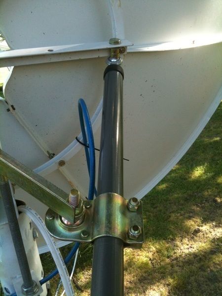

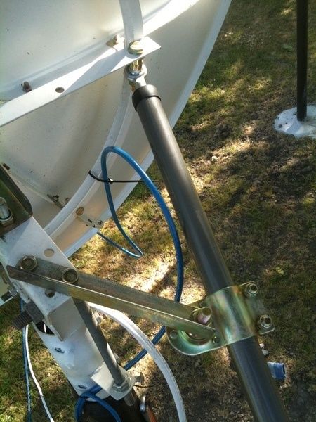

Also, something I realized, the motor arm is fully retracted.
And in the process of handling it, I accidentally spun the motor or the shaft or something, a few times in various directions so now it is NOT in the same state it was delivered to me in. Ooooopsy!
And shouldn't the motor arm be extended, like, half way out when the dish is pointed to true south? That way it can extend to the east or retract to pull the dish to the west. Right?
As it is now, there is no way physically possible for the dish to move west, it can move waaaaay east though. Something is not right there just yet.

Think of the 5 degree declination angle as an offset.
The dish should point 5 degrees above the mount, therefore the 35 degree dish elevation number that you were given by dishpointer.
In other words, you're adding 5 degrees to thirty.
So, you should measure 35 degrees at the back, or leading edge, of the dish, whichever is easier to reach for you.
A compass will show magnetic north and that's what you are expected use as a heading.
An old and reliable shortcut is to use the sun for pointing.
In your case, with those Ku dishes so handy, you could point one of them at whatever satellite you desire to find with the C-Band BUD.
At the right time of day(likely early afternoon), the sun will line up with the Ku dish and then you can loosen the actuator clamp and swing the BUD along the arc into the same position.
If you've tightened your mount down well and set your offset properly, the dish(BUD) should faithfully track the "Clark Arc".
At that point in the proceedings, you are ready to let the actuator back down towards the clamp to where the dish is lower than your lowest satellite, tighten the clamp and program the reciever.
From the pictures, it looks to be a 24 inch arm and that's plenty for a six foot dish. In fact, it would easily handle a 10 foot.
Footprints by Dish Size - Adjusting the Polar Mount for Prime Focus Antenna - C/Ku-Band Satellite Systems - Tuning, Tracking, Azimuth, Elevation, Declination Angles, F/D Ratio, Focal Distance, Inclinometer, LNB/Feedhorn Assembly, Actuator Assembly, C
Check the pictures - should help a bunch. ;)

Buy a magnetic base angle indicator. I paid less than $15 for mine at Home Depot.
Dee_Ann You don't measure 5.0° but you will adjust the dish mounting for a difference of 5.0° between the dish and the polar mount planes. Either polar elevation to dish elevation or Latitude to extreme. There's where the 5.0° come into play. I think the light bulb will light if you study this picture. (I know that the "Modified Declination Angle" changes the Latitude angle slightly, but only by fractions of a degree) Setting to Latitude will get close enough to get signal.

Dee you can get it I did and I was just as frusterated as you are now. Look at where on dishpointer it should be facing in your yard. It really doesn't have to be perfect. Make sure your dish is at its peak. Then if you move the whole mount very slighty east til u get signal if not move it the other direction. The reason I said get a small tv set and use the receiver is you can check it a lot easier. Read my post finally got my 6 footer setup. I have the same dish and in that post is pics where you measure to get the correct angles dee. I'm sure my post will help

So I called my dad and asked him if he had one of those gauges.
He did have an old one and a digital one and said I could borrow either one. I asked to borrow the old one because the digital stuff might give me a problem. And because all the pictures you guys have shown are of the non digital kind.
So, my dad brought the old gauge / meter / whatever over when he was out on errands today.
Two things I see that are a problem with this thing is that unlike my iPhone, you can't change the zero position on it. This thing was made to be used on horizontal surfaces it appears. So when you stick it on different angles the zero isn't straight up and you get the wrong reading on it..
In respect to that, there is only one magnet on one of the two edges on it so that makes it tough to stick it different ways to different things.
I guess it will work though not as easy as a more expensive one would. I guess I need to locate and purchase a more versatile model. But for now this is all I can get. It's also missing the clear cover and the little needle was bent a tiny bit. It's plastic though so I tried to straighten it out a little bit, it's pretty close to straight now.
So I went out back and tried to stick the thing to the dish. At first there was no way to attach it to any of the tilt brackets. So one of the bolts that tip it up, I adjusted to tip it up as far as it would go and I was then able to get the thing on one of the brackets in the center. But the zero was not up, at the 12'oclock position and that made the needle point to the wrong numbers. So do you like add or subtract 90 because the zero is not up? Right? That makes sense to me. Or, maybe not. I don't know. On this one you can only stick it along one edge with the magnet, the other edge doesn't have one.
On my iPhone I can press a button and it will reorient itself and put the zero straight up to 12'oclock no matter which edge you put it.

I took a picture of all the dishes and you can see that with the big dish set to the 30 degrees that dishpointer says to use, it's at about the same angle as the little ku dishes. WAIT! That can NOT be right! The satellites are at a higher angle than the dish appears to be pointing! It bounces in on an angle. And the big dish, does not. So it has to be aimed much higher in the sky than the ku's appear to be aimed. Right??

The other thing I can not understand, at all, is why there are TWO angle settings! WHY??????
Why not just have ONE setting on the angle? That's as stupid as stupid can be!
OH, I found a photo of the mounting stuff for the big ten foot dish when I but it out of the weeds last year. I took photos of the stuff before I sent it off with my dad who took it apart, cleaned it all up, took the rust off and painted it for me. Now that he took it apart all the bolts are moved now. It WAS set by the last person that owned it. I can tell from looking at the before photos that it aparently was aimed very much higher in the sky than I've been aiming this 6 foot dish. I can't say that for sure because I never saw that dish and don't even know where it came from originally.
Also, the 10 foot dish, doesn't seem to have two elevation angle settings on it! MAKES SENSE TO ME!
If it doesn't need two settings, why does the little one?? Grrrrrrrrrrrr!!!!!!!!!
Ok, here some photos of what I've got now..
Oh, and someone asked about the motor. No, the motor is not at all connected to anything yet. Eventually it will be. For the immediate future I do not care a flip about the motor, I want to park this thing on 87 AMC 3 and leave it there until mid summer. I do have a Gbox but I want to use it on the BIG ten foot dish. I'll get another Gbox this summer. Hopefully I can catch a sale on em.
Thanks.... :o
THIS!!!!!!!!!
THIS has been making me insane! Everything I have read so far has been totally NOT the right thing. I thought "elevation" was how much you tilt the dish. It's "polar axis".. And I've seen nothing at all anywhere until this about this setting. Dishpointer was telling me to set the elevation to 30. That can not be right. This polar axis though, is a much different number!
I am at latitude 30 (29.96).. If I aim the dish at 30 degrees as you see in the picture above, it does not make sense.
BUT, if I use the method in this graphic, it would put the dish at SIXTY which would put it higher in the sky and that makes more sense.
I THINK the dish is supposed to be tipped to 60 degrees, not 30. 60 makes sense, 30 does not.
Right??
