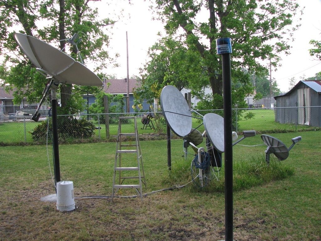

Finally!

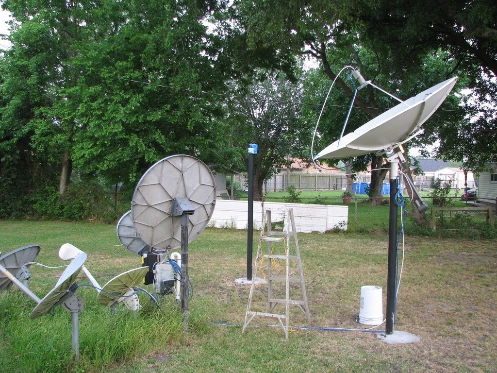

you're right. it's still 30° off. Now its pointed the same as a KU dish next to it. The prime focus dish has to look directly at sats and would appear 30° higher than the KU dish next to it. There is no place on the dish to measure the elevation angle directly. You measure at the AXIS of the dish because it's perpendicular to the elevation line. You are still setting elevation when measuring the AXIS angle. It's just the opposite angle and you do the 90°-lat=elevation thing.
Leave that Angle finder where you have it that pic...then using that long threaded adjuster bolt, crank in downward until that gauge reads 30.

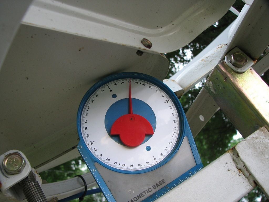

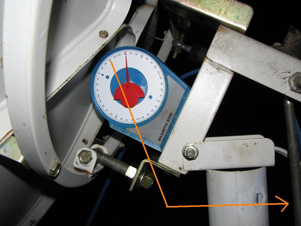

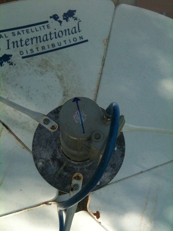

That looks better..............now to set your Declination...........
put that Angle Finder on the Ring opposite side than in the Pic below ( since the magnet is only on one side of that finder), then using the smaller adjuster,crank it in until it reads 35 on the scale.
That should put you close.
put that Angle Finder on the Ring (Pic below) then using the smaller adjuster,crank it in until it reads 35 on the scale.
Ok.. So I set the dish to 30 via the big bolt.
Then I stuck the angle meter on the dish ring and adjusted the little bolt on the front bottom to read 35.
Right?
Sorry, didn't take pictures of when I did that.. :o

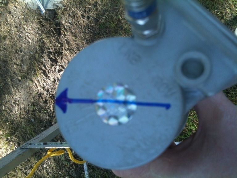

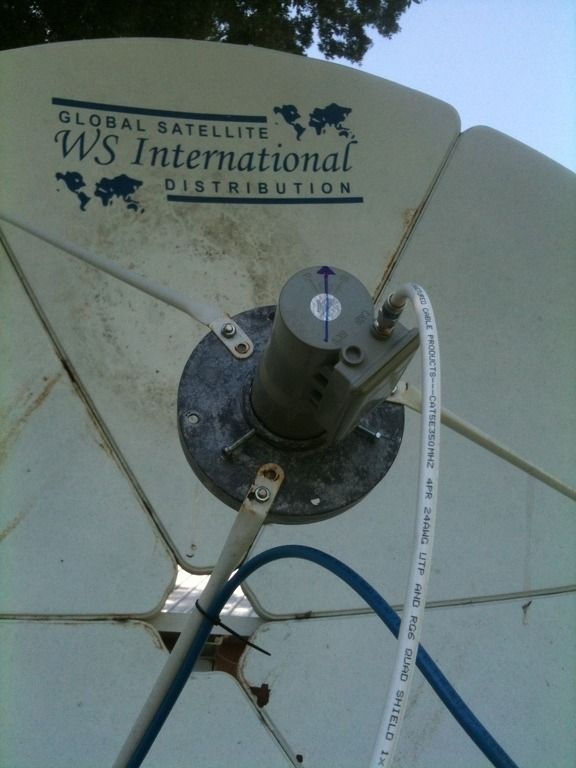

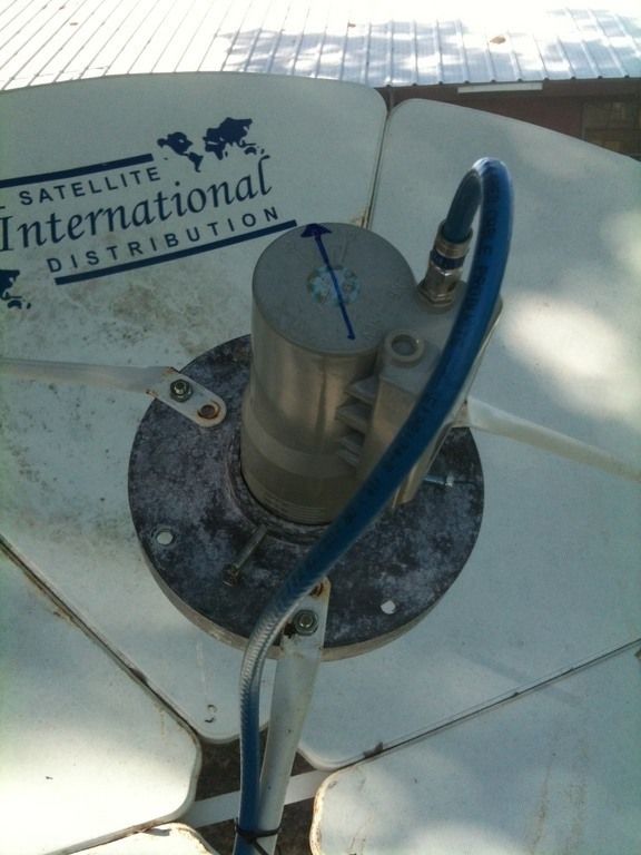

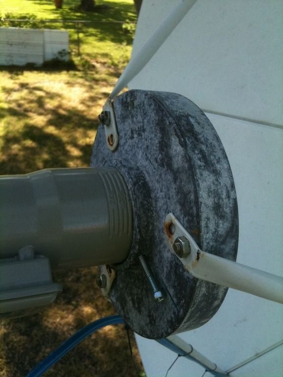

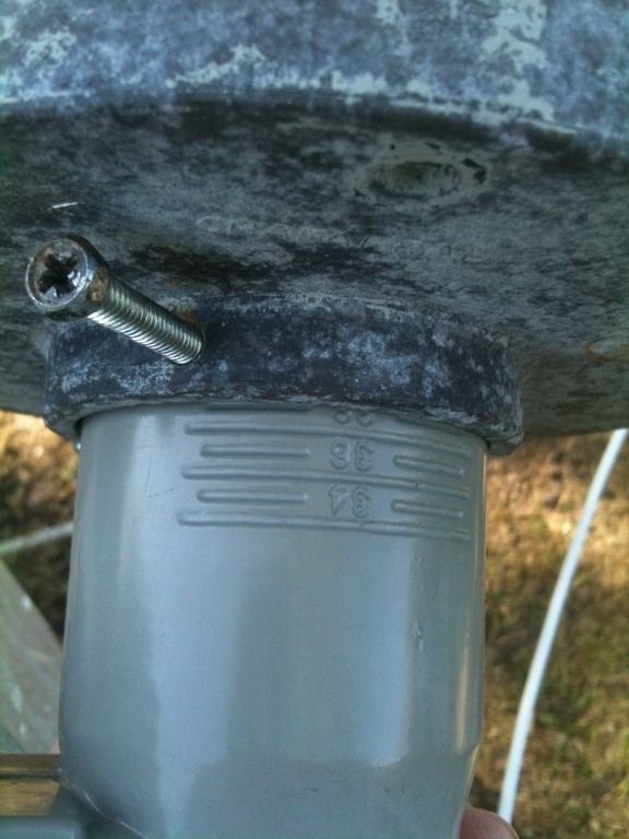

The lnb.... Arrrrrgh! I saw some insane math formulas for figuring out how to set it. NOPE.... Can not process. Sorry..
On the WS website I found some details about the dish. It said that the focal something is .38
.38? Whatever.. So I look at the lnb and it's marked with numbers.
I see the number 38 on it. I ASSUME that would be related to the .38 number on the dish details. So I turned the lnb so that the zero on the back of it points straight up while the dish was tilted to point at the horizon where I could easily get to it. I then slid it to line up the 38 on the side of the lnb with the edge of the ring.
I am ASSUMING here that that's what I should do.
So now the dish it tilted to the 30 and 35 degrees as mentioned in previous posts. The lnb is pointed up so the zero on the back of it is in the 12'oclock position. The marks on the side of it are at the 38 mark, assuming that relates to the .38 focal thing per the specifications.
Then I hooked my birddog and squealy meter to it.
Loosened the bolts to turn it east/west and turned it until the squealy went off. I worked it back and forth until the squealy meter showed the strongest reading then sat there on the birddog and went through the entire list of C-band satellites. It would not lock on to any satellite. :(
It's for sure aimed at one. But I have no idea which one.

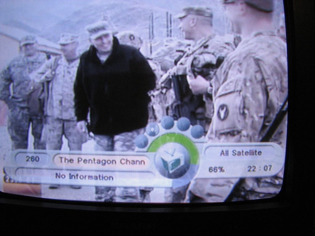

BINGO!

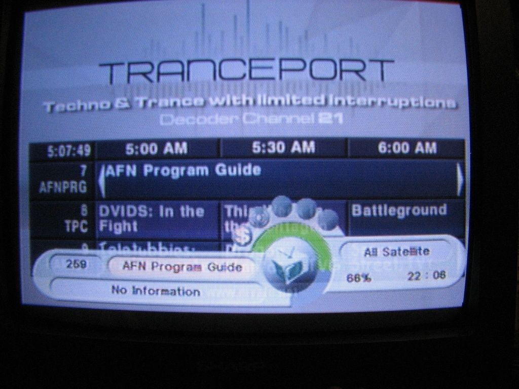

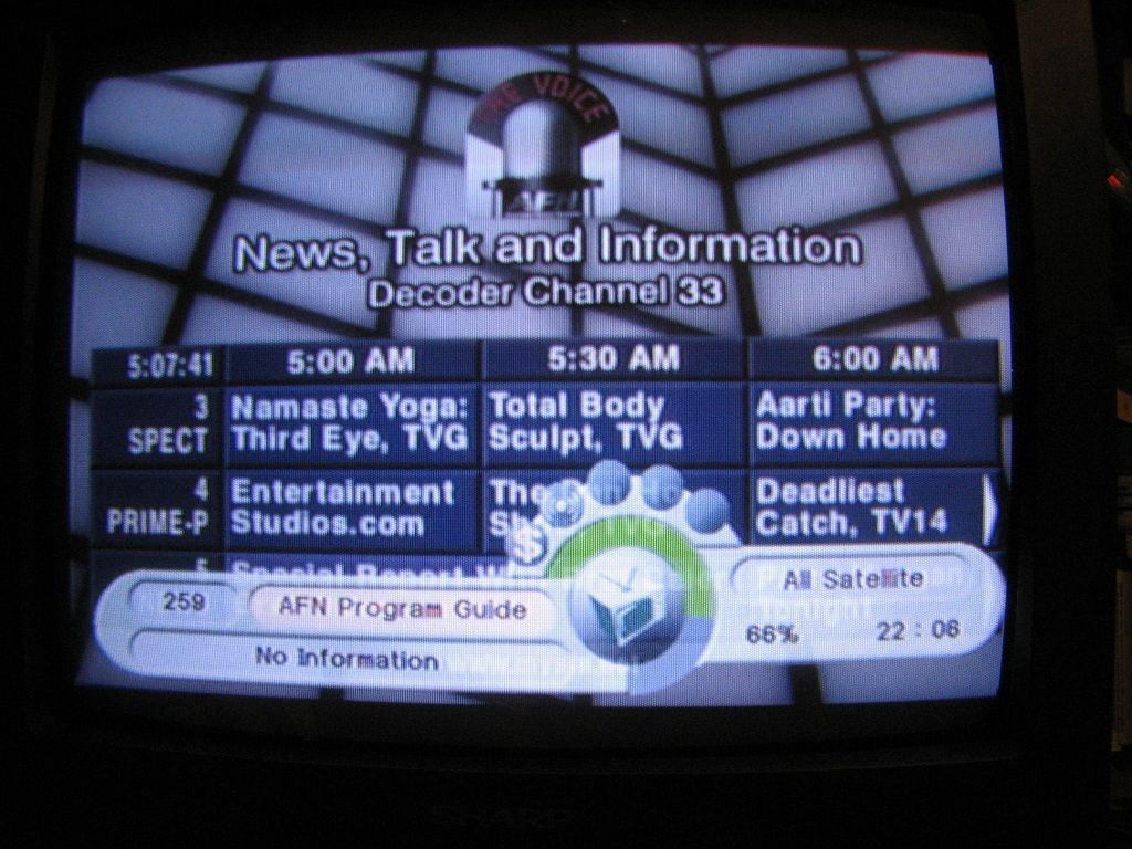

It seems that my dumb luck landed me on the satellite with the Pentagon channel. Yeah, I need that... :rolleyes:
I hooked my coolsat 6000 in line, in between my dishes and my pc. So the signal passes through the coolsat before it gets to the pc. When to coolsat is on it kills the signal to the pc. When the coolsat is off, the signal passes through to the pc. I don't see any problem with that for now as I wouldn't be using both at once. The coolsat is really just for testing and figuring things out because the pc will not blindscan.
So, I turned on the coolsat and went to the menu and configured for a C-band satellite. It was fairly easy to figure out what options to select.
Then I selected this new satellite and hit the blind scan button.
It found a bunch of channels named AFN ~something~ and a tvguide channel and the Pentagon channel.. Ugh..
BUT, the thing is, I am actually on a satellite. I dug through The List and discovered that I am on the satellite at 89. I want to be on the satellite at 87! OMG I am sooooooooooo close!
What do I do now?

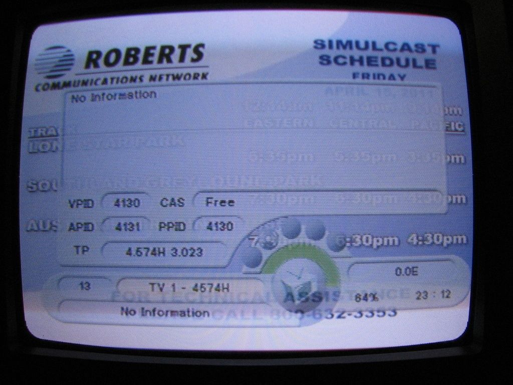

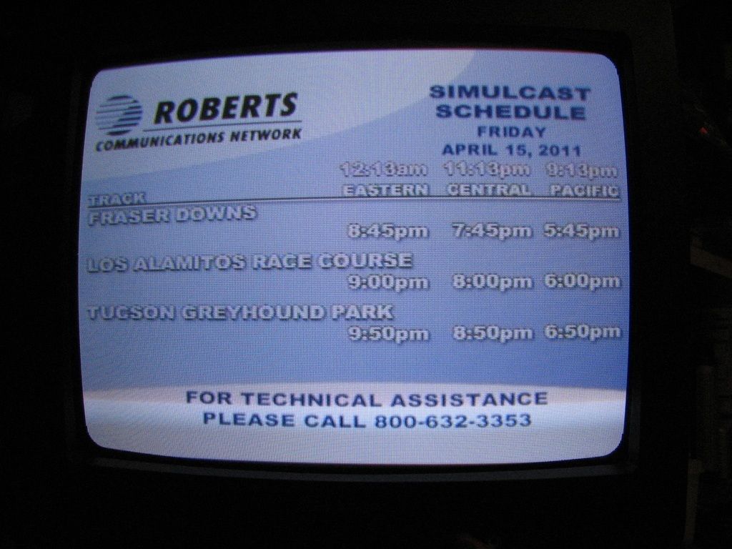

Moved the dish and found something new. Nor sure what, birddog will NOT tell me what it is.
Blind scanned with the Coolsat and it found ONE channel.
Is this the Galaxy 3C satellite at 95?
I'm thinking this is 95. I see in the list a whole bunch of horse racing channels on 95 and the screen I found on this satellite very much appears to be horse racing related.
If so, this is the satellite I was thinking was as close to true south from where I am as can be found.
I think that HERE, IF I am on 95, I should lock the dish down here then start trying to monkey with the motor. Right?
Dee, that looks like the Roberts horse racing channels on 95C, if its around 3907mhz I believe you are right. (most of them are scrambled now, but they open up every now and then). Since you're west of me a ways, I would think you will need a bit more 'throw' to the east than I do, to see the eastern satellites. The actuator has a clamp holding the tube , what you need to do is figure out how far you want it to go, the eastern-most satellite that has anything of interest on it. Drive the dish as far east as it will go, then if it won't go far enough to hit your last eastern-bird, loosen that clamp a bit and force the actuator tube further out. Check your western satellites, find the last one you want to watch in that direction, see if you can drive the dish to it. If it won't go far enough due to the tube being too far out-loosen clamp and shove it back in toward the motor-end a bit more. Just an inch will get you several more degrees of travel.. That's an over-simplification of it, but should give you an idea of adjustment. That v-box thing will probably have limits you can set also, so you can't go too far west or east.. Be careful when loosening the motor-tube clamp-the entire dish's weight will be on that, and it can cause the dish to suddenly flop one way or the other, so you might want to use a helper.

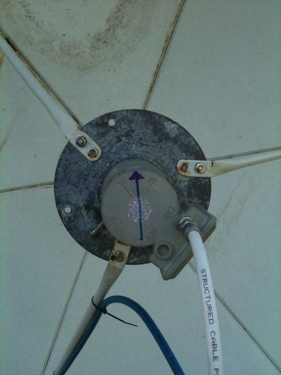

So, I tried bumping the dish east and west, with no success there on 87. All I can get are those Nasa channels and they don't really come in, they just show up on the scan.
So, I am thinking it's the lnb. Perhaps the skew is off on it. I don't know. But I'm thinking that maybe that should be what I fiddle with next, rotating the skew on the lnb. Or the focal setting. One of the two.
