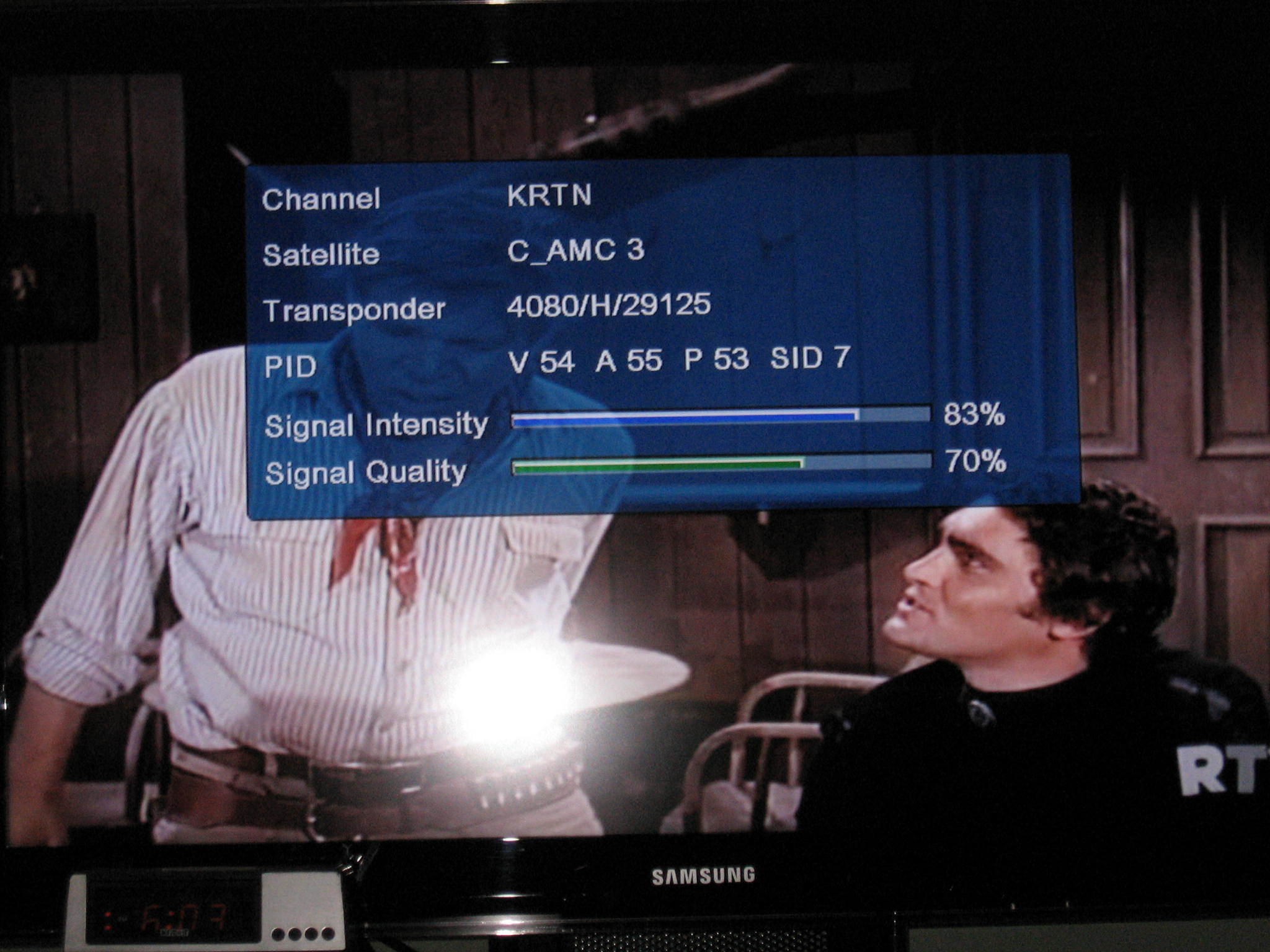

I have no problem getting most if not all that can be seen with my 6ft dish on AMC3! Heres what i get for RTV.

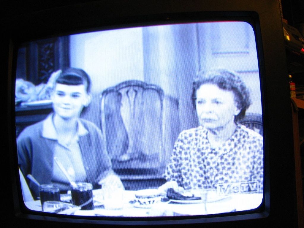

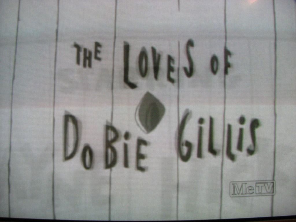

I am watching "The Many Loves of Dobie Gillis"
On, MeTV......

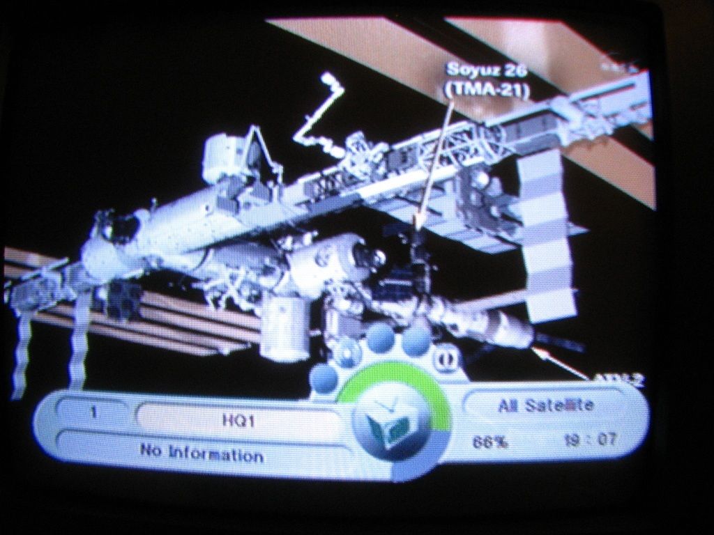

I do not know how I managed this but it's coming in really good!
BTW, the info I found online for MeTV was out of date, it said the channel is horizontal but the coolsat found it on blindscan on vertical.
I had to manually enter the transponder and channel info into the pc app and then when I scanned, BINGO!
So the coolsat and my pc get MeTV and Nasa!
Woohoo!!
Now I need to figure out where the heck ThisTV went...
Oh, and on the coolsat there is no sound for MeTV. :(
I pressed info on the PC though and it says the sound is Doldy Digital 2.0

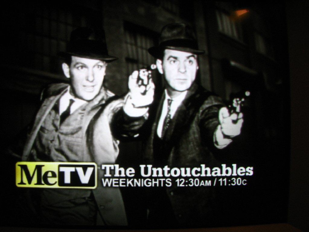

And OMG! I just saw a commercial for The Twilight Zone on MeTV, weeknights at 10c !! I LOVE that show! And the Beverly Hillbillies, Perry Mason, Petticoat Junction, Mary Tyler Moore, Bob Newhart, etc. etc. !!!!!! :D
THIS is going to be my number one staple channel. This was a huge pain in the rear to get this thing working but I am sooooooooo thrilled to have it finally!

Woo hoo! I'm so happy to have MeTV! WOW!! :D

How many channels on the RTV are you getting, and are you getting them on both transponders? 3800/H/29125 and 4080/H/29125
As for wanting the Openbox s9, HA, you are in for a very wonderful surprise when you see what that will bring in for you and how fast that will scan a satellite.
Another channel you'll want to be looking for in one of the two muxs for RTV, I can't remember which one it is now, but it is on the 3800 Transponder. It list's something that does NOT refer to My Family TV, but you'll find that one in there too. I edited the channel on my openbox to read as "My Family." Plus all the NASA Channels, you have a gold mine on this one satellite.
