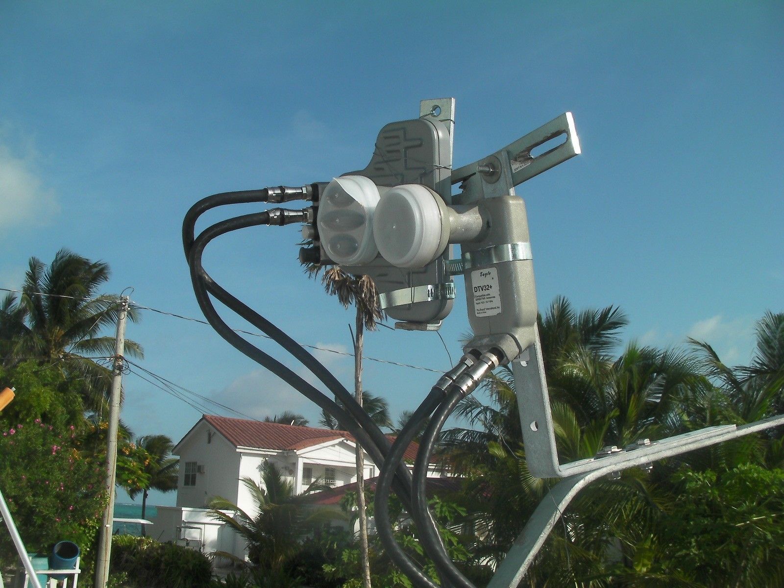

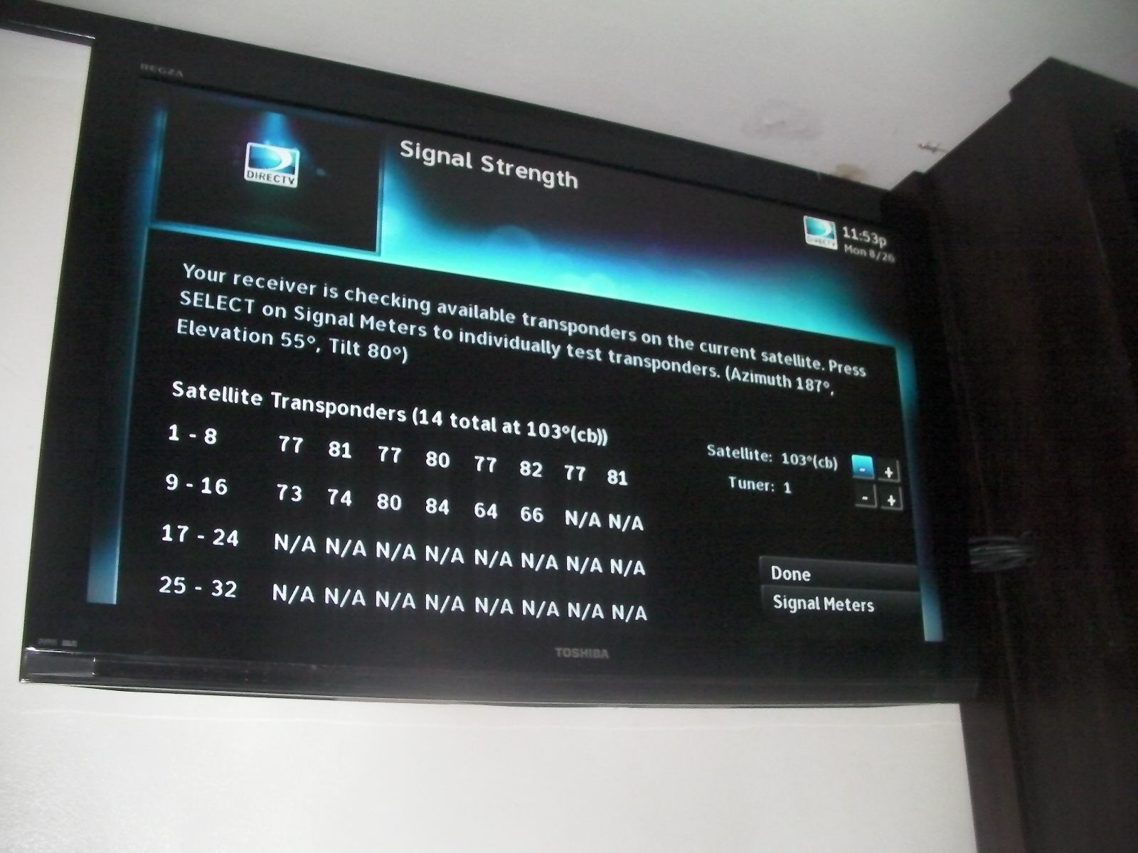

Good news and bad news (2 lnb set up: 101W and 103W in Belize with 8 foot Prodelin !

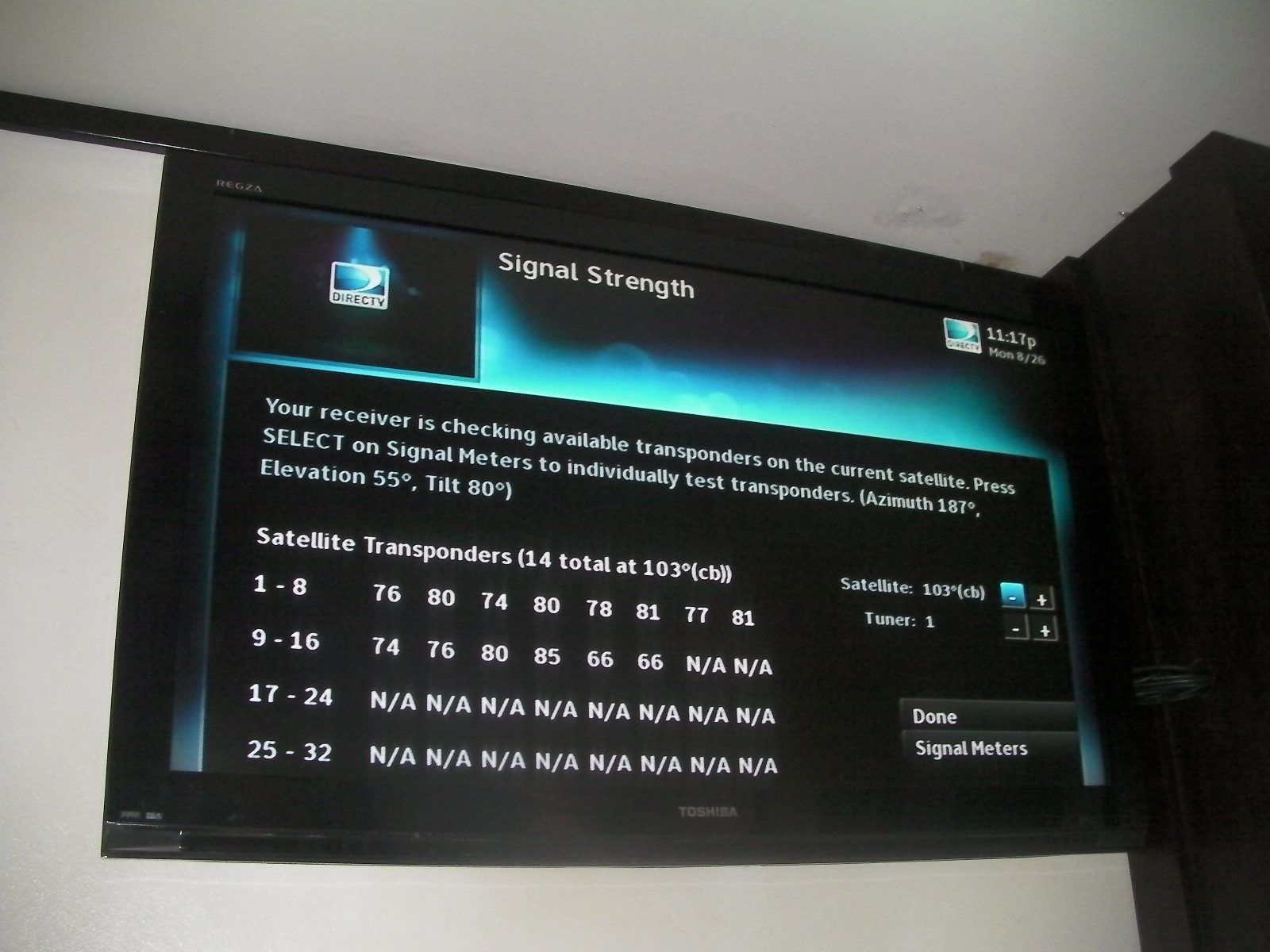

* Good news: it was easy to find the 103W just by holding the lnb in the right positions.
I used the 103(cb) which comes in very strong with a quick self-made LNB holder. Easy to find just by holding it in place by hand.
Signals are at 74 and above.
In general there is excellent hope to continue.

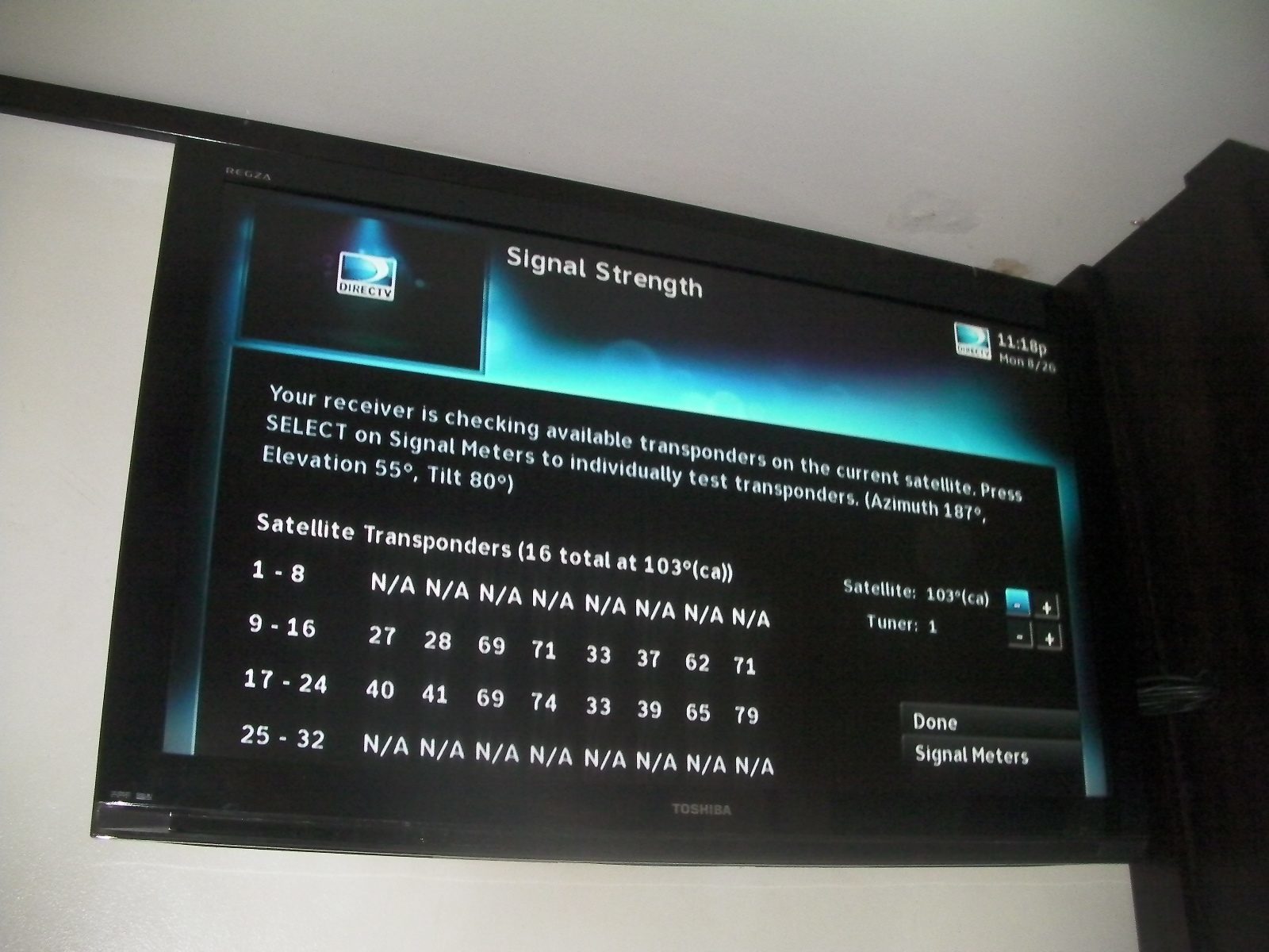

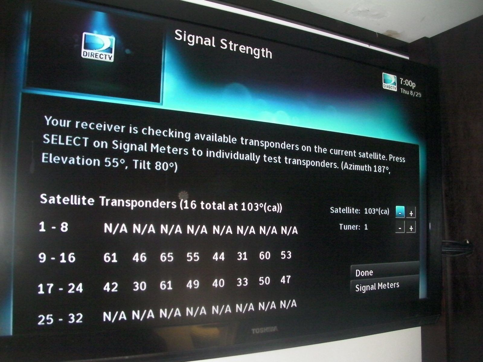

* Bad news: the 103(ca) has extremely low reception numbers. i had no time to play around for a long time.

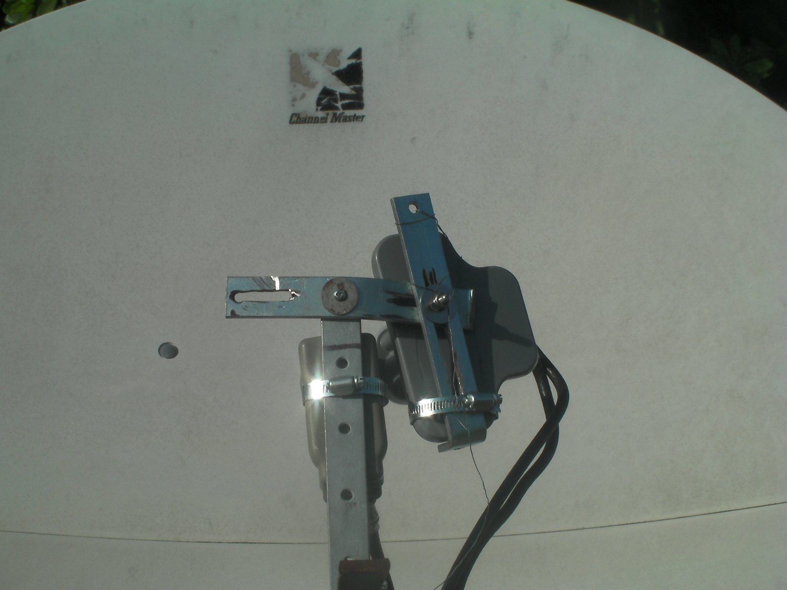

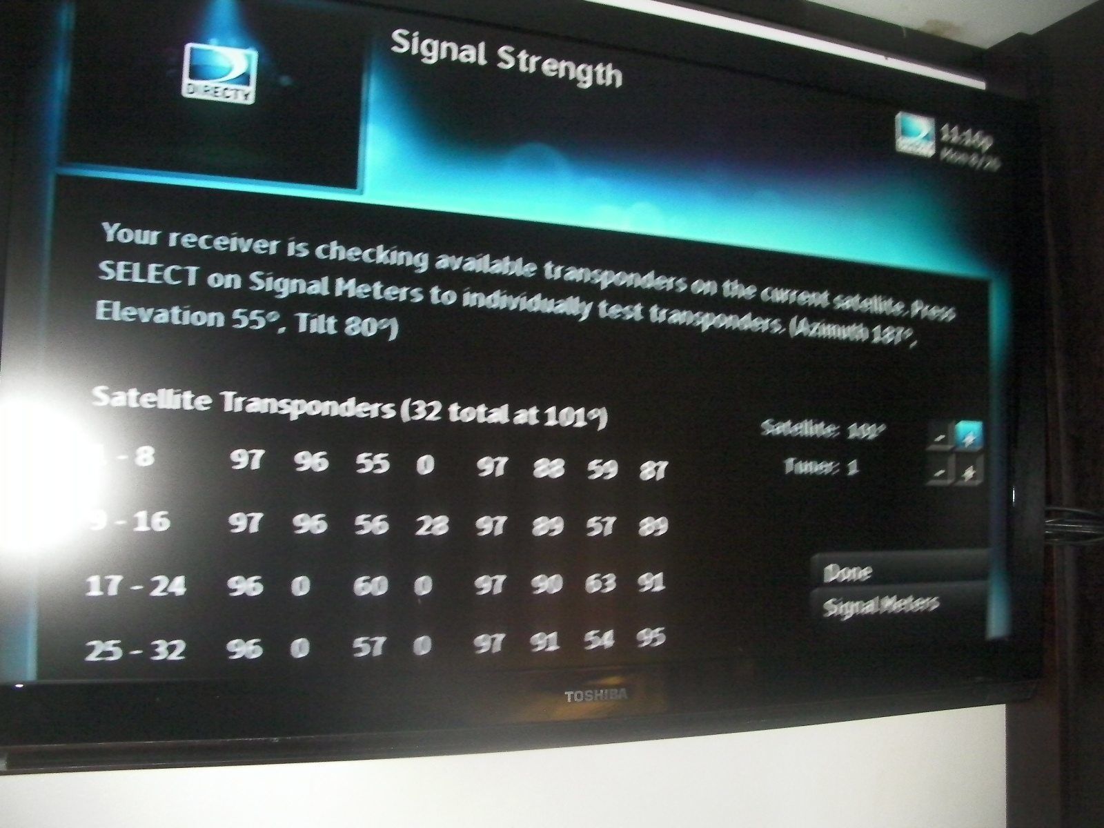

The 103 lnb seems to be in best position when it touches the 101 lnb, causing the 1o1 lnb to slightly go out of position. Therefore 101W has suffered some loss.
I have now some HD channels . . . great.
But I have lost several 101W SD channels due to a slight loss in reception, which causes the failure of some or all odd tps on 101W.
My lnb holder is not ideal but I could not wait to continue.

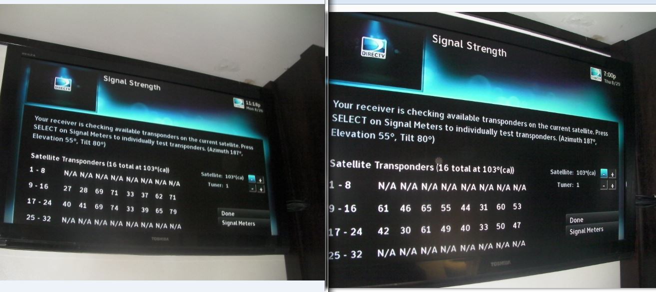

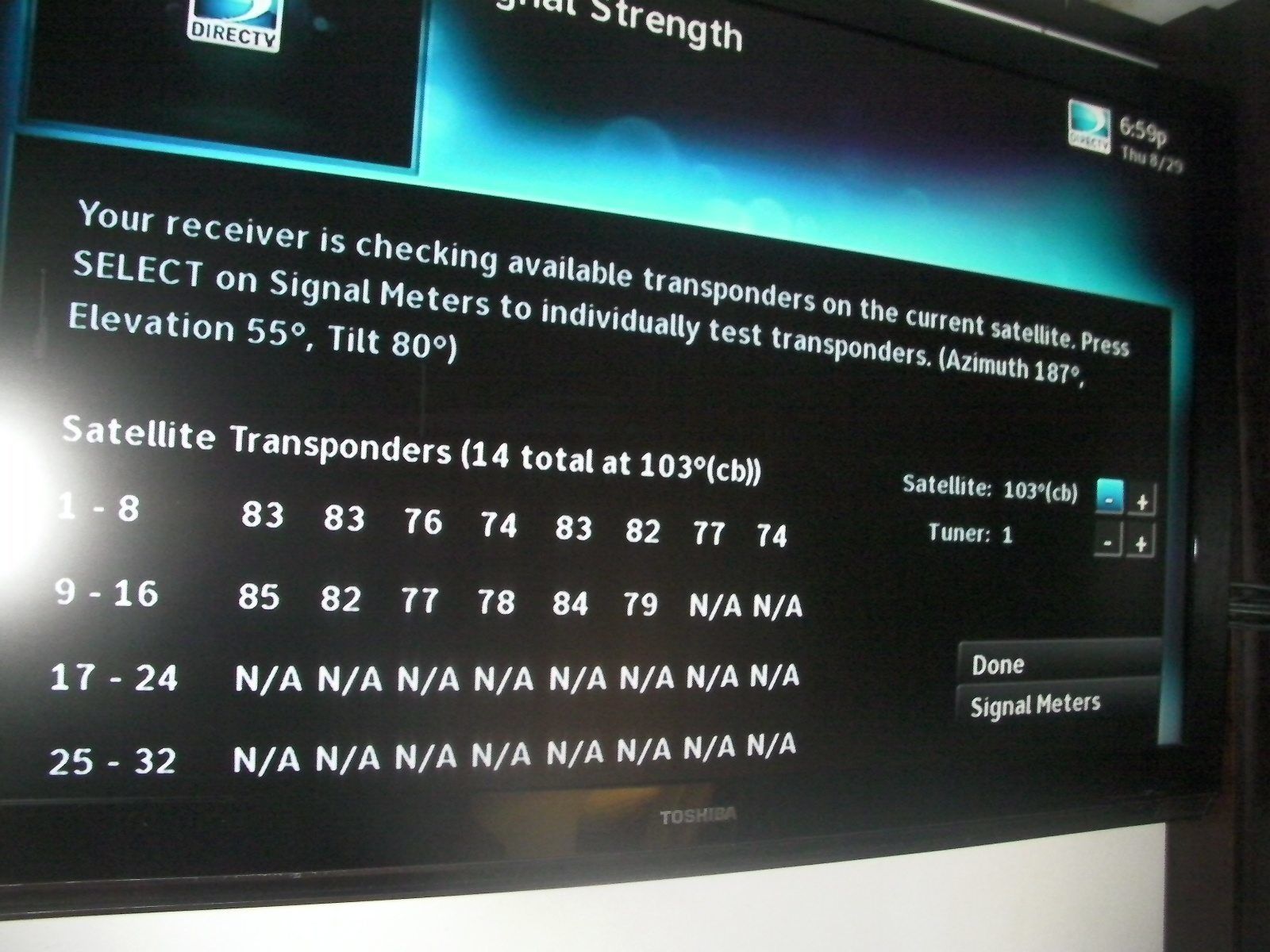

Raf, I got a few hours in to test 103W on a single 1.8m dish.
This is what I got:
103W(cb) co-hosted 2.4m off-center (left, #1) ---- 103W(cb) 1.8m, lnb in focal center (right, #2)
103W(ca) co-hosted on 2.4m (left #3) ---- 103W(ca) on 1.8m in focal center (right #4)
103Wcb is quite similar.
On 103Wca readings have slightly improved on average but e.g. strangely some tps have gone down very strong e.g. tp 16 and 24.
I will see tomorrow if I can improve the 101W by a few points w.o the 103 Lnb touching. This touching seem to have influenced the 101 reception that the the guide would only download a few hours in the morning but did not work the rest of the day.

Any pictures of the single lnb on the 1.8?
Remember that you have similar variables like in 101w you have two satellites @ 103w
Orbital Slot 103 w:
Ka-Lo: Satellite: DirecTV 10 (102.83 w) Tps: 1,2,3,4,5,6,7,8,9,10,11,12,13,14 (CONUS Beam)
Ka-Hi: Satellite: DirecTV 12 (102.76 w) Tps: 9,10,11,12,13,14,15,16,17,18,19,20,21,22,23,24 (CONUS Beam)
aiming and sharing the dish's surface will be paramount......
The 103Wcb was easy to find and to tune.
Following I concentrated all efforts to fine tune the 103Wca.
Here it is again both pics in one:
left 103W shared on a 2.4 meter (off-center with the 101W in the focal point) and on the right side using a single dish 1.8m and a SL3 lnb in the focal point.
I took one of the strong 103Wca tp and tuned it up, following I tuned one of the weak (ca) transponders to get readings up.
I did not pay any attention to the (cb) any more; they stayed up high anyhow.
Does anybody know which 101W transponder provides the "guide" ?
The guide only seems to work/update between about 9am to 5pm (the time when 101W readings are stronger).
