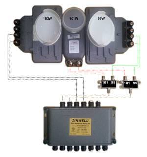

Includes:
  • LNB for Sat 99: DirecTV SL3 Modified for receiving only 99. Fine tuned for receiving only 99 and power efficient.
  • LNB for Sat 101: Best performing LNB on the Market
  • LNB for Sat 103: DirecTV SL3 - Unmodified
  • 2 Combiners for (99) & (101) Signals
  • 6X8 DirecTV Wideband Multiswitch for connecting up to 8 tuners.
  • Patch Cables NOT INCLUDED
It says the LNB for 103 is unmodified. As both cables go straight into the switch I could try a 101/103 set up first.

As I understand it from my FTA sat friend, the problem with using an unmodified LNB is that the standard LNB set up for 99 will also generate a 101 IF (intermediate frequency) signal even if the signal strength is zero (it might actually not be zero), so in fact the "99" LNB will be delivering both 101 and 103 signals into the combiners as well as 99. The 101 signal from the "99" LNB might not be exactly in phase with the 101 signal from the real 101 LNB and they will tend to cancel each other out. Certainly the S/N ratio of the 101 signals will be screwed up because there will be twice the noise. My guess is that the modification to the LNB for 99 removes the 101 IF signals (and probably the 103 IF signals also) so that the only signals coming out of the "99" LNB are in fact from 99. Then you can combine the 99 and 101 signals before they go to the multiswitch.
I'm sorry you don't see this so easy solution, I guess you have to understand that the Ka-low is down converted to 250 MHz to 750 MHz this is CATV or VHF/UHF so the Diplexer only catches the CATV spectrum 5 MHz to 800 MHz
it filters the uper frequencies just like a band pass filter, the other port will only receive 900 MHz to 2150 MHz.
You must understand very well that 103 W is only present when you send a 22 KHz tone.
Check the zinwell multi switch, it has 4 input ports:
Port 1: 18 VDC & 0 KHz tone. (Only 99 W Hi/Low Ka and 101 W even transponders).
Port 2: 13 VDC & 0 KHz tone. (Only 99 W Hi/Low Ka and 101 W odd transponders).
Port 3: 18 VDC & 22 KHz tone. (Only 103 W Hi & Low ka even transponders).
Port 4: 13 VDC & 22 KHz tone. (Only 103 W Hi & Low Ka odd transponders).

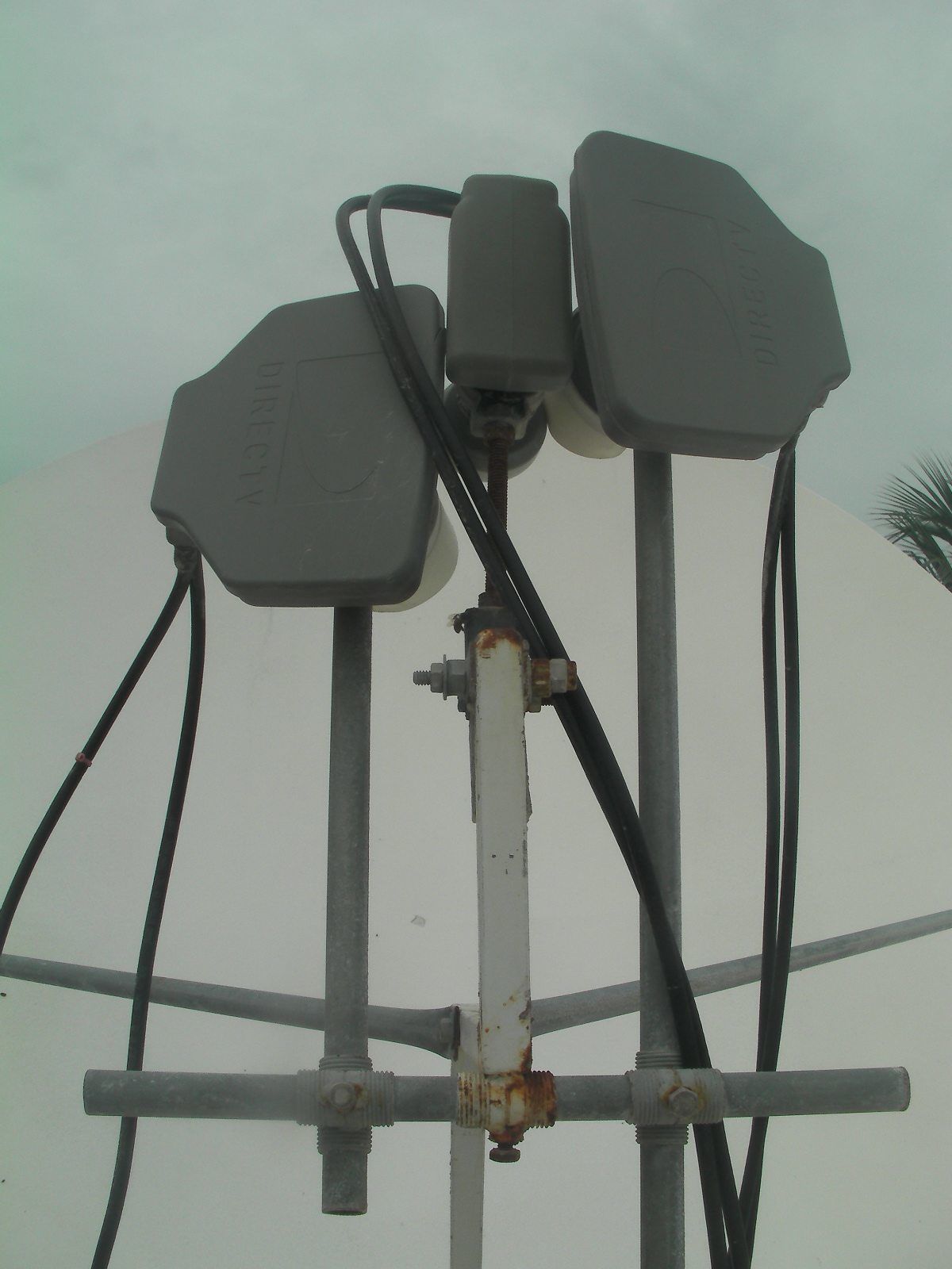

One other thing that is wrong from my point of view is that those brackets from your picture taken at your friend's set up.....
Don't look like they are well located, offset fed antennas have a optimal focal point as does Prime Focus antennas,
believe it or not an offset fed antenna is the most efficient area of a larger prime focus antenna, therefore you may imagine,

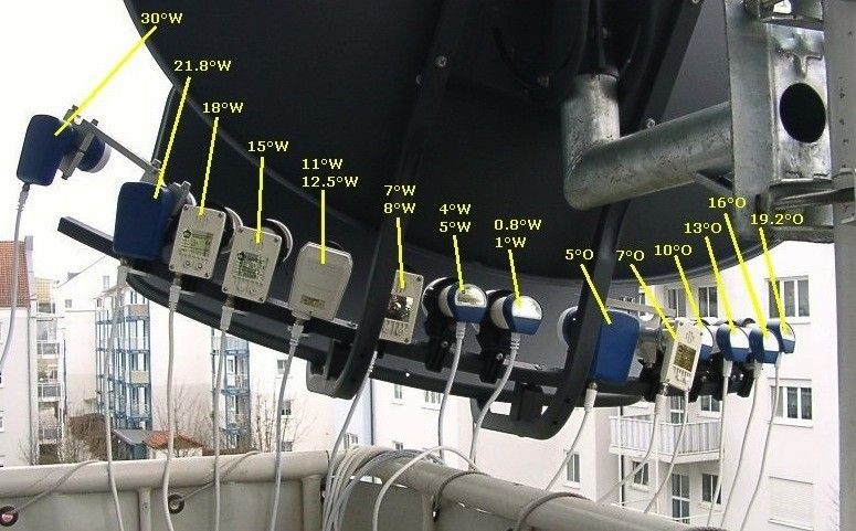

that both might have several focal points and they do, you can aim several satellites from a single dish like these:
Attachment 90359
But not all will take the full surface or gain, but smaller sub sections with lower gain, all easily achieved, when in the footprint like the picture I linked above,
the guy can't be in fringe to get those many satellites with such a small dish.
If you see in detail from your own pictures, you'll see that none of the LNBF's is located in the original antenna's focal point, in other words,
the main Lnbf (101 W) should be resting in it's original bracket, and the other ones should be tilted near it, they could be separated by 3 or 4 inches,
but the pivot has to be in the main lnbf bracket or antenna feed, otherwise he's using a smaller portion of it.
If the feed struts are in the way you must design a mechanism to locate the main Lnbf in the antenna's original focal point.
?If working.....

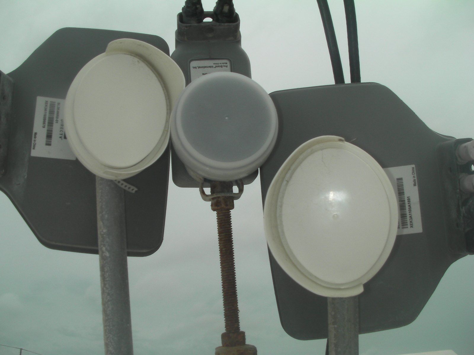

If you watch the picture of the lnbs from the front and behind both Lnbs are really twisted to the inside but not really pointed to the center of the dish. That would indicate a partial reflection only.
Also, I would imagine that on both Ku LNBs the top inside lnb would be the one connecting (not the lowest). That would give the perfect arch.

A 2.4 meter dish has about 4 times more surface than a 1.5m dish. Given that, and also assuming that Satbeams is somewhere correct with its dBS info, only a 1/4 reflection from a 2.4 meter dish would be enough to lock KA signals. Fieldwork will tell.
The guys outer/Ka lnbs are surely pointer in a very odd way.
However, if you imagine:
* the 101W satellite is located above the 101 lnb. Its pointing straight at the center of the dish.
* The 103 satellite, approx. located above the 99 lnb (left in the pic) is higher up in the sky. Therefore the 103 lnb (right in the pic) has to point more down and over the middle. A higher satellite reflects further down.
* The 99 satellite is located above the 103 lnb but lower than the other 2 sats. Therefore the 99 Lnb points higher and over the dishes center line. A lower satellite reflects in a smaller angle.
