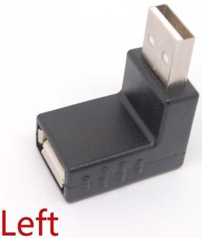

Here's something I found to make removing or changing the internal USB drive much easier... a 90 Degree Left Angle Adapter Plug.
