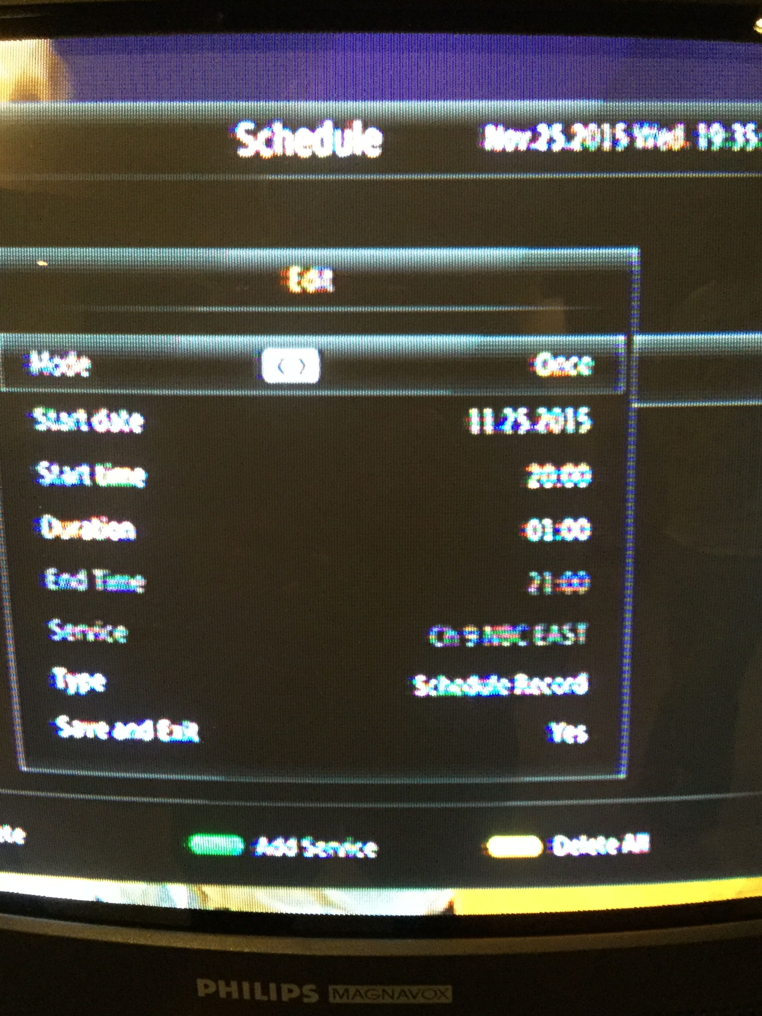

Chad, stupid question, but, is the time set right in the receiver after you did the firmware update?
Yes it auto sets from the internet. It switches to the correct Satellite and Channel when it's time to start. Just won't start recording.

I set timers with my external USB drive as default, but the timers no longer works after updating the firmware to the latest version when trying to record using timers to the external USB, but it will record manually. I can read and play everything I previously recorded from that drive with the media player, just doesn't work with the timers. But the timers works fine recording to the internal USB drive. Any ideas? I haven't tried the front USB port...
What was the last know software version that would timer record for you? I'm pretty sure it was working just fine for me using 1152 firmware version. Can't get it to schedule record a thing using 1213 or 1248 software.
Not really sure, as I don't do much timer recording, but I've been updating the firmware every time a new one is available, so it must have been 1213. The last shows I recorded with timers was in October...
