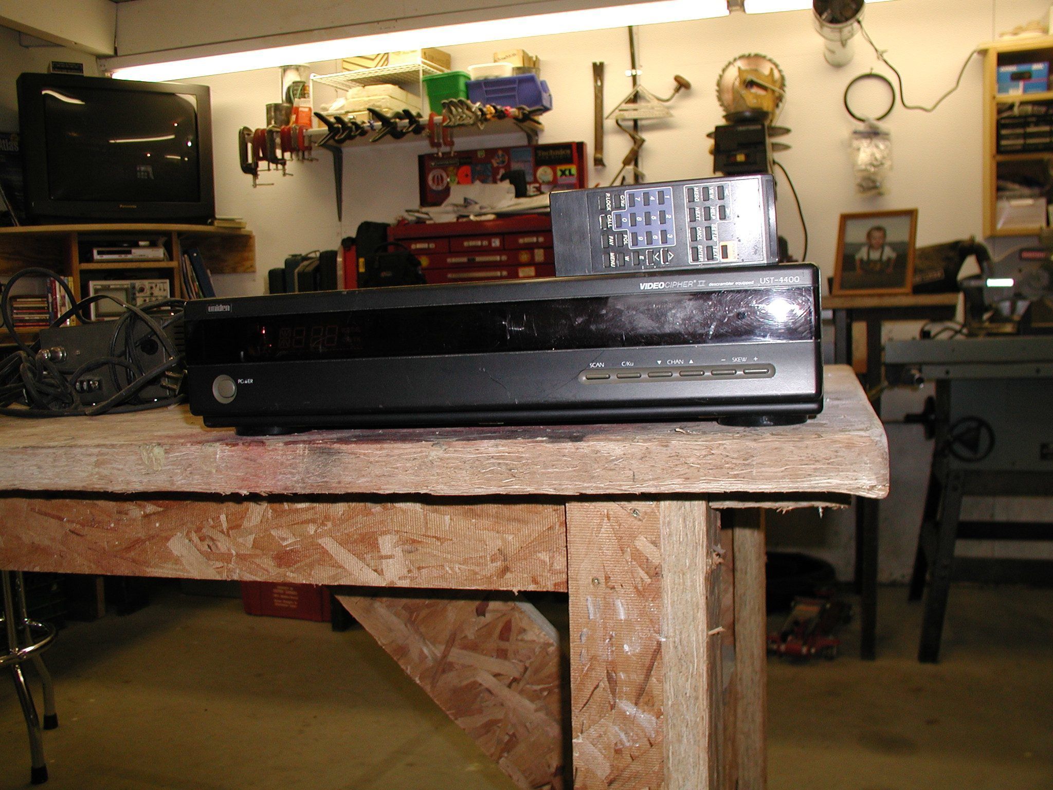

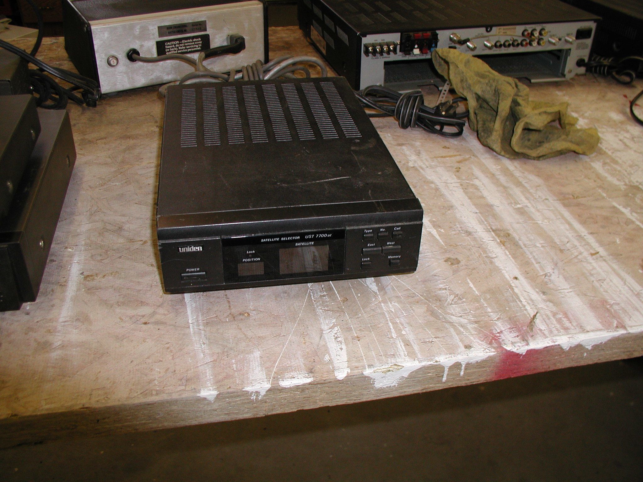

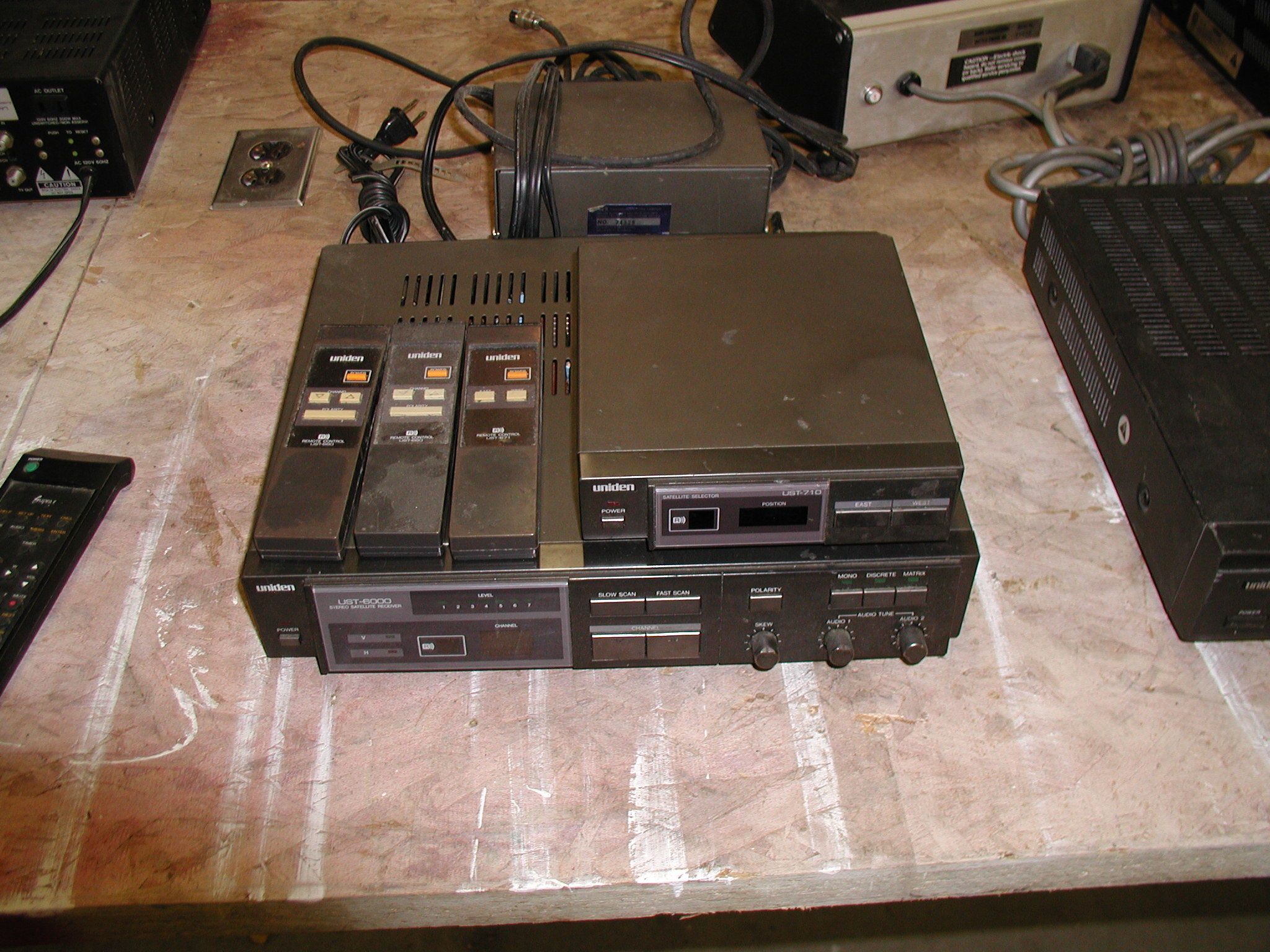

delta_charlie, let me take a look in my "inventory" of old satellite stuff. I might just have what you need. It's time to clean out some old stuff and I likely don't need 6-8 analog receivers. I'll post a list and perhaps some pics later if you're interested.
Nice find and damn.........that's probably the most scaffolding I've ever seen stacked in one place. So good work, that's more than I might have done but it does look like a very nice dish.
So I found a couple that might fit your needs. There's a Uniden UST-4400 with remote that I believe (it's been awhile) had some video issues but the actuator and skew portions worked perfectly.
There is also the older analog Uniden UST-6000 and positioner UST-710 which I have not tested. That'd probably be a good bet if you wanted something very very simple to use. It has 3 remotes (two for receiver, one for positioner) which haven't been tested either. You can't set individual satellites but it could be used to bump east and west with.
Then there's a Uniden UST-7700at, just a positioner no remote but very straight forward to use and very easy to store satellites with.
There's also 2 Uniden Supras, one of which I'm going to keep for my setup and the other one I believe had video problems.........I'll really have to look it over. Only thing is I only have one remote for both.
I also have a Star Trac 400 which doesn't have a power supply for an actuator, it was optional. This one would probably be good just to control skew and get the occasional analog feed.
If you (or anyone else) is interested or thinks they can use any of these I'll let them go for nothing, just pay me the shipping costs. If you want more pics let me know.
