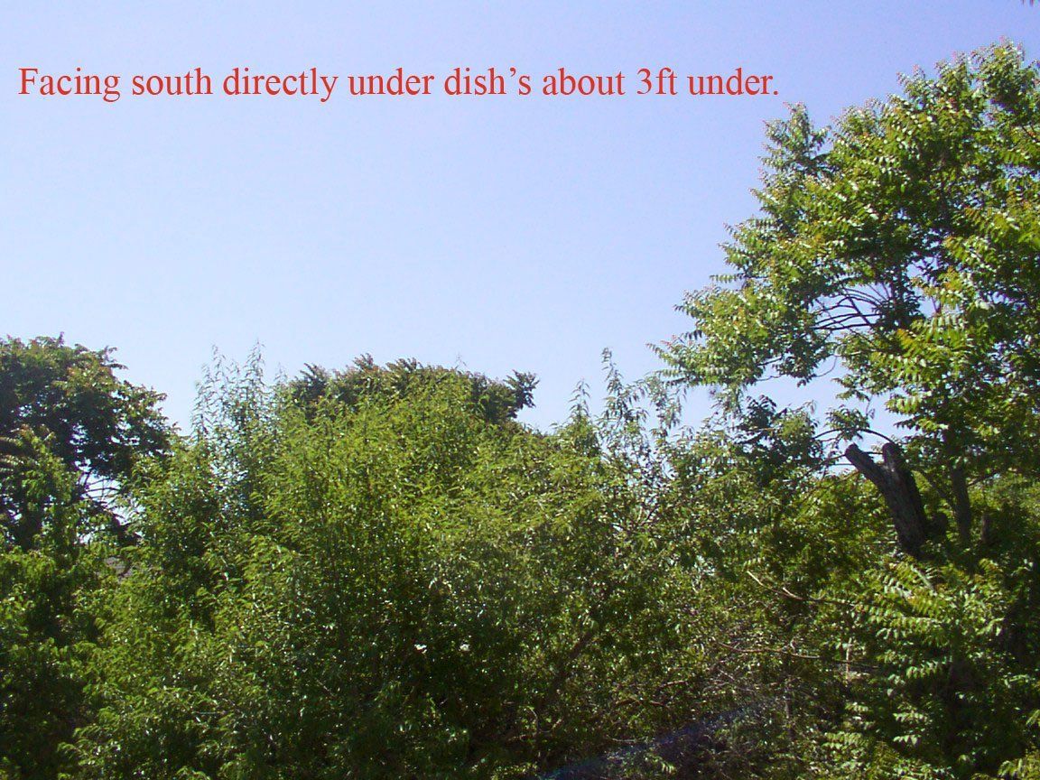

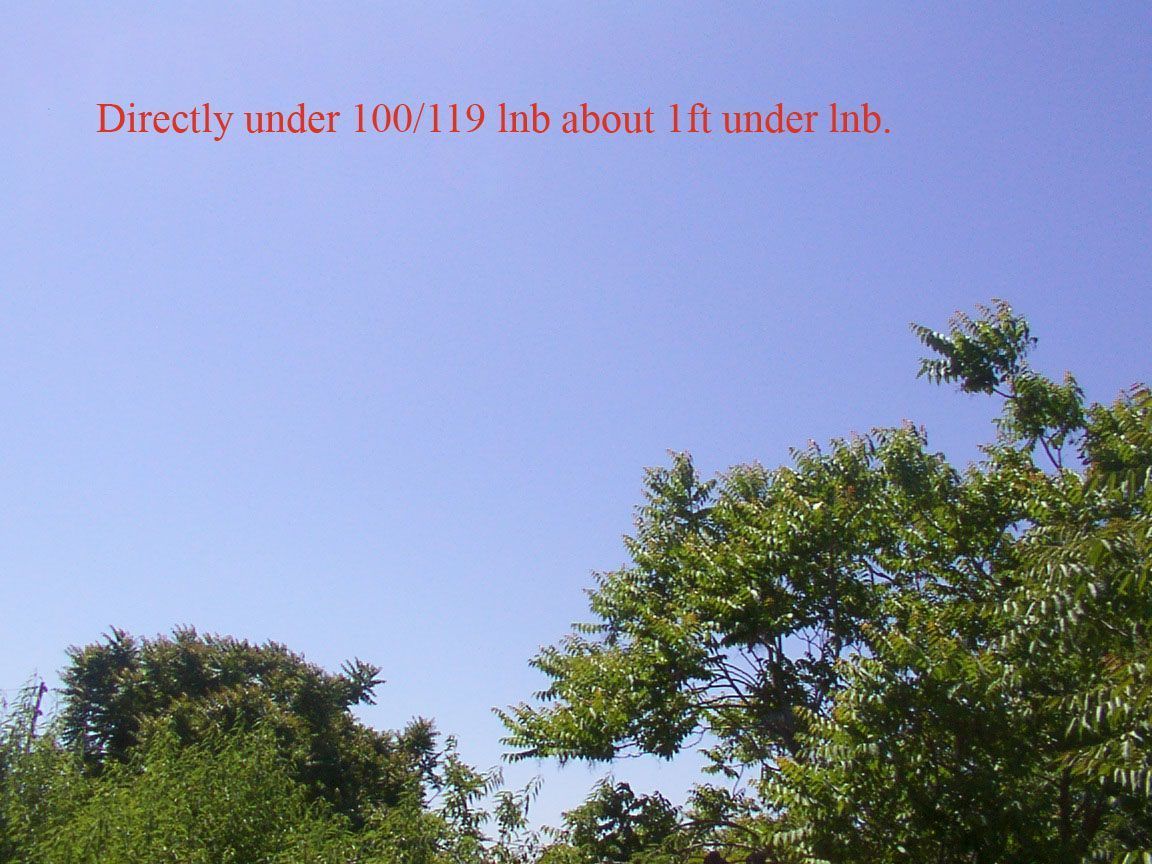

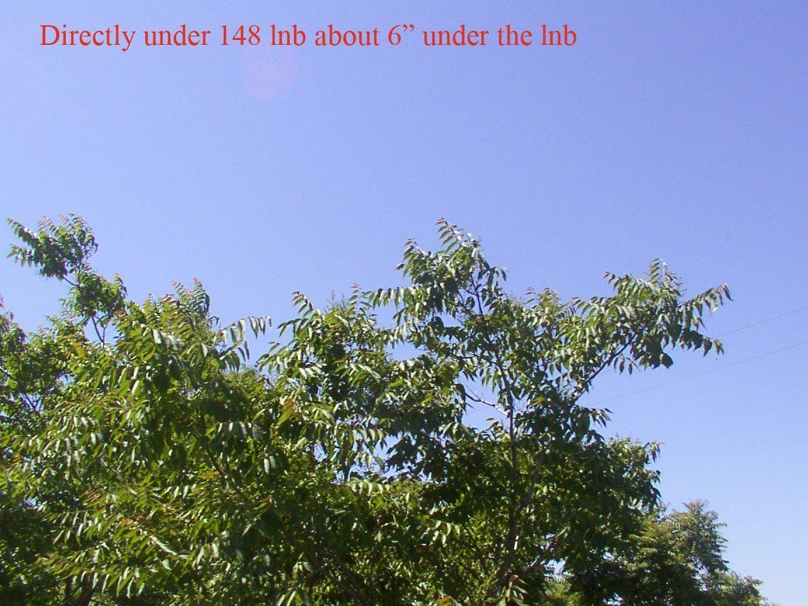

Ok i will try that, i just looked out back and i think i might have a big problem in the form of trees lots of trees.. We had a very wet winter and now suddenly lots and lots of sun the small trees are growing fast i had no idea they were as large as they are. I dont go in my back yard much cause its too cluttered cause my dad lol. I will snap some pics i wonder if i can just turn my dish to the 129?? cause 148 seems to be blocked by the trees now. My zip code is 95205 do you have any info for aiming to the 129?

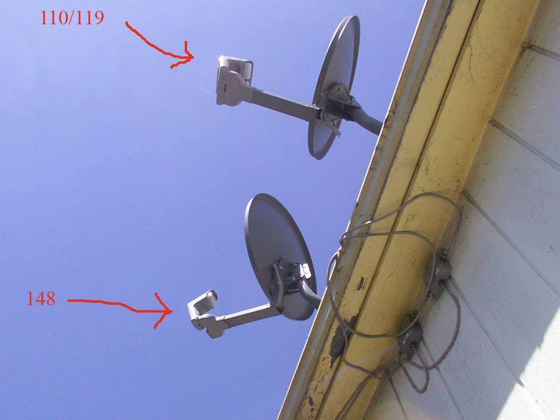

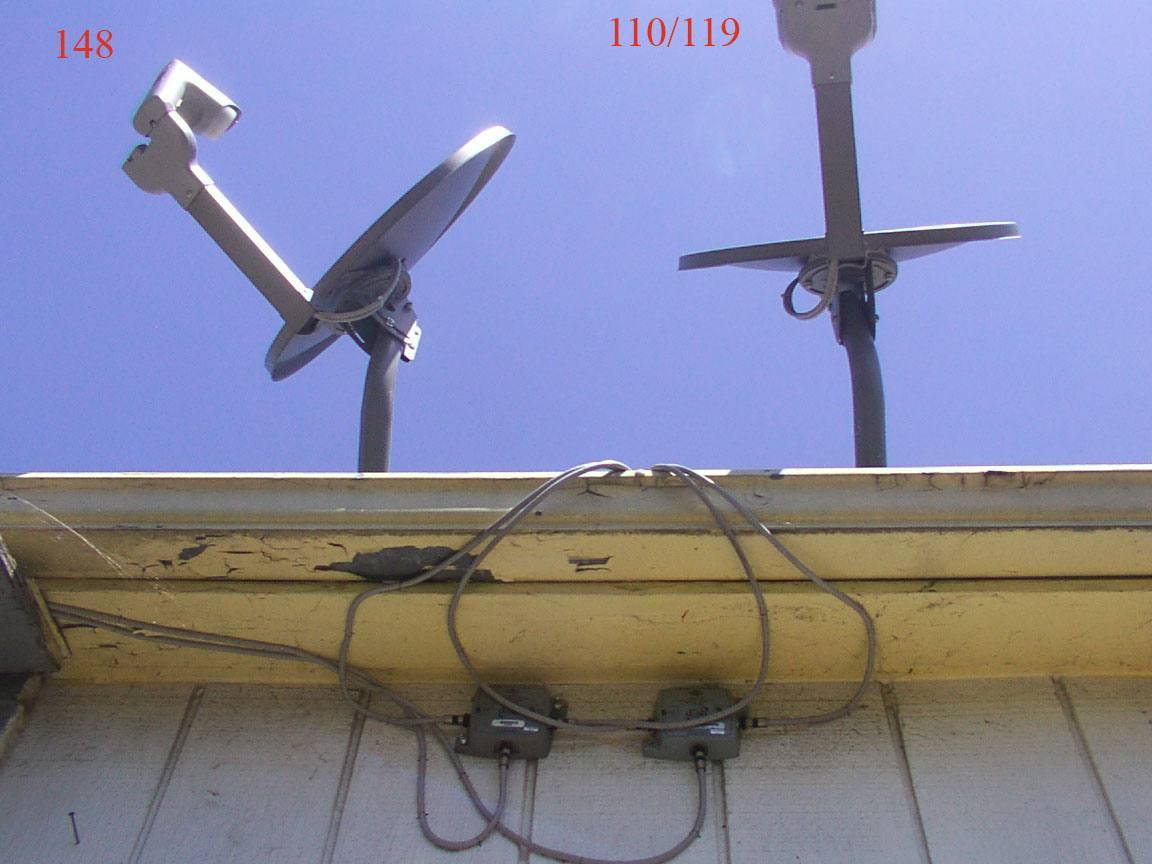

Here are pics i am not positive what switches i have.

in pic 2, the boxes under the roof are DP21's
so you have a DishPro Twin at 110/119
DishPro Dual on 148
2 DishPro DP21's to combine them

As for the trees, the dishes are offset, which means where the dish is aimed is 22 degrees below the "actual" aiming area
the signal comes down, bounces at a 22 degree angle off dish and hits LNB...so those trees are fine.
