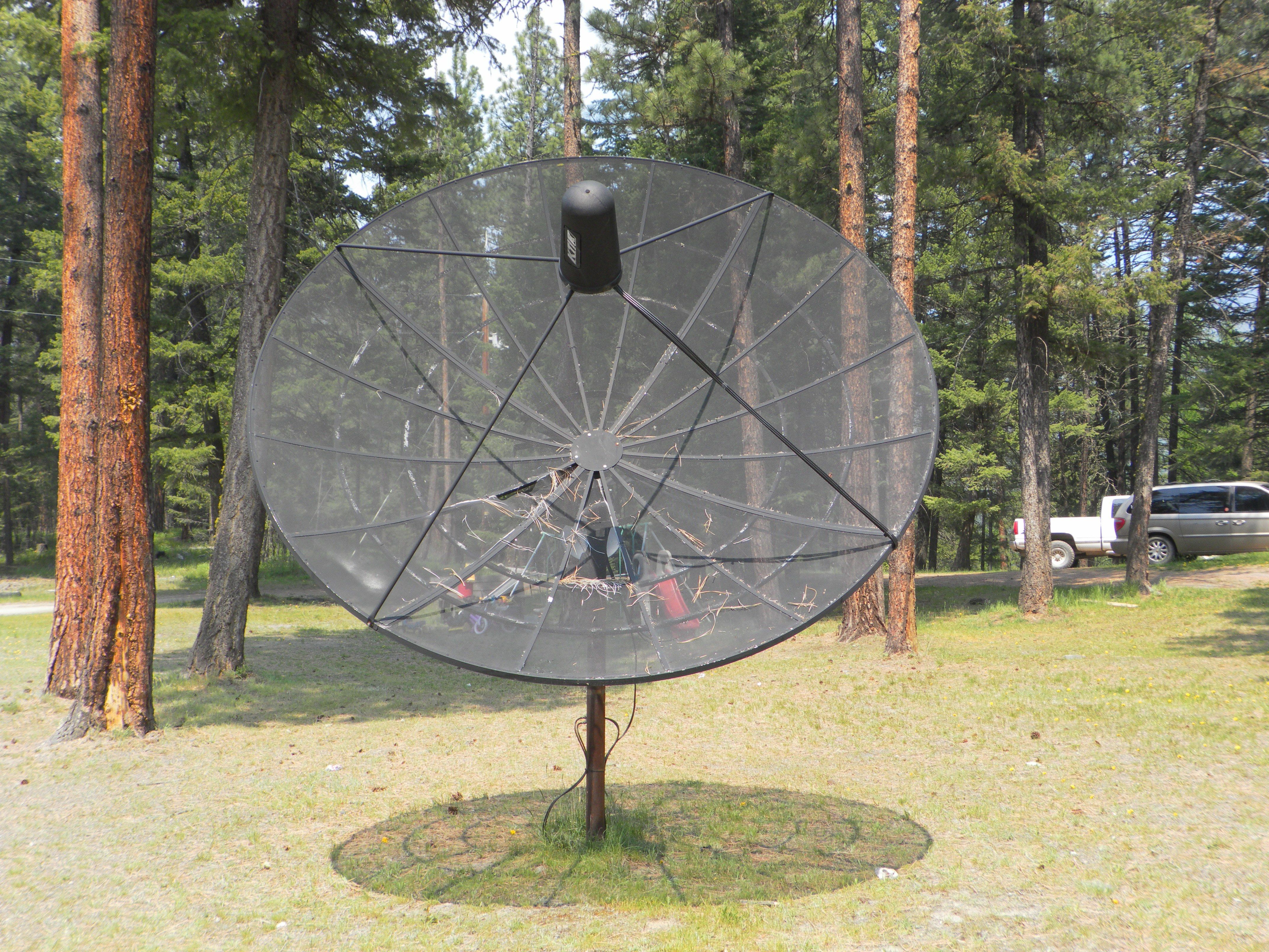

I can't help it. Must be a disease. ;) While wandering around a couple days ago I came across a 10' quad panel KTI that was headed for the scrap pile. I don't need a dish and this one needs some extra love but you just don't throw away a C-Band dish, do you?

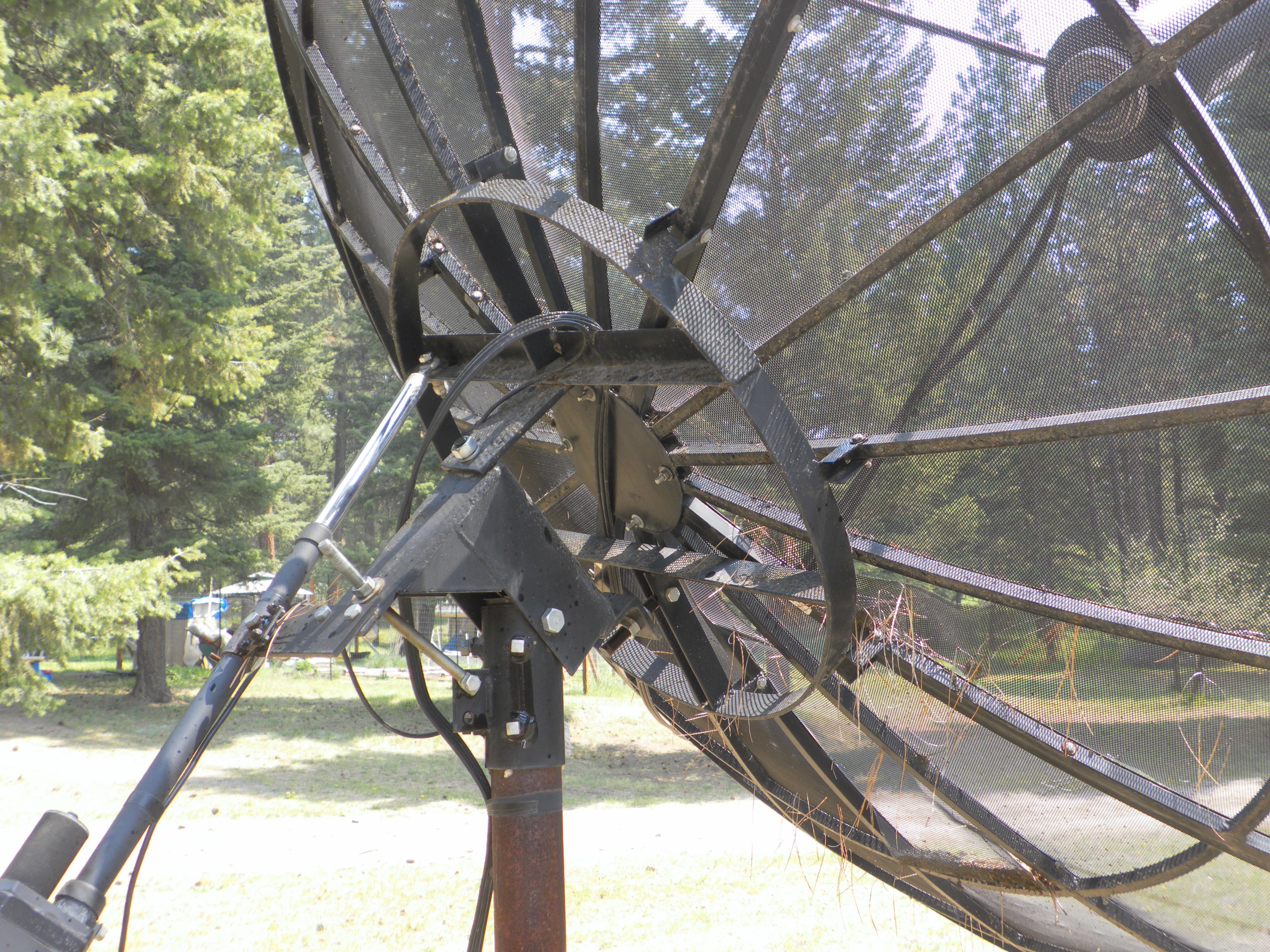

One shameless plug deserves another ;) One easy way to identify the KTI dish is by the construction of the cross supports. The Winegard and the Channel Master quads have one support ring made from 1/2" tubing. The Uni-Mesh has one support ring made from the same square tubing as the radius arms, The KTI has two support rings made from square tubing providing a very rigid frame for the mesh. It also attaches to the dish ring at eight locations, not four like others. The dish in the picture above has been through 30 Montana winters with the owner beating the snow off of it with a snow shovel. Hence the damage to some mesh :(

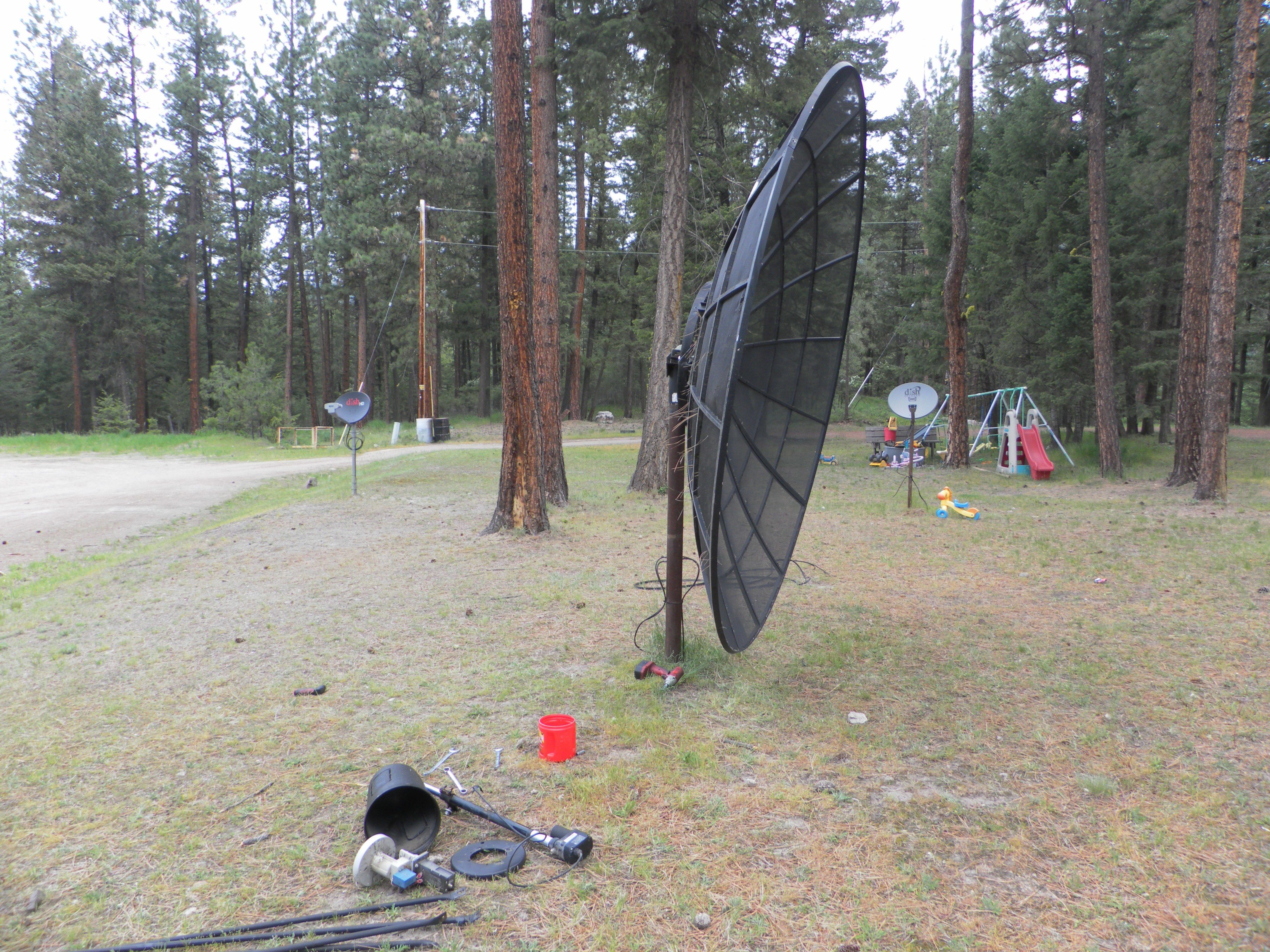

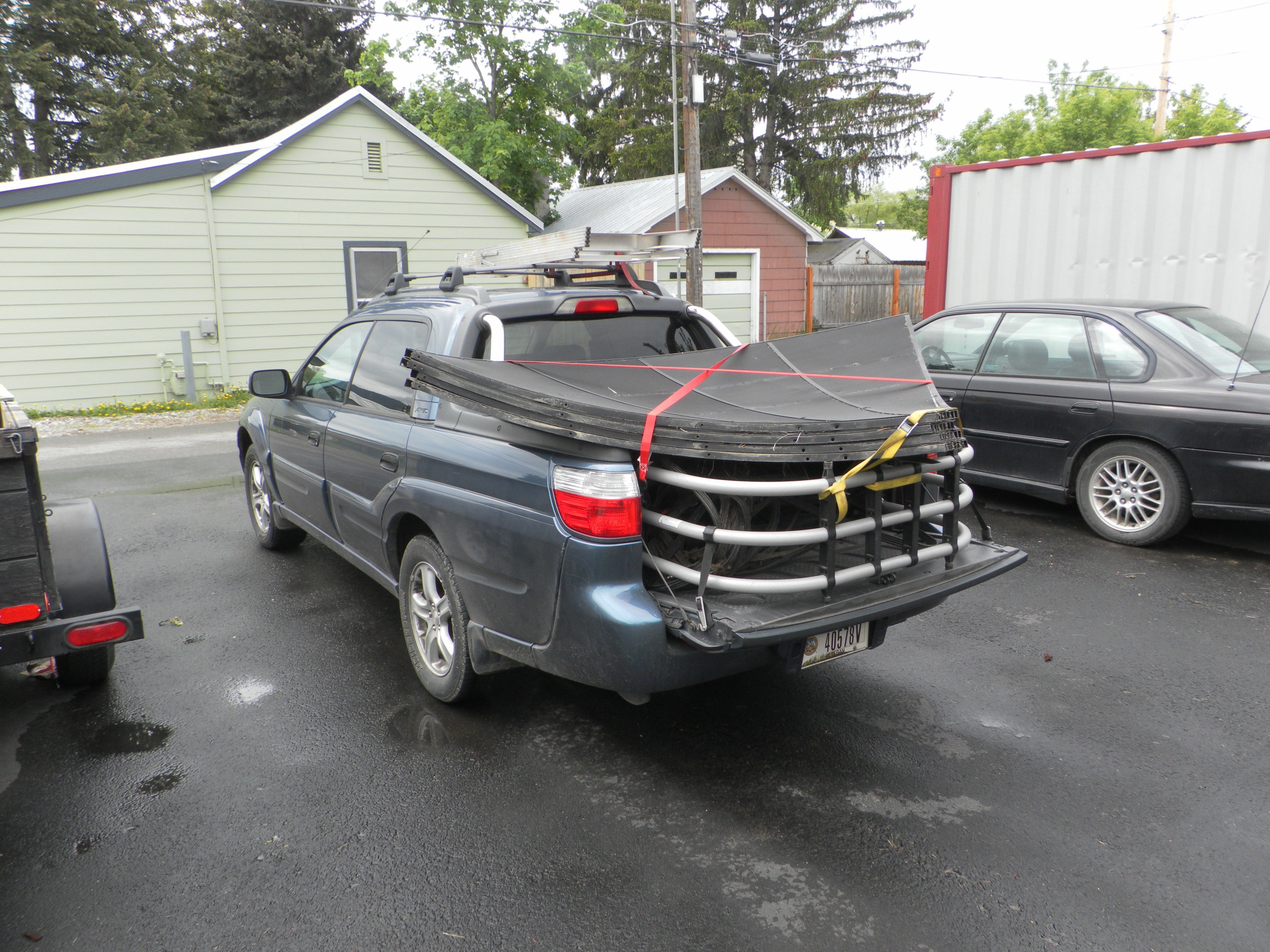

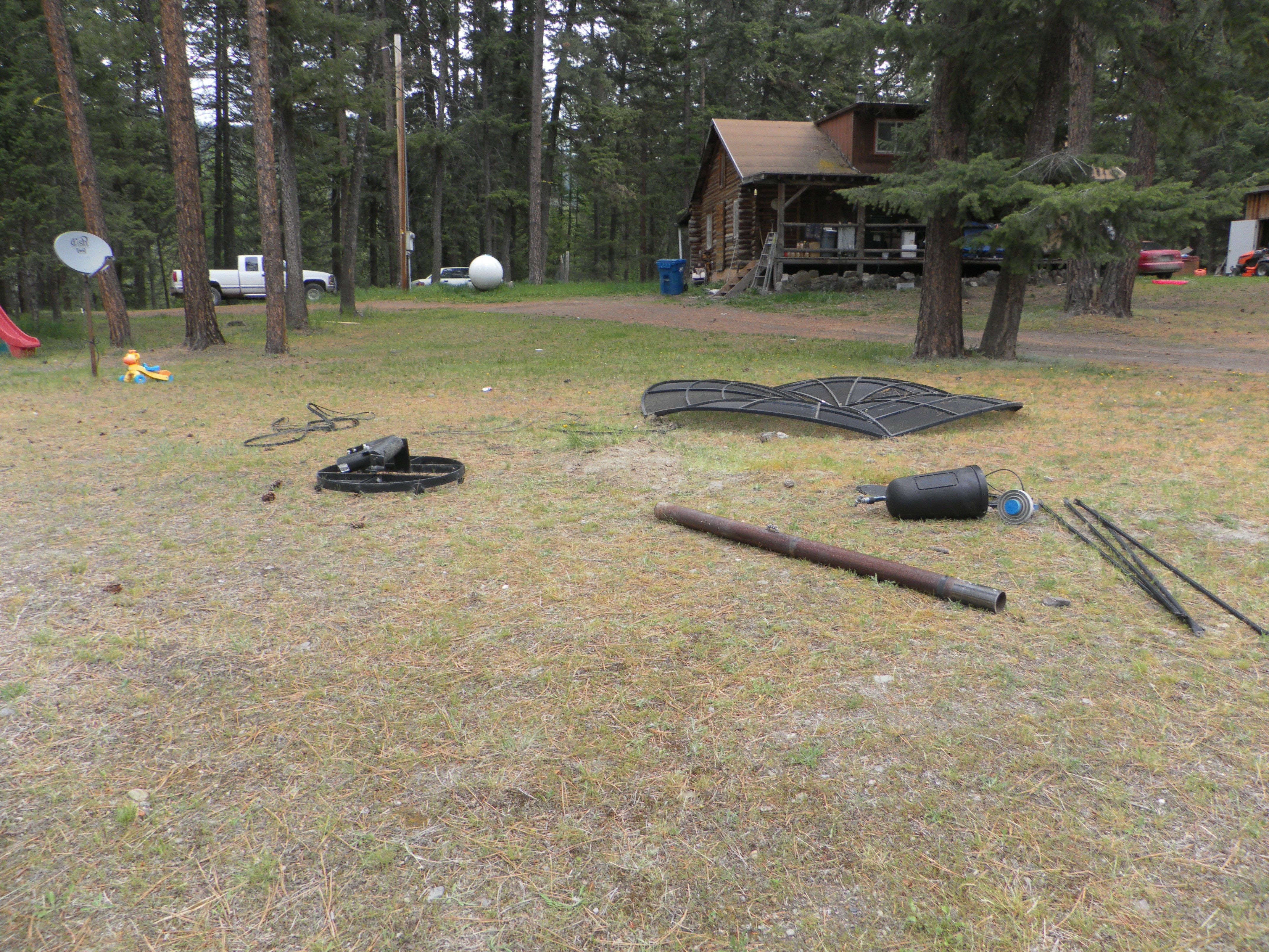

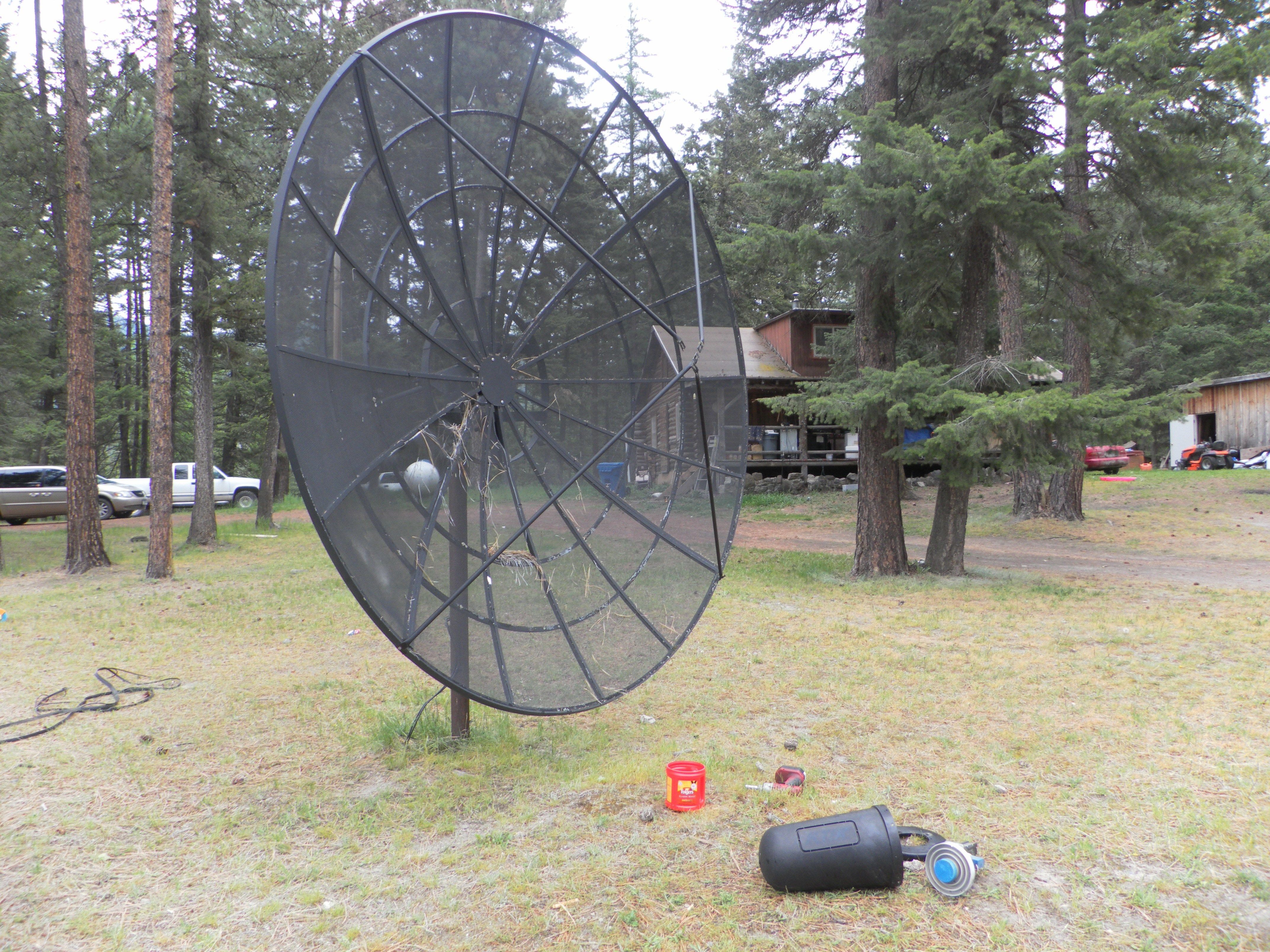

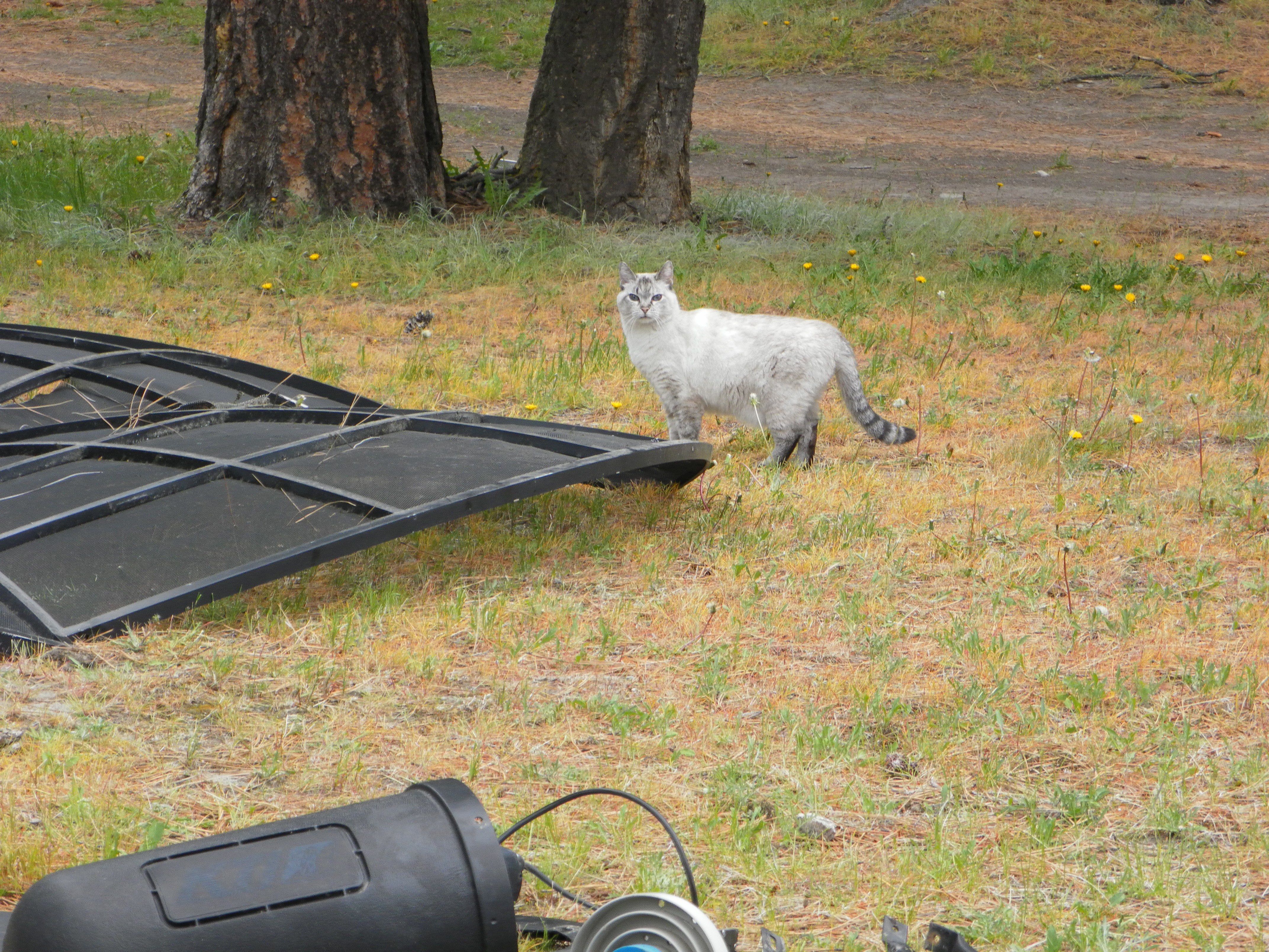

Today was cloudy and cool. Great weather to pick up a dish :) I grabbed the KTI and was back home in two hours. No stuck fasteners :) Way to much concrete in the rocky ground so I cut the pole off and pulled the ribbon cable.
