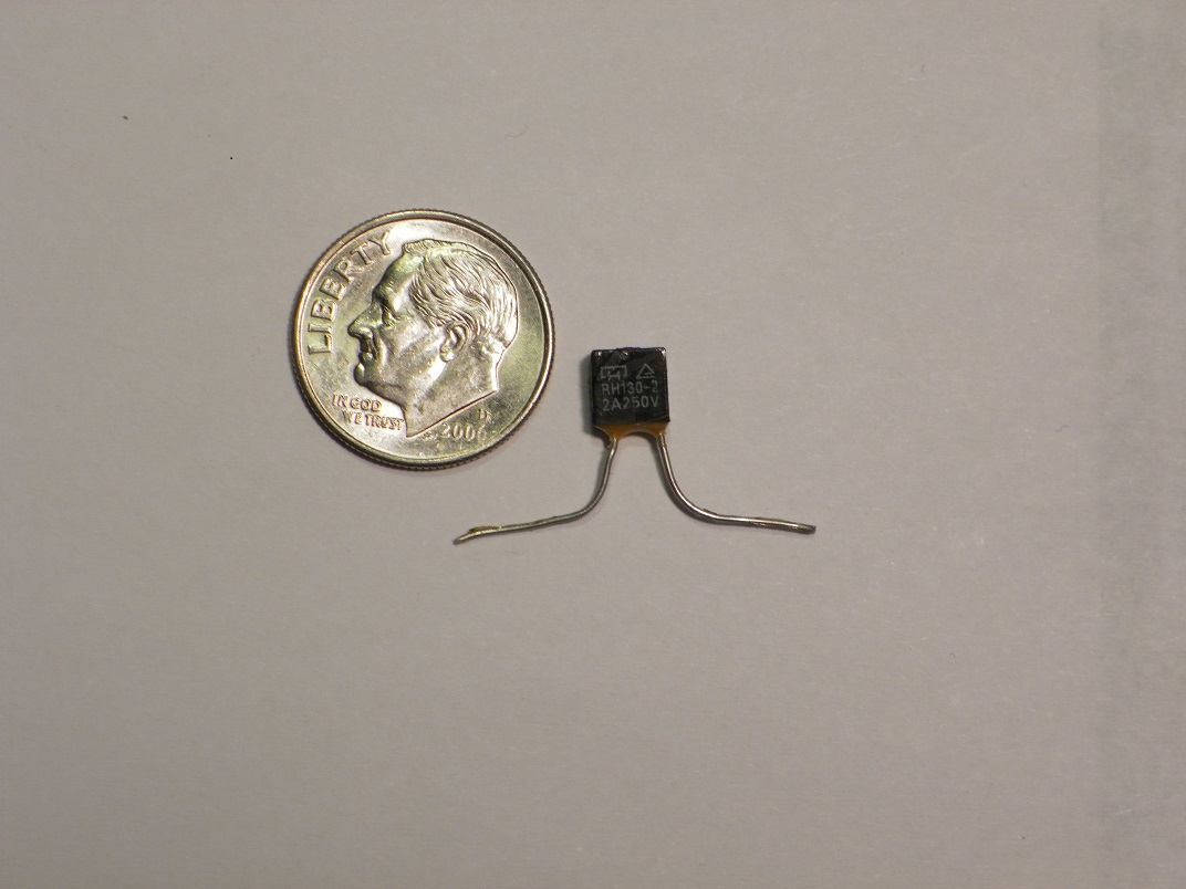

What series of Vbox has a replaceable fuse?? My Vbox X doesn't have one like that but instead has one embedded in the transformer coil that has to be soldered in.
That would be the one made by DMSI the VBox 7. The VBox X is made by PowerMax. The first time I overloaded the VBox X the little built-in circuit breaker did not reset and I ended up digging it out of the transformer and installing a fuse holder and a 2A fast blow fuse in the unit instead. Still working good :)

I only have a Vbox7 from DMS International with the fuse on the circuit board. If the Vbox X has the fuse mounted in/on the transformer I would be very wary of replacing it
with an external one. Highly likely it is a thermal fuse, designed to blow in case of transformer overheating to prevent a fire. Insurance won't cover damages if the original safety design has been altered/defeated and the worst happens. Fire_2.gif Know it can be annoying to replace/repair but just saying.... :rolleyes:

It's not a fuse actually. It's a self resetting circuit breaker. The one I had never reset after blowing. the "self resetting circuit protection" is one of the features they advertise on the unit.

The RH130-2 is most likely a TCO (Thermal Cut Off) fuse built into the transformer in the event of overheating (in your case 130°C /266°F). They open internally when a specified temperature is reached and generally don't reset. The "self resetting circuit protection" could be provided by one or more PTC resettable fuses (polyswitch) on the circuit board. PTC fuses open the circuit under an overload condition and then return to a conductive state after the overload is removed, acting like a circuit breaker. Through the board PTC's look a lot like a ceramic disc capacitor and can be round, square or rectangular. They also come as surface mount devices. Examples:
As i said, I have the Vbox 7 so I don't know what components are on the Vbox X circuit board. Not being critical, just trying to help avoid a bigger problem down the line...:)
You're right! I stand corrected :) Since I saw where/how they placed this thermal fuse, I now have no doubt there would be issues. All the same fuses I saw had the temp rating on them. This one only shows it through the part number. The Volt Amp numbers had me thinking current protection device. Since they advertised self resetting protection I Ass u me d ;)

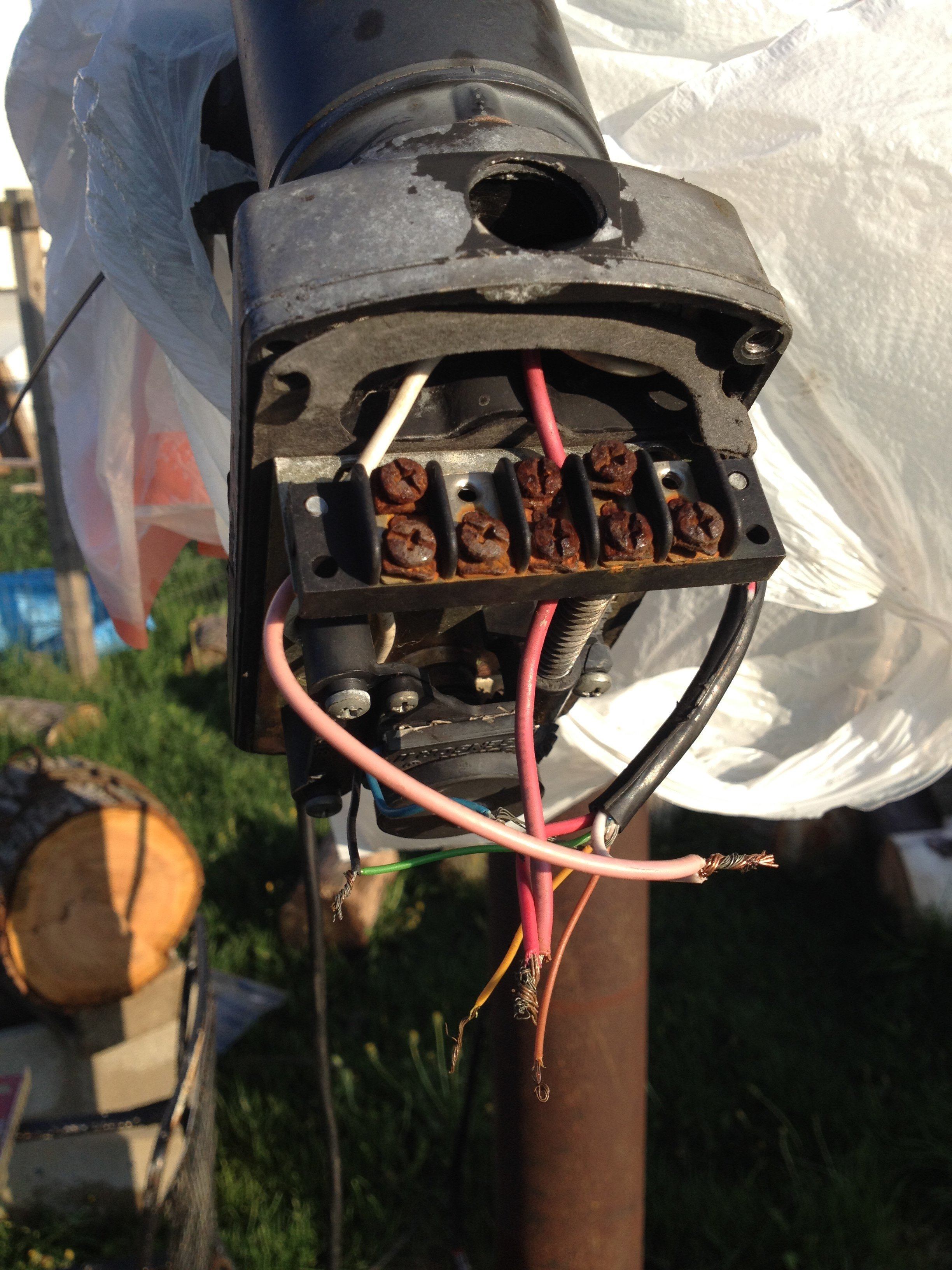

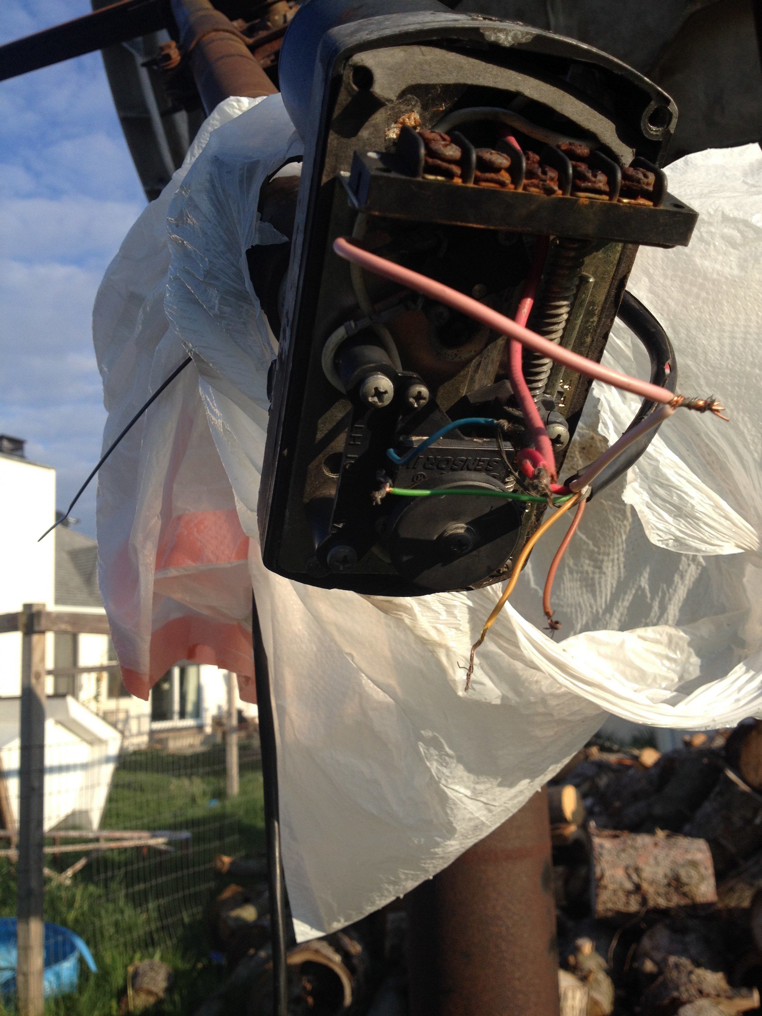

Got back from rat shack with some new fuses. I tried the vbox on a actuator that works and it worked fine. I tried it on my new (new to me) actuator and I only got two counts and the fuse popped. I hooked it up directly to the motor when I tried it. What should I try next?
Sounds like the Venture actuator is drawing too much current. Is the actuator binding? If the actuator is rusted/damaged or the motor is failing, it could be drawing much more than if it were working properly. If you have a amp meter check the current draw. Check that the tube and/or gears are not corroded and well greased.
The motor looks kind of rough but it runs smoothly with no binds and its well lubricated. When hooked up to the battery charger it runs fine. I need to get a back cover for it. I've been using a trash bag with holes in the bottom for drainage.

Do you have a meter to hook in line to measure the current flow? You may have to try a slow blow fuse, if that motor has a little higher start-up current.
Yikes! Looking at the pictures you have this wired incorrectly. You have one of the sensor wires twisted together with the motor wires. Those two circuits are separate. That may have killed that sensor. Ok I looked a little close and the shield is being used for a conductor on the sensor.
Current draw should be well under an amp if not moving a dish ' off the bottom'. Got an ammeter in the battery charger?? If not, use an inline fuse. Start with a 5 amp, if it don't blow, try a smaller value one. When you hit the one that blows, you can deduce the current draw. But here again, the amp draw will be increased because of low voltage*. More accurate if you use a 24 to 36 volt source.

My battery charger has an amp meter but its not very detailed. Will car fuses work for inline? Ill see what I can find.
