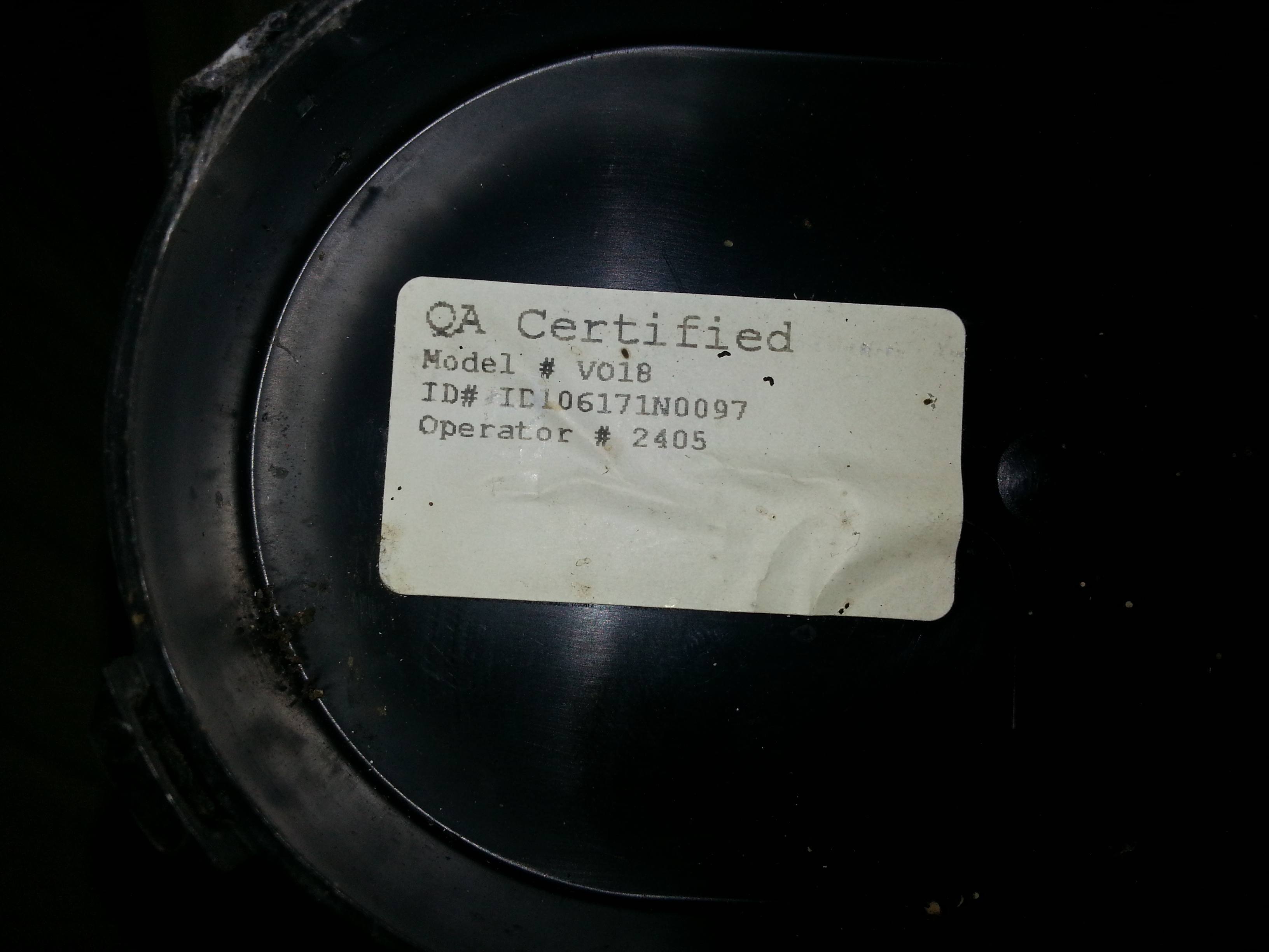

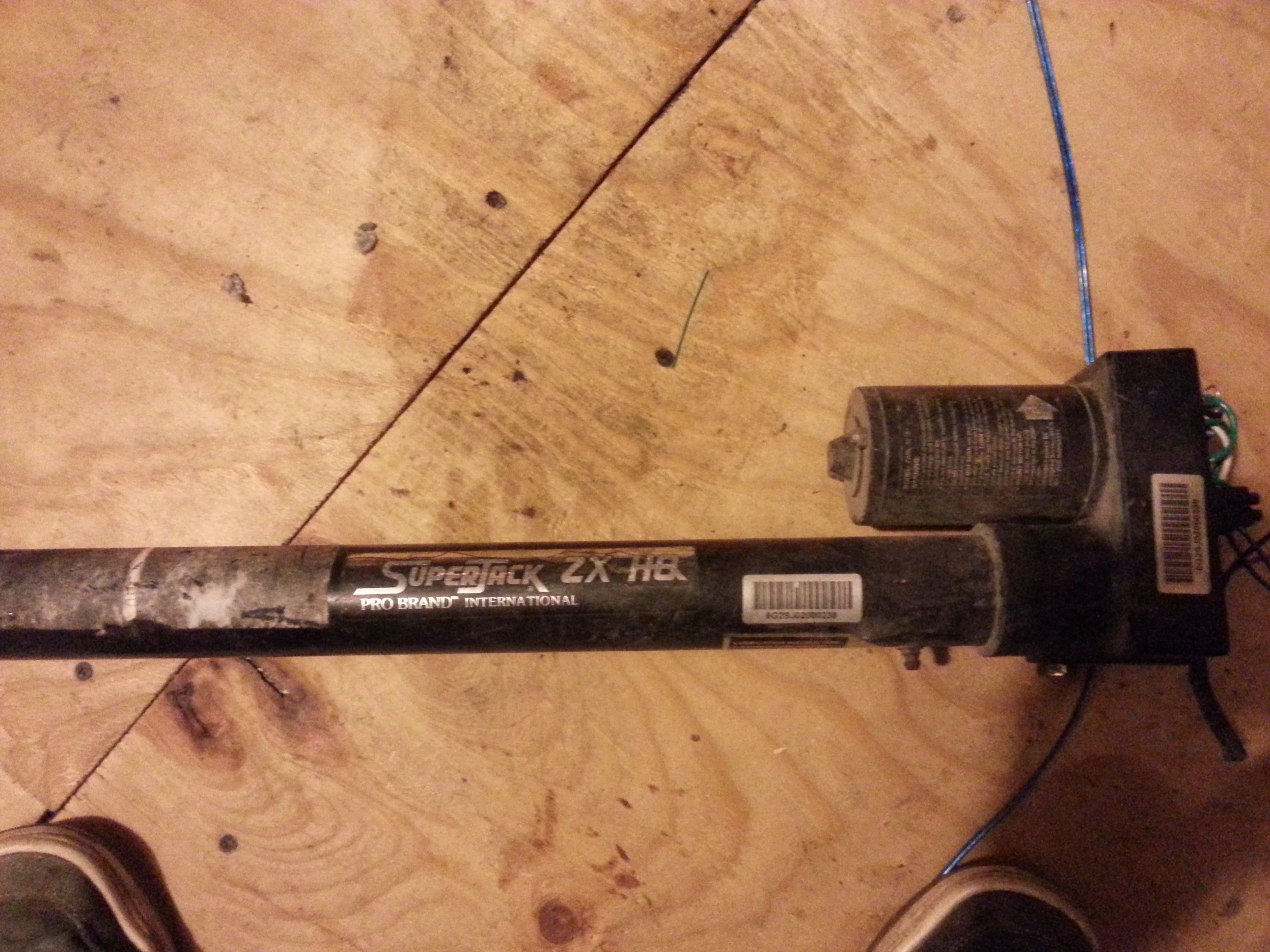

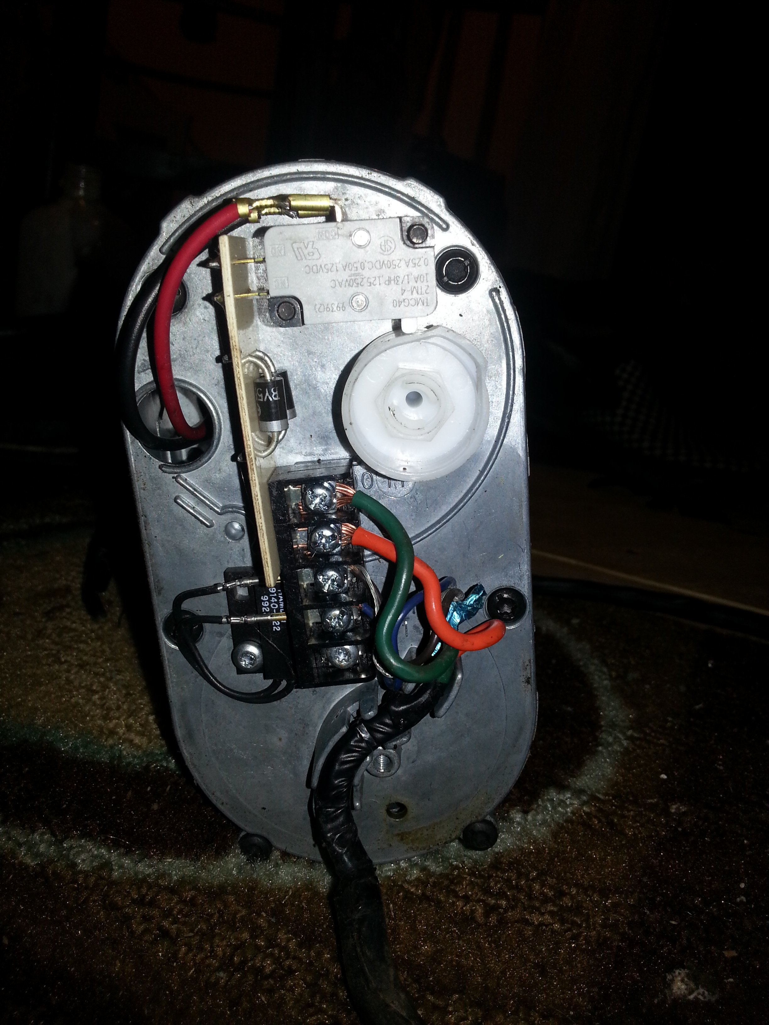

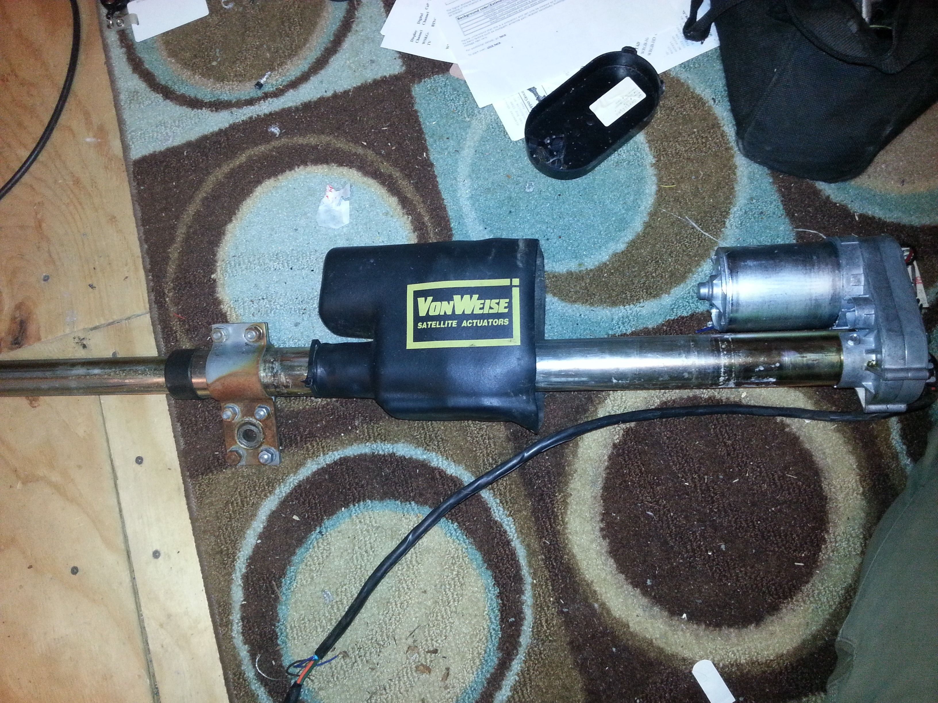

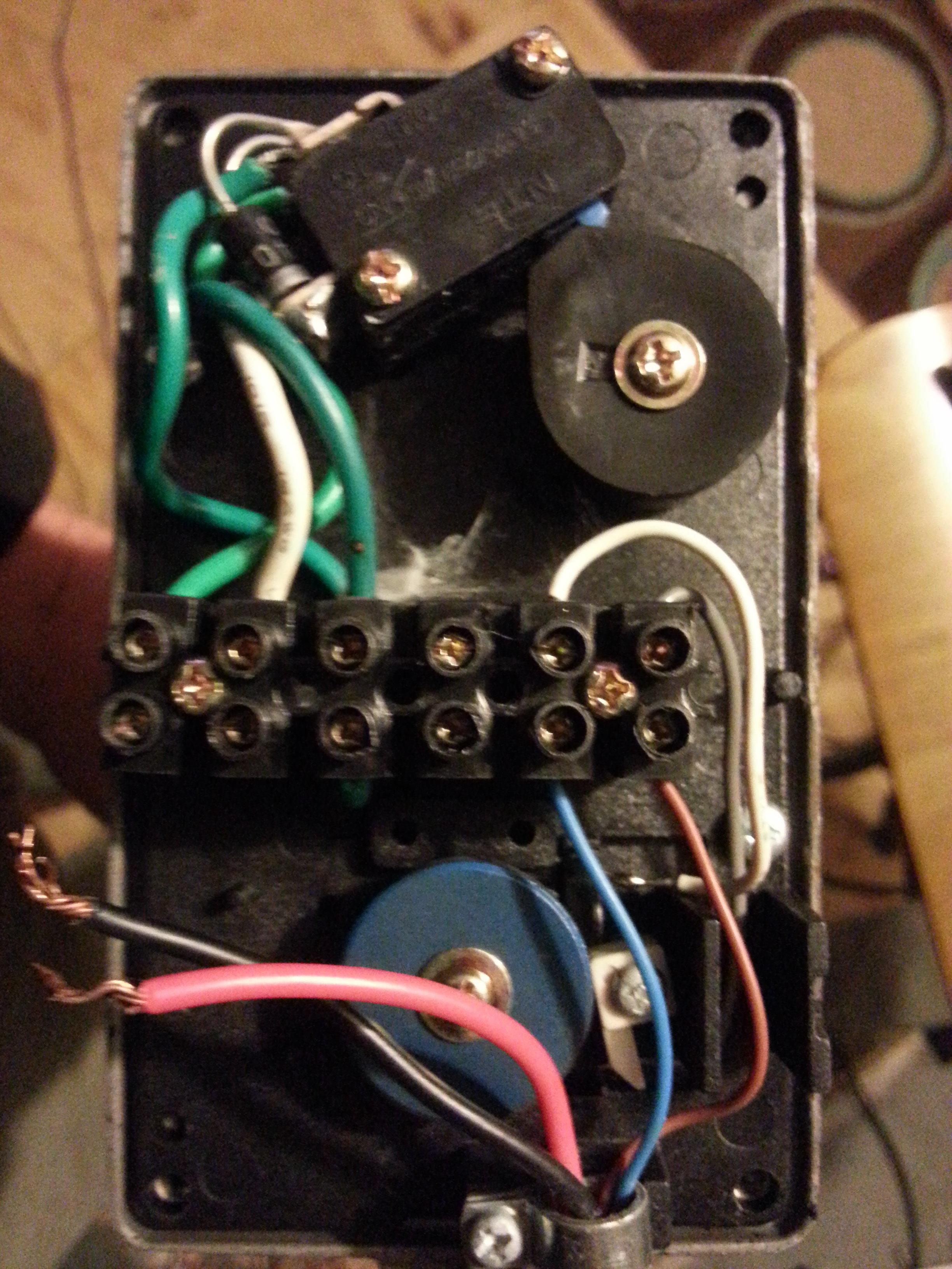

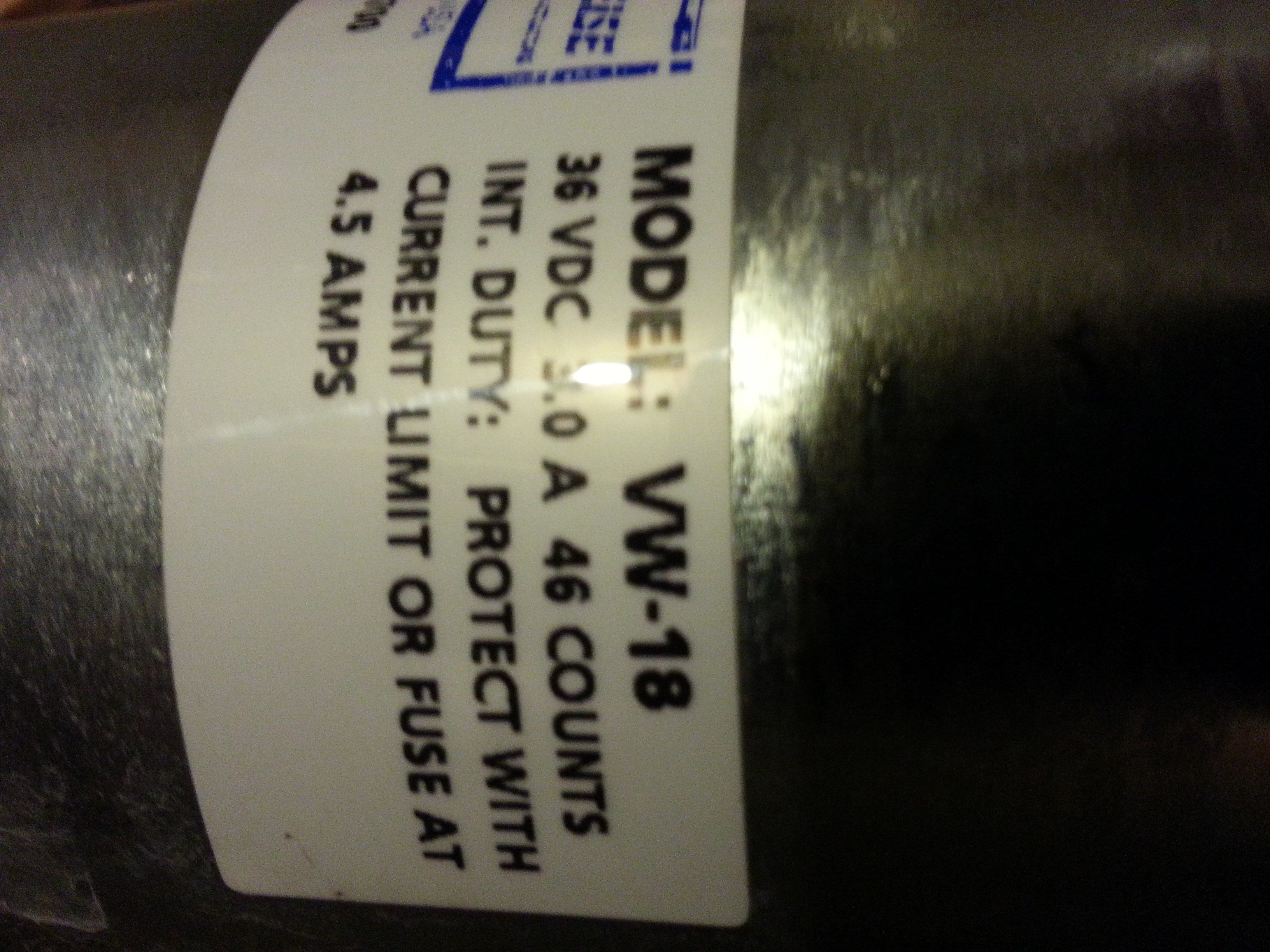

Im still having trouble setting up my arch properly. But, I swapped out the actuator for another one that a guy gave me. Here's some pics of the old and new ones. I have a V-Box coming in the mail coming today.
Here's the old motor. Nothing wrong with it. 20130515_205339.jpg20130515_205252.jpg20130515_205239.jpg20130515_205650.jpg
Here's the new one. Appears much sturdier and has a grease fitting which I like. 20130515_064457.jpg20130515_064548.jpg
