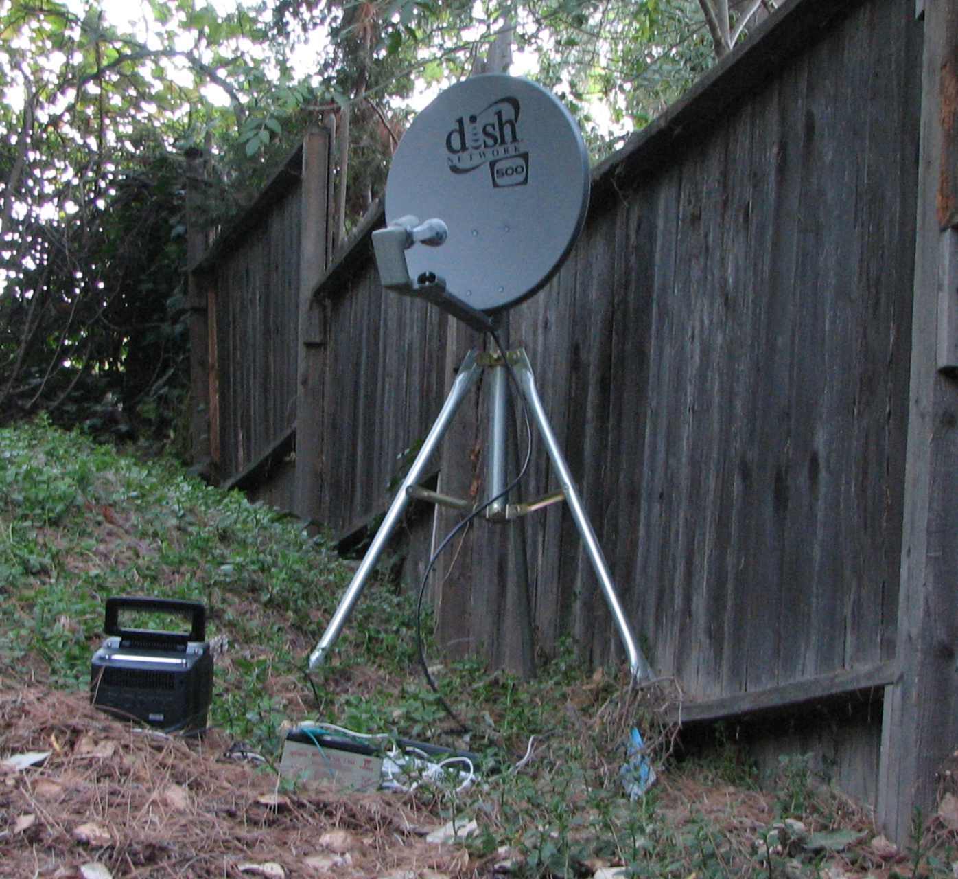

A Dish 500 works pretty well on a tripod. I got the tripod for $18 off eBay, and used half of a fence post for the pole. It's actually pretty stable even with nothing weighing it down, although in windy areas I would recommend putting heavy bricks or cinder blocks on each of the feet.
I actually had a motorized 75cm Primestar mounted on the thing for half a year and it never blew over! :D I also had a fixed Fortec 90cm on it for a while and it worked well too, but was a bit too top-heavy for my liking. One problem though: with both of those dishes the tripod itself would twist a bit in the wind (although it didn't seem to affect the signal much).
For the lower elevation satellites, turning the dish upside down helps to make it more stable in the wind. It causes the dish to be at a higher elevation setting for a given satellite, which puts more of its weight over the center of the tripod and reduces it's wind profile.

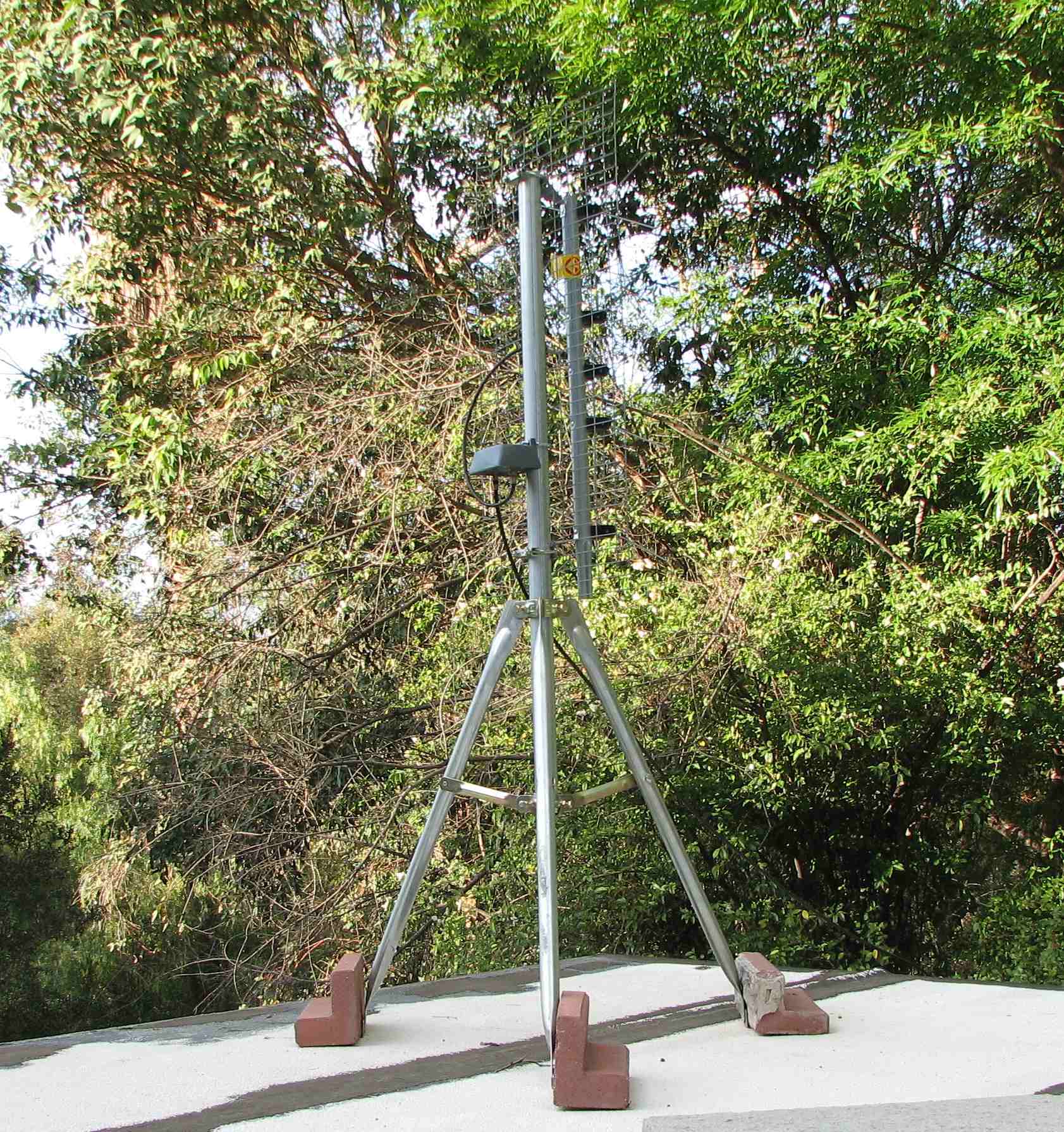

It also works great for small OTA antennas, which is what I use it for now.
