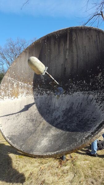

Here's a picture of it.

I guess I should added this in my other post, but the actuator looked pretty good. My next question is if I can be pointed into the right direction of what I should do next. Such as how deep should the new pole be? How do I control the actuator?
Welcome to SatelliteGuys Penguin0456!!
To control the actuator you will need a vbox or the best would be to get a Titanium ASC1.
So far the only thing I can identify is that the lnb is a gardiner c95-50. The dish appears to have at some point in its life been altered to have a different lnb on it, because it has a universal looking mount on it.
Although old and will be replaced, can I test this anyway to verify it works still?
Also can I be pointed to perhaps documents that kinda give me proper terminology. And how this system works?
