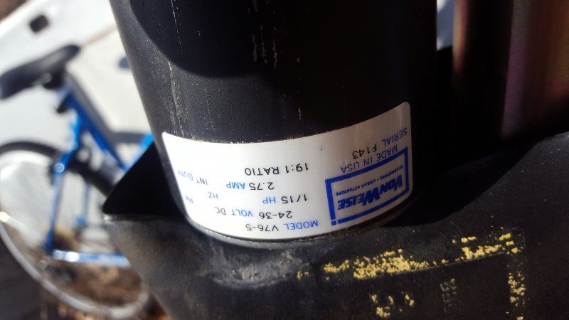

This a photo of the actuator.

That's really cool to know, that it's fully serviceable!

Hi,
the weather protection for the engine is standard in the scope of delivery at V76-5 in bye estore with it?
My english is not good. That's why the question. An Accordion boat as protection when extending the
telescopic rod is included?
Does anyone know exactly?
Greetings

I dont know for certain but my guess would be yes, that the accordion boot is included with the actuator. They sell a replacement boot for $40 without the VonWeise lettering.
Someone who has bought one will likely post to confirm, or you could email VonWeise and ask them.
