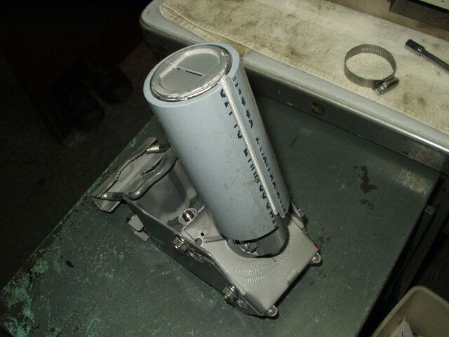

UPDATE: I was seeking advice/help with this HH90 stub because it's too small for that Winegard sd3100 mount and was hoping that there was a "simple" solution to that problem. Well, that doesn't seem to be the case so today I got my thinking cap on and went looking here in the shop for something to make a bushing. I know this might look like a "rig" but it's the best I could do without spending money and all this stuff was just laying around my shop.
So my material list is as follows:
1 1/2" Schedule 40 PVC pipe
2" OD 16ga steel tubing, which is a piece of race header pipe I had in scrap.
All were cut to 5" lengths. The first piece was split into two pieces because of the knob on the end of that stub but the other two were just split on one side. All pieces installed and with a SS hose clamp on'em that stub OD is 2.390", which falls almost in the middle of the Winegard spec.
So can anyone give me a reason why this won't work before I spend money for that dish?

By-Golly that will work!

Winegard has 2 different types of mounts. One has a teethed plate that clamps onto the pole with four bolts. (the other I think is like dish uses on their smaller dishes, curved metal held together with 2 carriage bolts) The plates are weak but sufficient if you do not over tighten them. Would almost be better using two muffler clamps with the support against the dish side. When I had my HH90 I put a rod through the hole in the motor shaft to help keep the dish from turning. the problem comes if the dish has a bolt that runs through the clamp as a pivot point and it is where the motor shaft is. You will have to look at the mount for the dish to see if this is going to be a problem or not.
