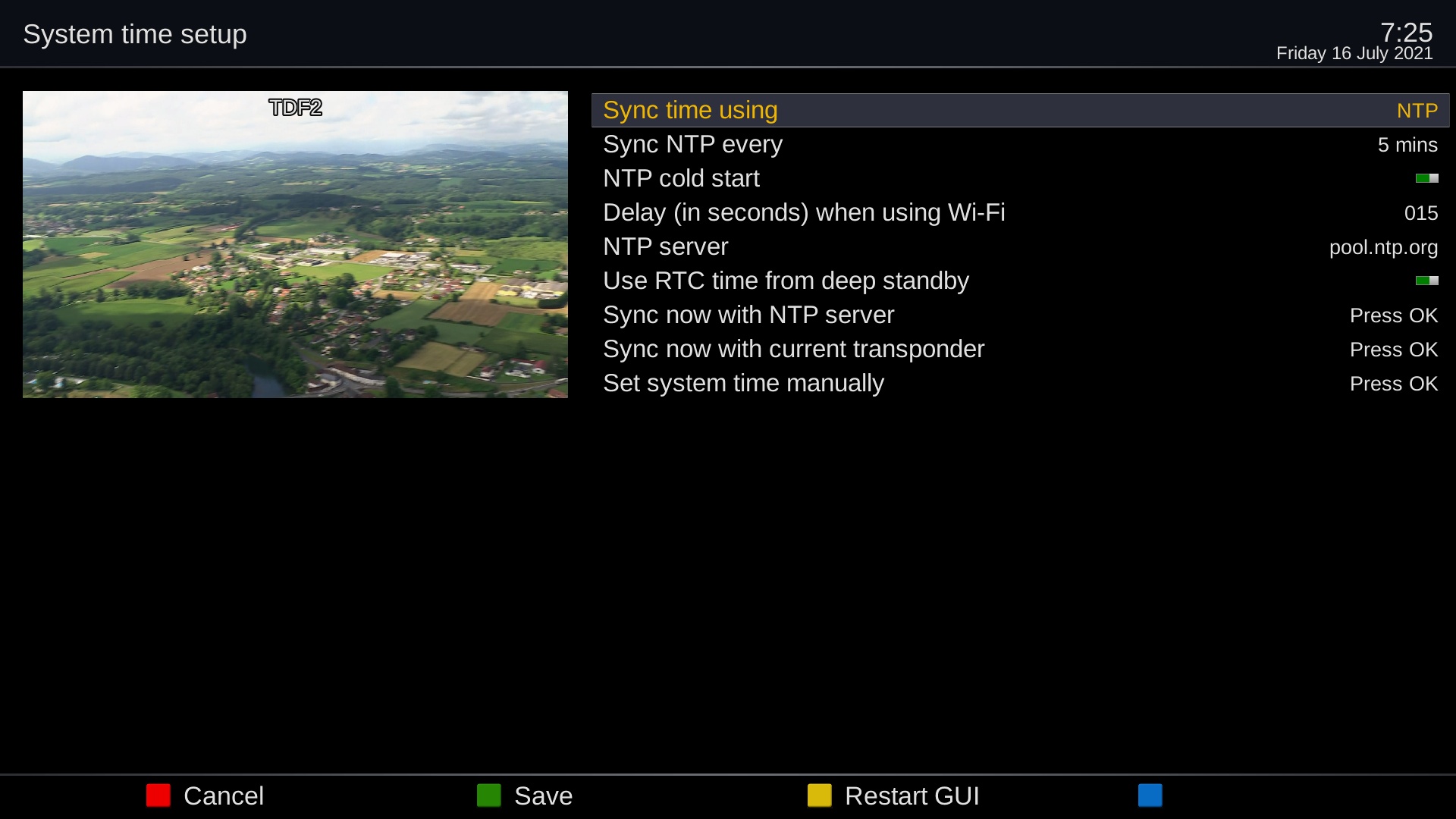

Well, I moved my dish to H&I channel on 101w. I then went into the menu and did a Restart. After the Restart, it automatically MOVED the dish to 99w, and brought up the Bars & Tone channel and synced time.
I then tried the same thing with it just in Standby. When I brought it out of Standby, it once again automatically MOVED the dish from 101w to 99w, and the Bars & Tone channel.
So, seems like this might work. Guess we'll have to leave it like this for now, and see what happens in the future. As long as it doesn't try to sync to NTP time, it shouldn't mess up for whatever reason that it was. Though I'm now wondering if setting a delay of 30 seconds or so to sync time with NTP, that would also work? I never tried that, because supposedly that's supposed to be for Wifi connected receivers, and mine is wired ethernet. Might be something else we could test, as maybe keeping the receiver in Standby is somehow a factor with it going crazy on NTP time sync?

Also turn OFF "NTP Cold Start", and make sure you hit the Green button for SAVE

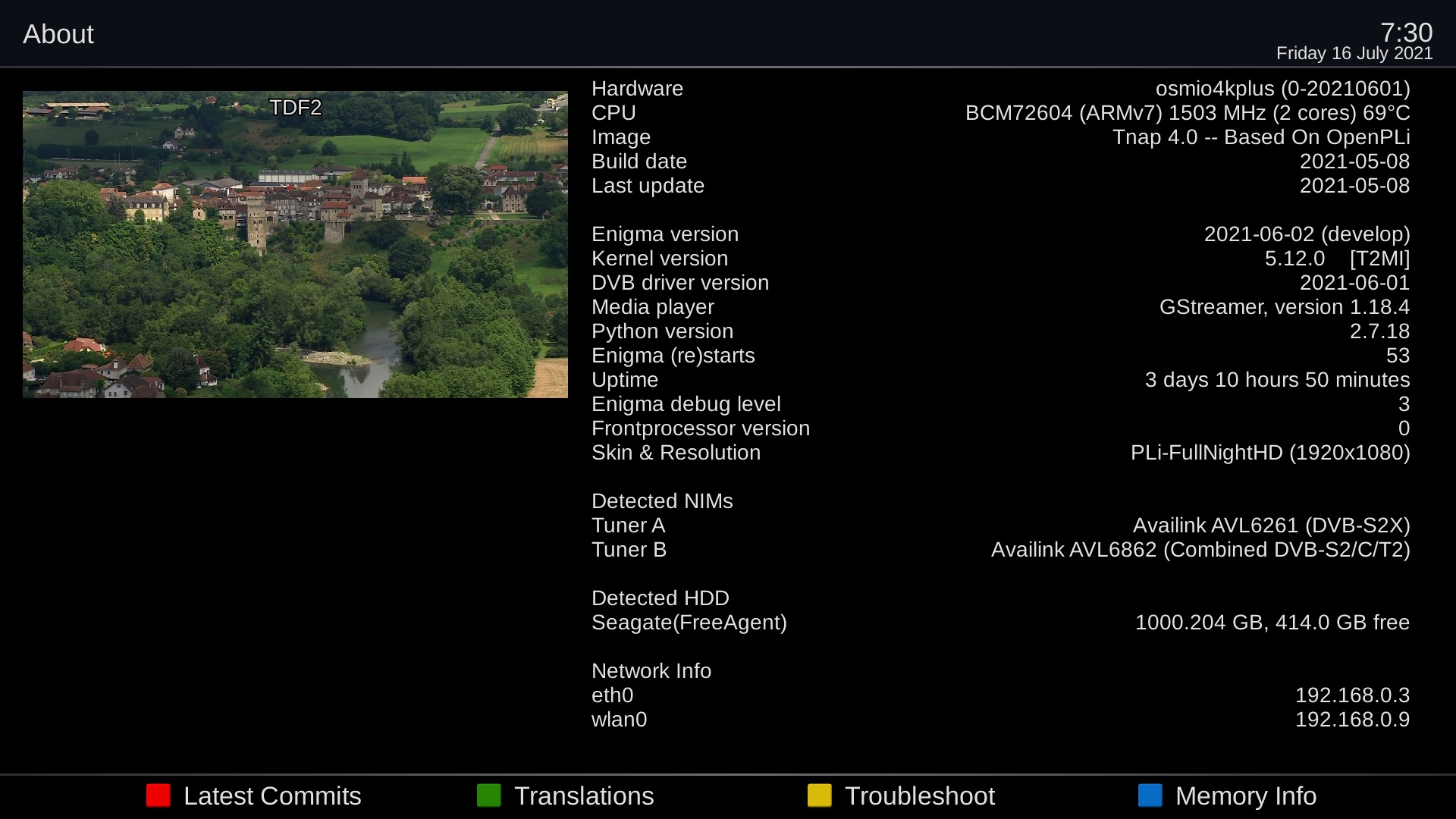

I've had time issues in past, but now my Mio+ is working perfectly. I am using TNAP 4.0 Build 2021-05-08, Enigma version 2021-06-02 Kernel 5.12.0 [T2MI]. The software update screen shows no further updates are available. I never turn off my receiver since turning it off in past had introduced time issues occasionally. I have my system time setup as shown below:

As long as you have an internet connection, then the clock sets at bootup. Also, make SURE you disable the time being set via Transponder. - I believe your images allow you to set that via the menu system. On my image, i had to manually edit the settings file within /etc/enigma2 folder. You can only modify the settings file when enigma2 isn't running. To turn off enigma2, telnet in and issue a Init 4 command. Then you can ftp into the box and modify the settings file and modify the transponder time setting. Then telnet into the box, and issue a reboot command.

Where did you get that one? Mine is 06/02/21 (develop) even after doing on online update. I don't see a 06/17/21 version, even at Legit?
It is a firmware upgrade via the osmio menu. Setup->Flash image.
AFN transponder seems to be keeping the clock close to being on target but it's not as accurate as NTP.

Far better than NTP time. It might be off around 5 seconds, but it beats it suddenly going to something random, at a year or months earlier.
