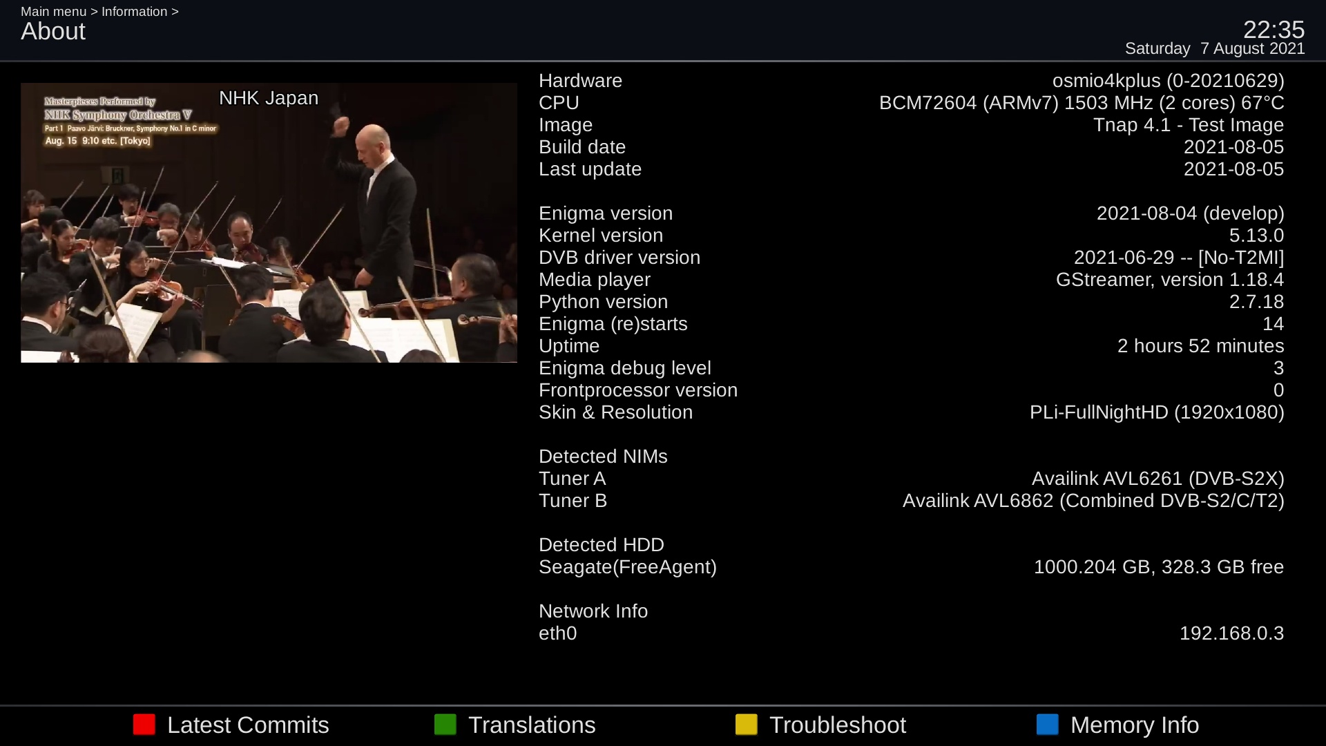

I installed the TNAP 4.1 test image today. I have switched my Mio+ to standby to see if it keeps accurate time. So far it's good.

I installed 4.1 on one of my mios but there isn't an option for "System time" anymore. In other words, there's no way to sync the time. There was a plugin for systemtime but the box wouldn't let me install it - error message was that there was already a systemtime plugin installed. I couldn't find that systemtime plugin so I wasn't able to remove it.

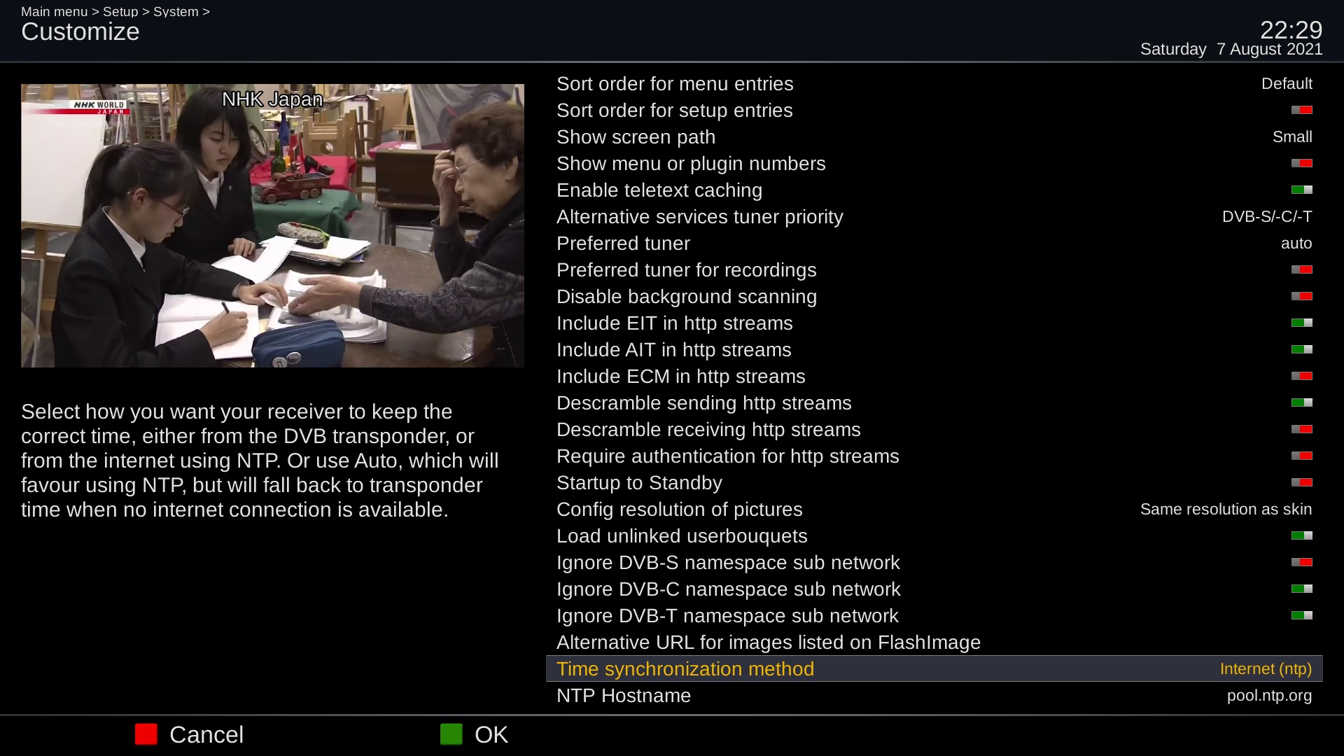

There is no longer a System Time menu. In Setup>System>Customize, there is a Time synchronization method parameter where you can choose Auto, Transponder Time or Internet (NTP). You can also set the NTP hostname. So if the time goes wrong, you must restart the receiver to get a time update.

Doesn't exist on my box.
Latest here is the clock went wrong again. When I turned on the receiver, the date was December 31, 1969. So for now, I am going to leave the receiver turned on continuously.
cyberham Can you give us a screenshot of that page, so we can see the settings?
There's no SYNC button, or sync at a time interval? That sucks, because that means you'd have to reboot to grab time, or wait for it to sync itself whenever.
