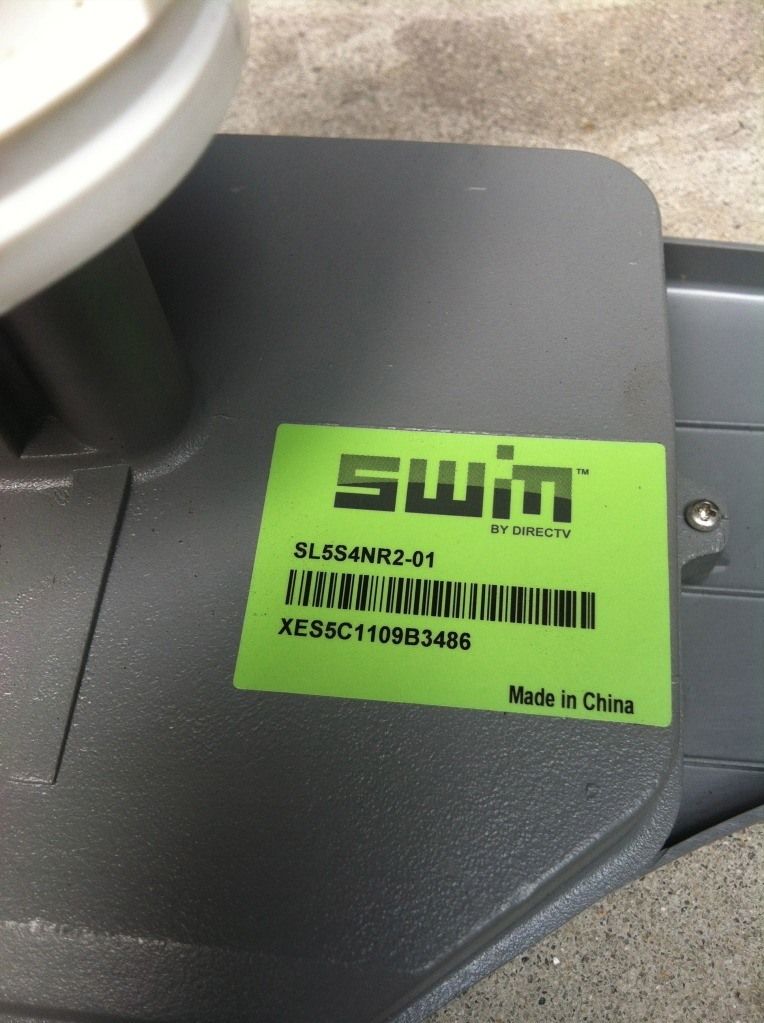

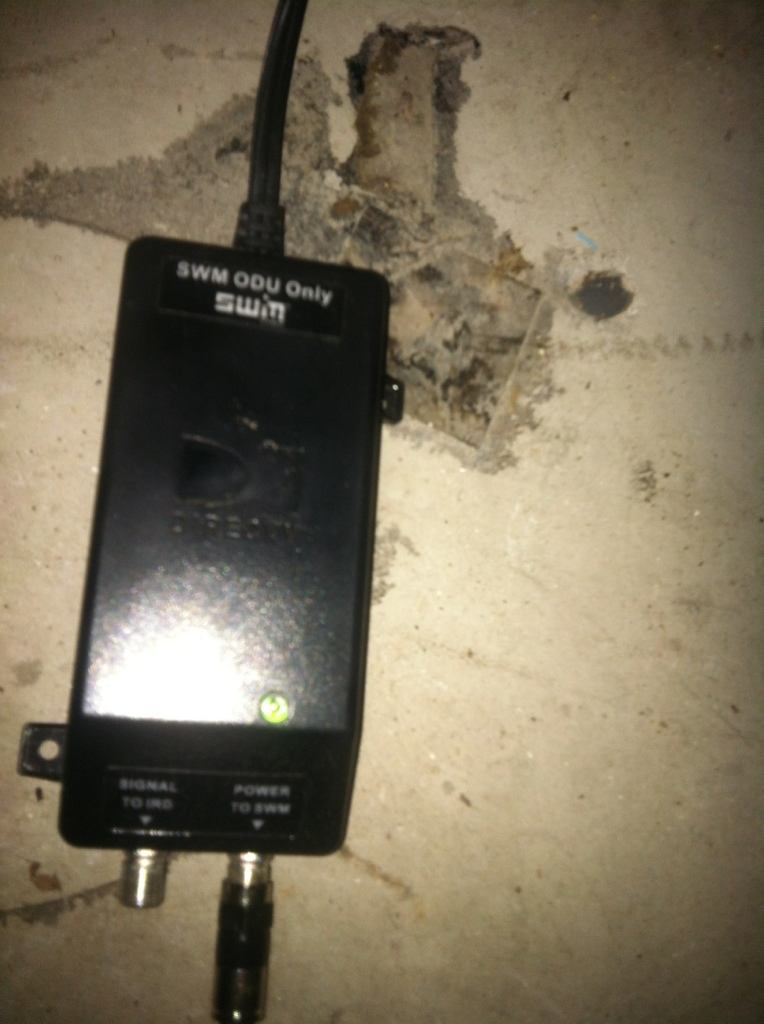

I am using an HD23-600 receiver and a slimline dish with the green SWM sticker on it. I normally use this receiver in my bedroom and it's part of my whole home DVR (the box is just HD, not HD DVR). Do I need to purchase one of the black SWM boxes, a power inserter, etc.? I'll try to include pics of the LNB and SWM I have at home (it's in my garage where I currently do not have a receiver). Any help would be much appreciated.

Please forgive my tech ignorance, but what type of LNB is in the picture I posted?

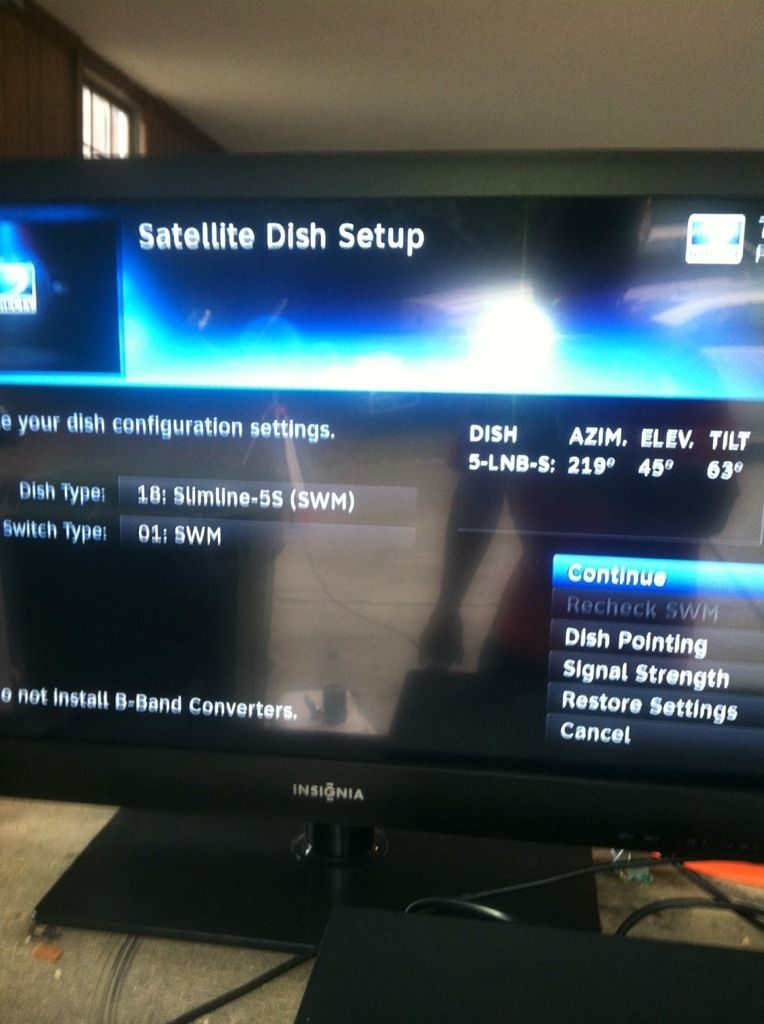

I talked to three different DirecTV techs yesterday and they all seemed to think the problem was my receiver is on a SWM system at home but I don't have the black SWM box at my tailgate. When we'd try to change the dish setup in the internal settings to a 02: Multi Line Switch, the receiver would not recognize it and was reverting back to dish type 18.

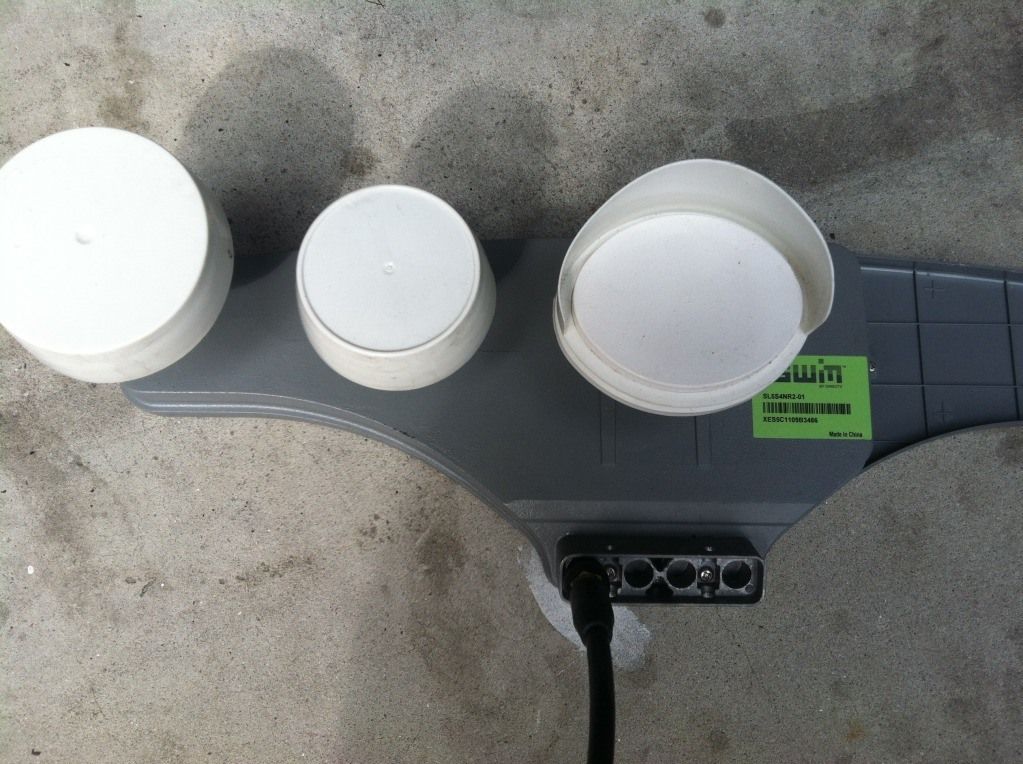

I also have access to a non SWM Slimline that has three LNBs. You mentioned above that I could use that but it would require two lines running to the receiver. My receiver only has a hookup for one line.

that is a SWM setup....a SWM5 to be exact
picks up 99,101,103,110,119
110 has nothing on it
119 has some locals in SD
I thought you had a DVR.....you only need one line from the LNB to the receiver with what you have
If you are using a swm lnb, then you have to have the power inserter. Not using it could damage the H23, so make sure you use one. You need the 21 volt type.
I appreciate the responses. If I'm understanding the two of you correctly, all I need to get is a 21v power inserter and that should allow my receiver to recognize the dish when I'm using it away from the house. Is there any other equipment I need? If I get the power inserter, should I leave the dish selection as type 18 as it is in my home setup in the picture or change it to something else?
If you have the same type of lnb, either a 3 or 5, then you should use the same dish selection as your home setup. If not, find the right one and choose it instead.
