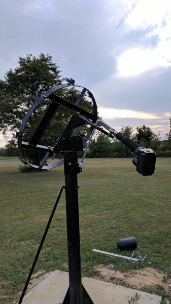

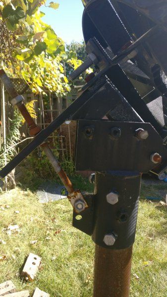

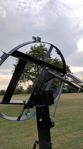

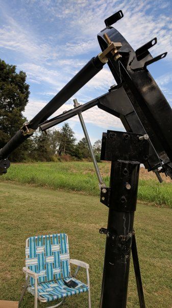

Need help is this dish upside down

Doesn't appear to be.

it's the declination offset that I'm worrying about

Ok, from looking at the pictures, it appears that you have the declination pieces on the lower part of the assembly. You also have the pivot point for elevation in the wrong place. It goes through the holes lower and towards the front (satellite side) of the mount. The declination portion is the two (2) angle iron pieces you used on the bottom. They need to go on the top and have a bolt through them with three (3) nuts on the bolt. Two (2) in between the angle iron and one (1) on the end as normal.

Yeah I been reading through that 100 times, I'll look at that tomorrow. But I try to put one of the them on the to and the holes were not the same size and the other one was. So it fits as is but it's not right. Thanks

What you are saying make sense,I'm just worrying about the hardware on the bottom

Too expand on what bpalone said earlier: After saving kool1's 2nd picture and blowing it up... Is that the declination bolt at the bottom? The bolt that's attaching the 2 brackets. Maybe it is just screwed up so far that the full length doesn't show.
At worst, the only parts missing are a suitable long bolt and a couple of nuts. (Once everything is assembled correctly)

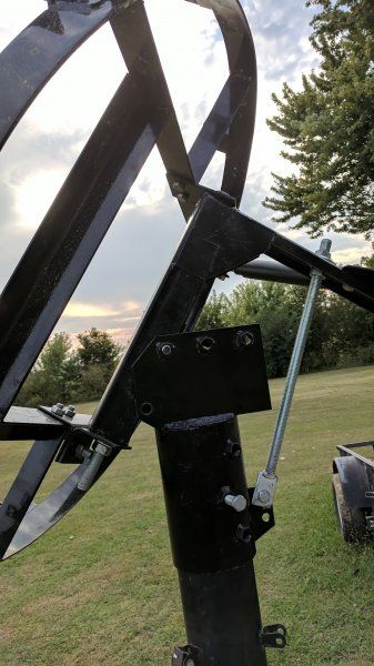

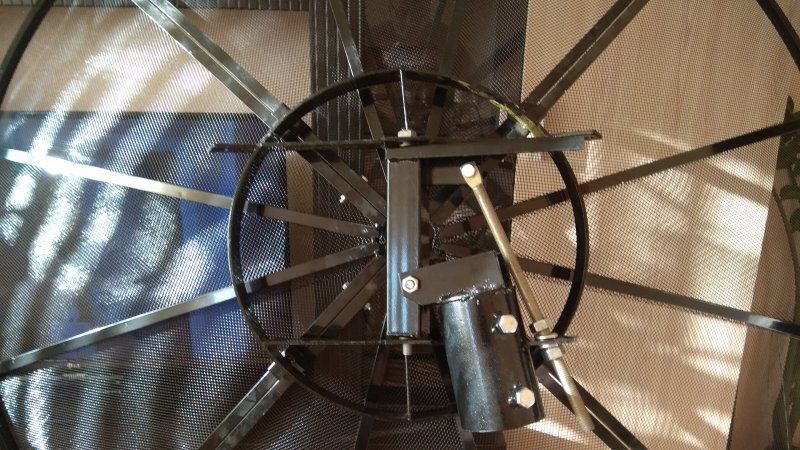

I think what you are showing is a non polar mount. I could be wrong.
See pic 2, this is an older tek2000 6ft dish, has a polar mount

See pic 1, this is the "new" tek2000 6ft dish, has a different mount with no declamation adjuster
