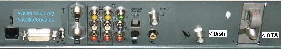

Because there is something happening in the fourth STB. Folks are asking you questions to try and help you trouble shoot it without being able to come to your house. If the same cable coming form the antenna is giving you a signal on your D* STB's but not on Voom then there is definitely a problem with the Voom STB's OTA tuner. If you have two cables coming in from outside, one for SAT and one for OTA and the OTA cable is connected to the port labled OTA in the picture below then the OTA module is broken and needs to be swapped out. Either way, diplexor or no diplexor, it sounds like you received a bad OTA module in your Voom STB.
EDIT: If it is a bad OTA module you will have to call Voom and tell them that is the problem and request a service (I know service is kind of a poor choice of words) call to have it replaced. Just make sure that you have them annotate on the work order that the OTA module needs to be replaced so that the tech knows to bring one. Once scheduled call the installer to make sure they know to bring it.

Since the antennas appear to be working properly and the STB is mapped to DMA 083 (Huntsville), it can only be the following. Oh, you may wish to check the system settings hardware menu to ensure it is correctly mapped to DMA 083.
1. Bad 8-VSB module
2. Installer did not install the 8-VSB module
3. Installer plugged in the antenna to the RF port (see wasch_24's pic)
4. Perhaps 2 & 3
