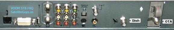

He had the OTA cable connected to the wrong coax input on the STB, look at the photos in posts #30 and #43. If you have a diplexor, only one cable going to the STB, yours will have a little box covering the two inputs. Loo at the STB FAQ's for more info on the connections.

correction............I didn't, the installer did. I can see how, there is nothing on the back that says input/output, just little stick drawings that really don't look like much other than the Sat drawing. The "OTA in" looks like a power pole, not a antenna. I tired that Horizontal and Vertical settings under video output, no change. Tried them all, from 0 to -15. As I said before, when the installer was doing something I saw a different screen that I can't access now??????????????????

Everything has been checked and double checked..LOLOLOLOLOLLMAO!!!!!! Loser! You have been rude to Sean and everyone else in this thread. And there are acutal STB rear panel pictures here in this forum, you could have just looked it up! BUT NOOOOOOO! You'd rather slam those trying to help your lame ass!
