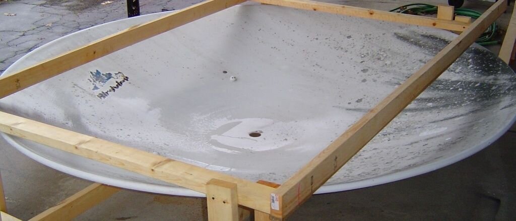

I found a partial sprayer bottle of Krud Kutter under the sink, but couldn't remember the strength I had mixed it at, but took it out and sprayed the bad spots on the dish with it soaking it thoroughly and let it set a full half hour.
I then found a smaller brush with stiffer bristles and mixed up my cleaner I used yesterday substituting the dish liquids with Tide liquid.
About 30 minutes later, I had the dish clean to my satisfaction.

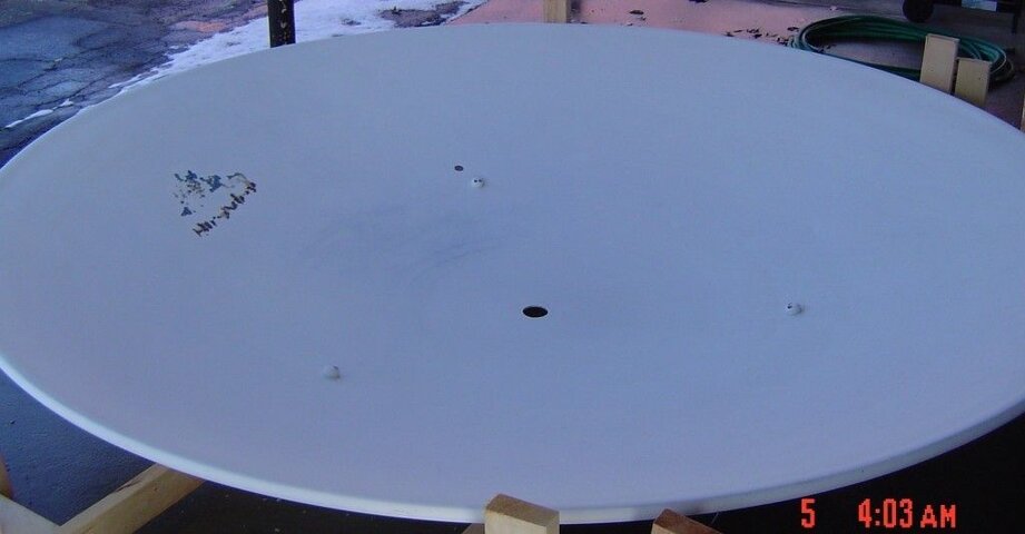

Here are the before and after pics:
Looks like a new dish almost. Paint is getting a little thin in a couple of places, but other than that, she's beautiful. :cool:
View attachment 22513 View attachment 22514

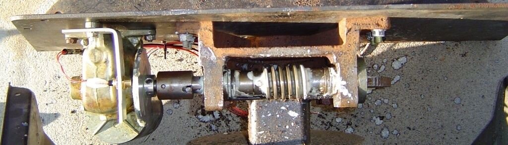

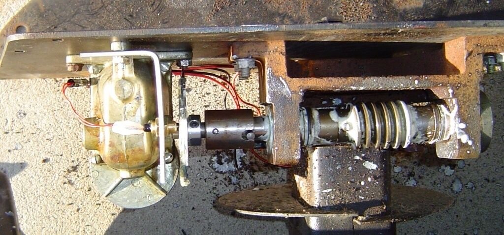

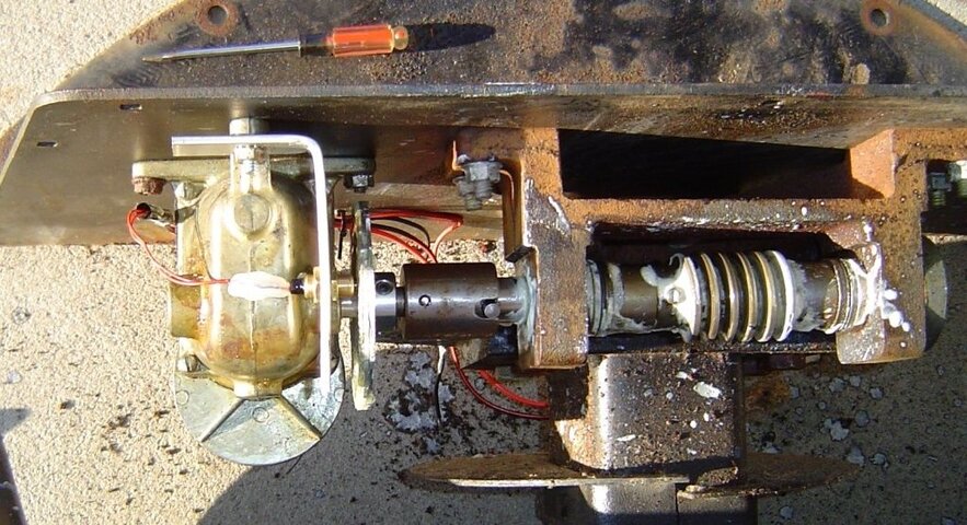

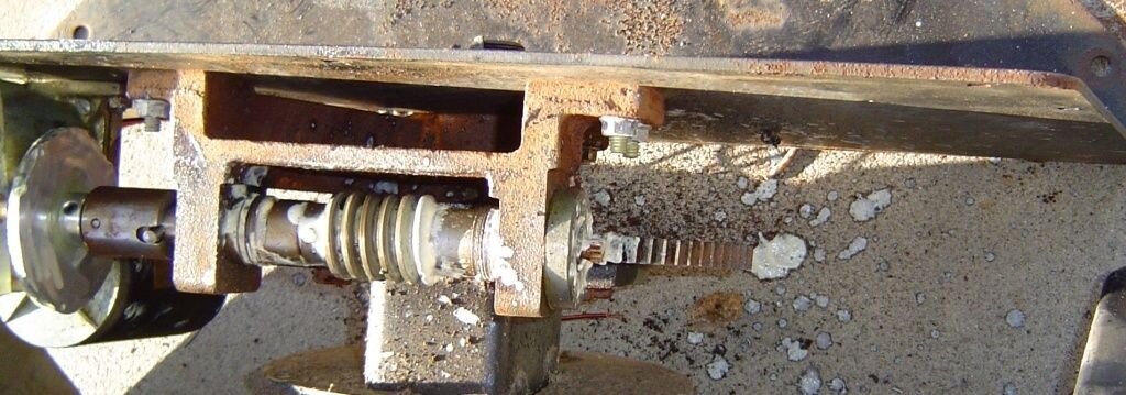

And here is the mount all cleaned and re-assembled with the motor and reed sensor conversion kit in place.
One thing to note for those of you who ever get a Birdview. You see the wires running through the little wire tie between the magnet wheel and the worm gear housing. That was put there by design to run the wire through to keep them between the flat side of the dish and the big gear so they don't get caught and chewed up.
The pictures show what a difference there is after cleaning up the rust and putting on some grease.
View attachment 22864 View attachment 22865 View attachment 22866 View attachment 22867

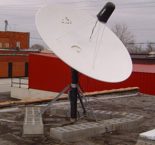

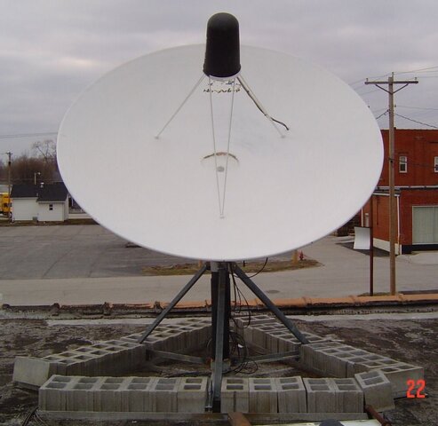

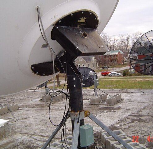

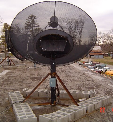

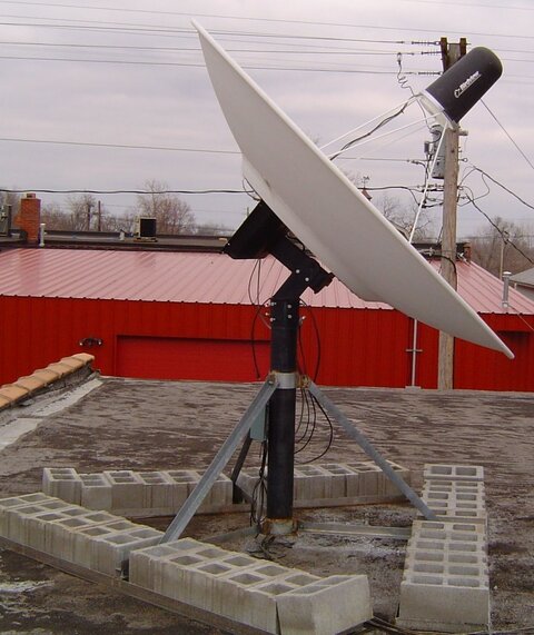

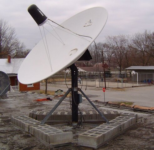

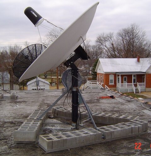

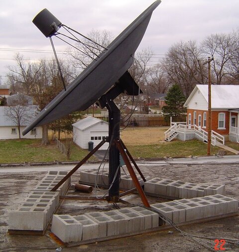

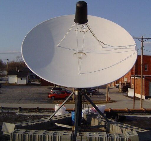

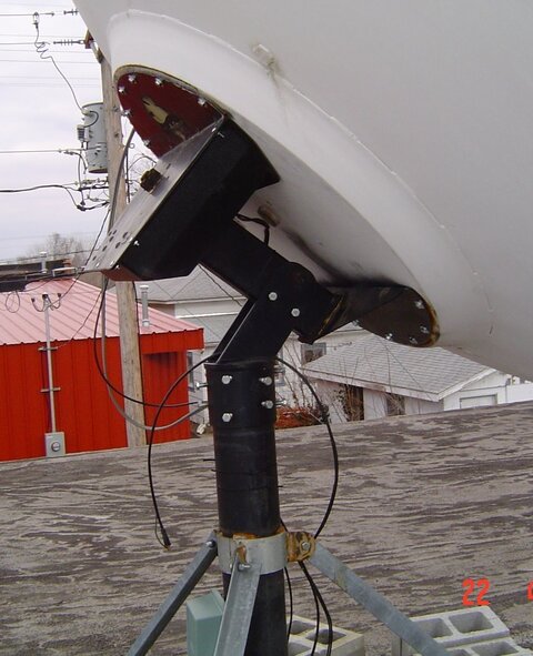

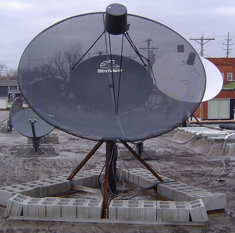

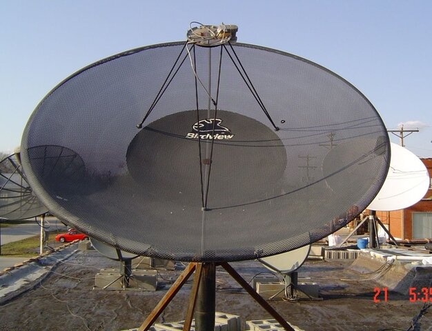

Both dishes in place, hooked up and functioning. Both are performing well already, but I plan to start fine-tuning tomorrow on the solid first, then the perfed.
Part of the reasoning for moving the perfed dish was because I was going to changed out the mast anyway, and that position has the best LOS.
Take a look at the collars around the 6 inch mast for the solid dish. The former mast there was 5-5/8" and was giving me some problems with cap movement. I now have that cured on both masts using the original 6" pipes and the bolt that comes down through the top.
Here are the pics. Two of them were taken on Friday when I was tired. My son took them. I took the others yesterday.
solid-mount-left-rear.jpg solid-mount-left-rear-close.jpg solid-mount-rrear.jpg solid-right-front.jpg
