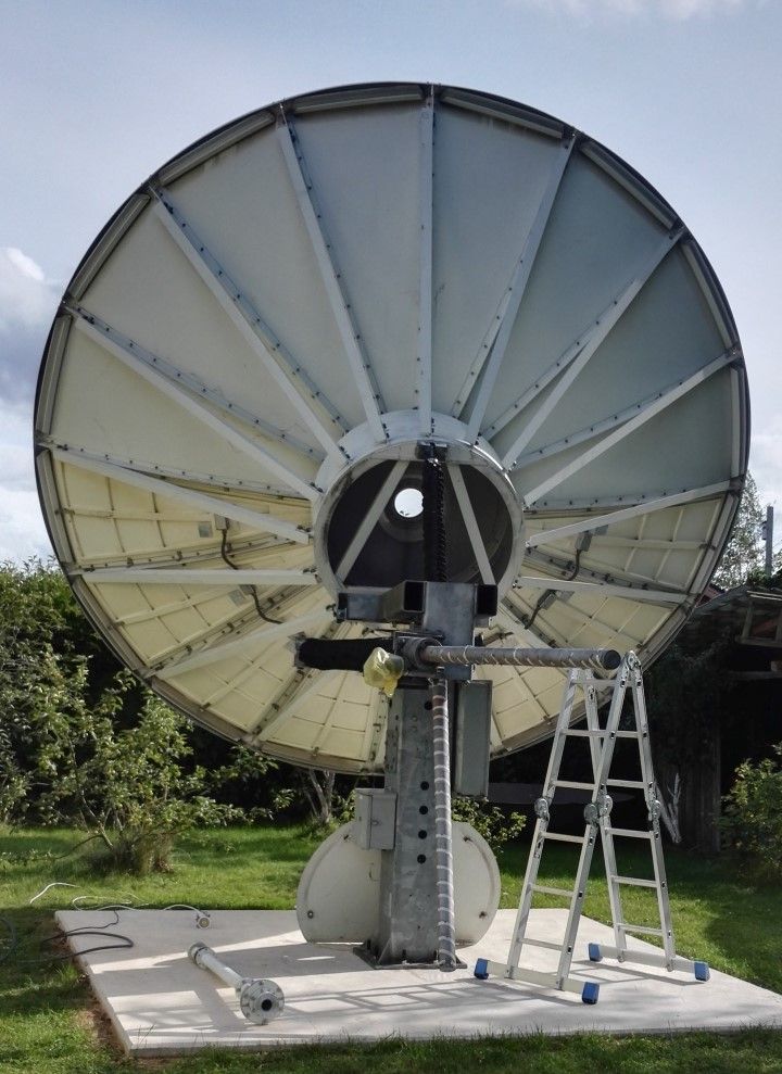

Have installed 8 heaters to lower part of the dish. They consume a lot of energy when operated, so, I doubt I will turn them on. But it is better to keep them on the dish instead of them making a mess in the garage :bounce

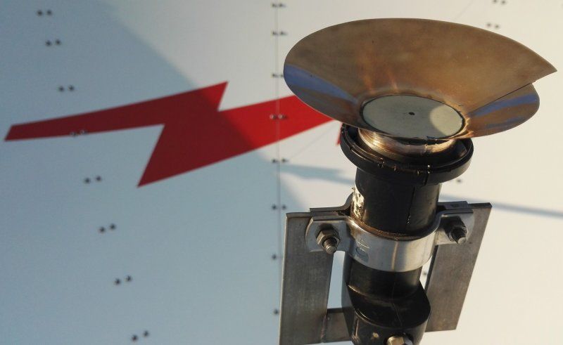

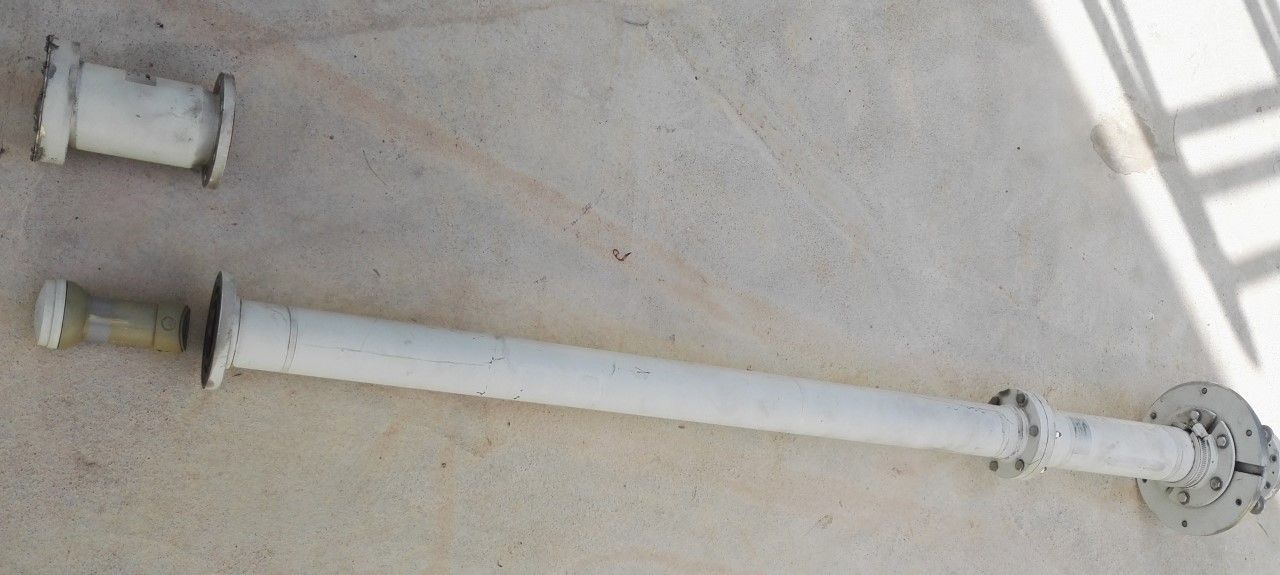

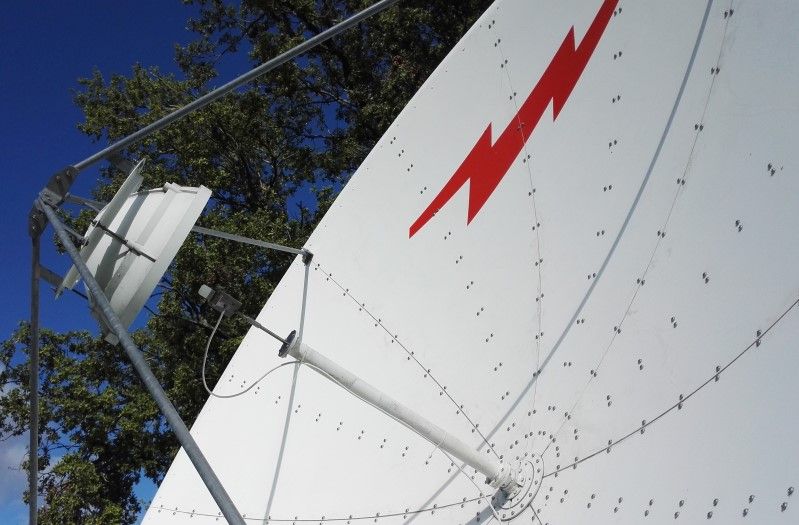

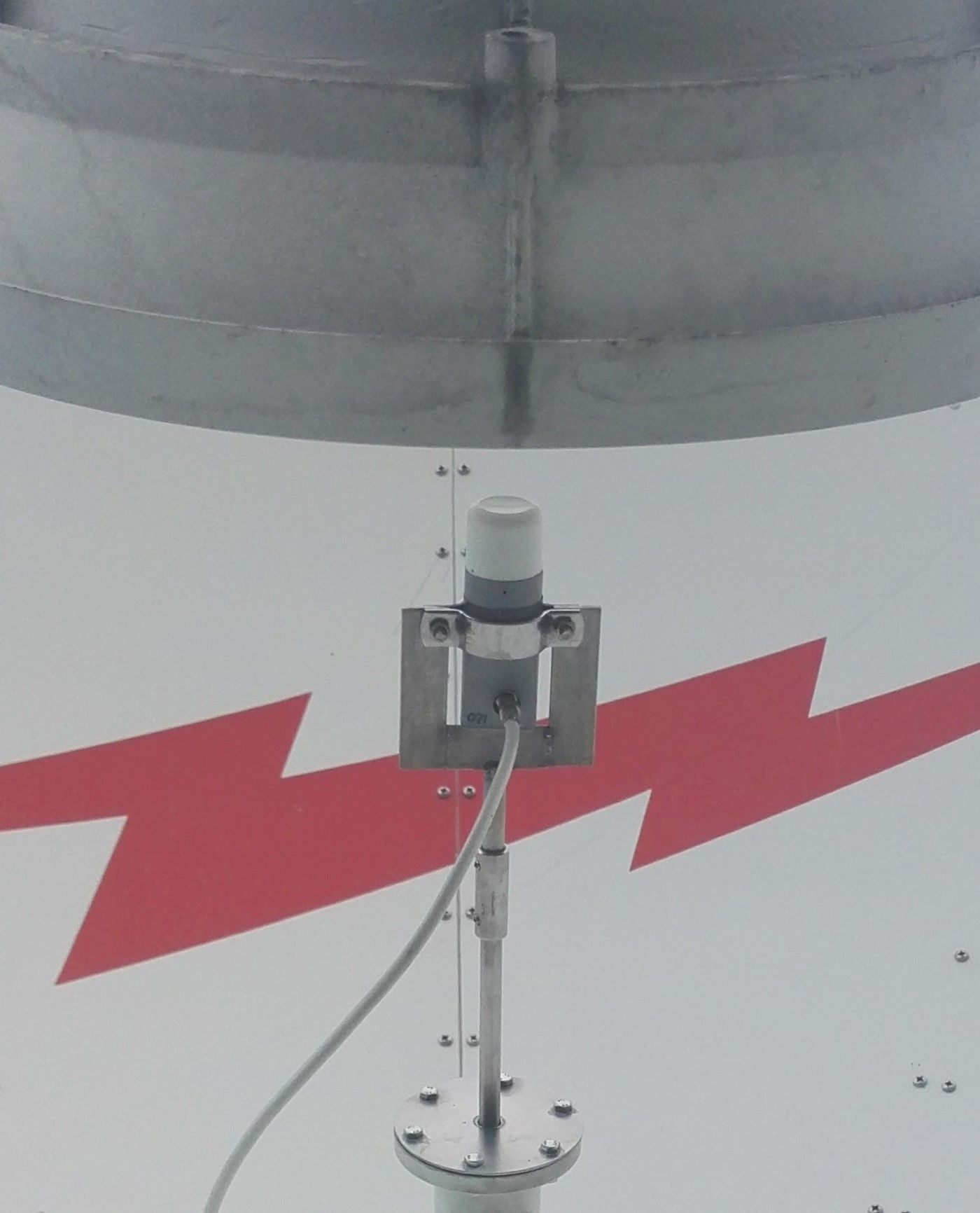

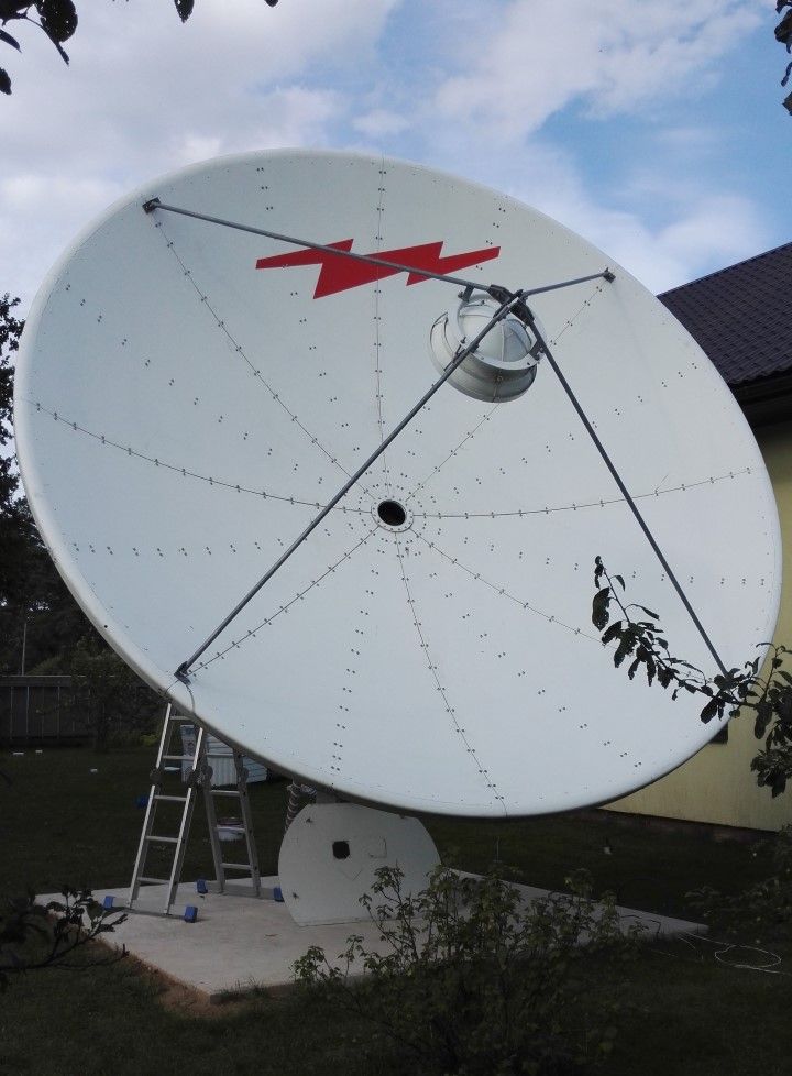

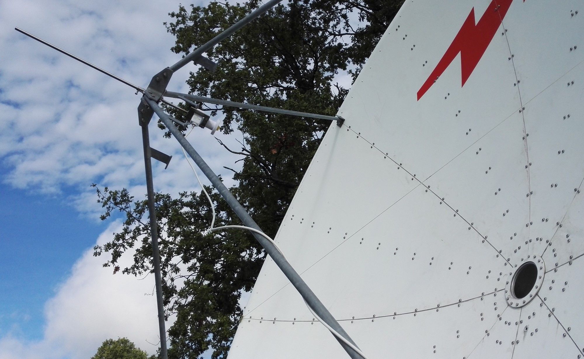

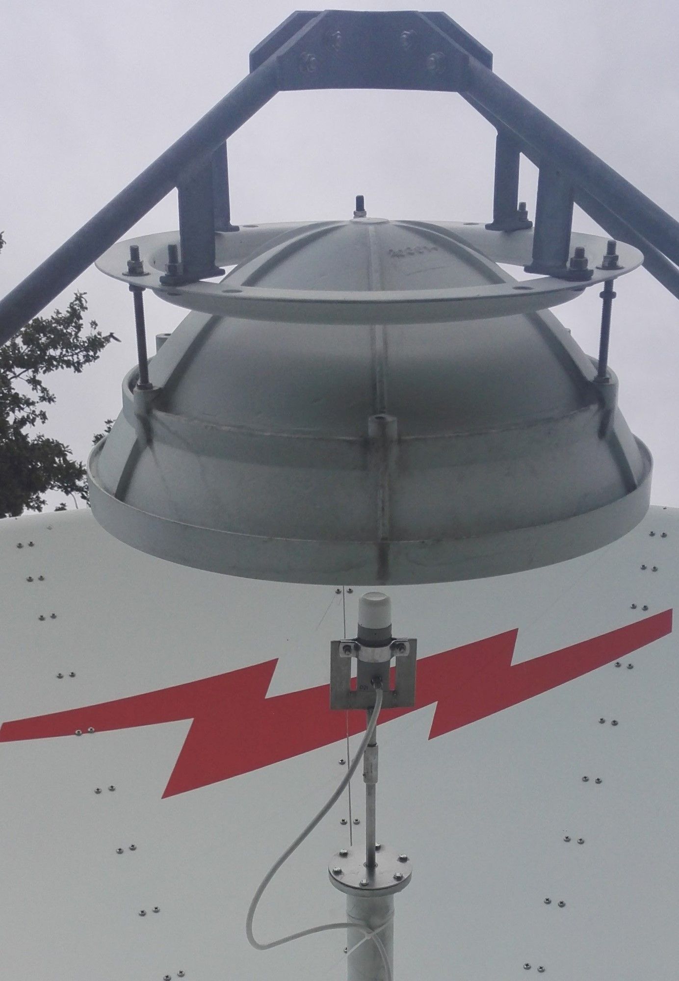

Also attached subreflector. Will use original waveguide as a feedarm where LNB be installed instead of C-band feedhorn.

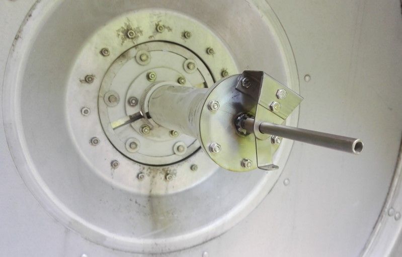

Made this tunable device. Now I can change position of the LNB closer/further from the SUB and also Skew without going in front of the dish and obstructing signal. Later I might conciser to make LNB skewing mechanism inside the drum.

Can I get some more pics of how you have the LNBF set?

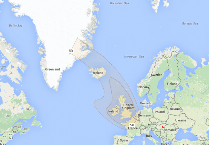

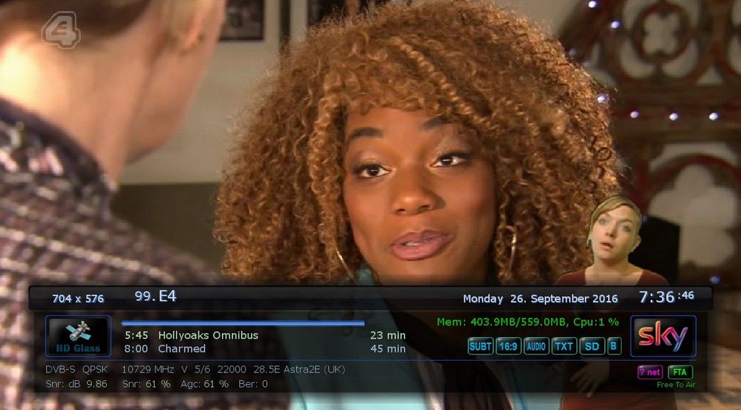

O, yes, I do. I did not hear that somebody in the region can receive signals from 28,5*E spot-beam. ScreenHunter_64 Sep. 26 07.33.jpg ScreenHunter_65 Sep. 26 07.37.jpg

I initially installed LNB without the SUB IMG_20160805_092118 (Custom).jpg , but it was not so convenient to do adjustments when you are always between antenna and satellite and it was pretty high above the ground. Side-lobes were huge. According to theory, Gregory systems performing up to 10% better than simple ones, but I can not clearly prove it. And Gregory also better eliminates effects of X-pol..... this I also can not prove.

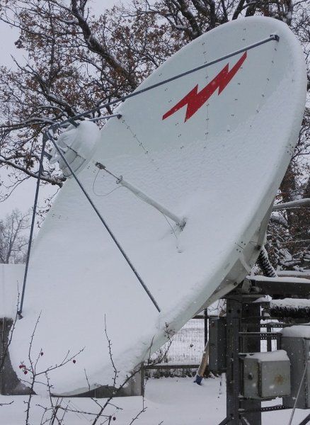

No, it is still fixed and pointed to 28,5*E, as I did not install and powered motors. However, I lost all channels from UK beam because of the snow. Yes, antenna has integrated heaters, but I did not connected them yet. But I do not care, I do not need this antenna for watching TV, it is just for fun.

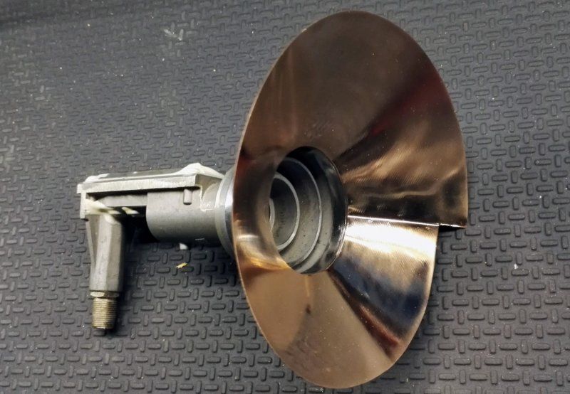

Nice feedhorn adaptation! Kind of looks like a feed horn I made for 10GHz, just used an old tin flashlight body and made a cone like that instead of a scaler. Worked not too bad but lots of room for improvment (at least in my RF engineering!)

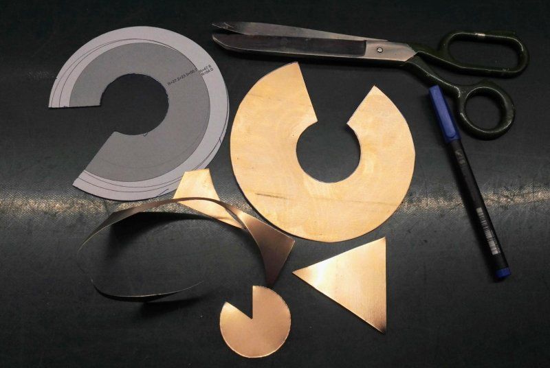

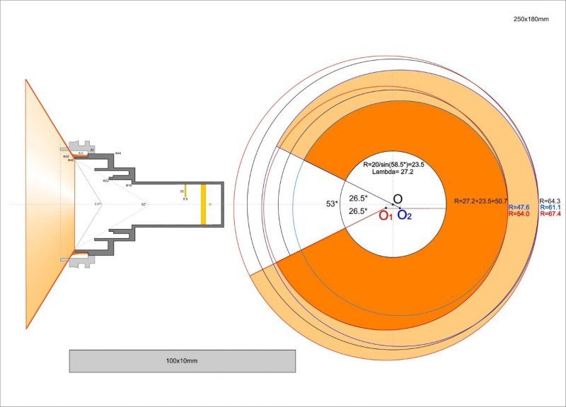

Friend of mine, after seeing my feedhorn, said that I was probably drunk when I made it :confused:. But, in reality, this shape of the feedhorn was designed this way. Calculations and drawing, specific to my antenna, were made by another friend of mine. There are some more pictures of the process. feedhorn_imagesia-com_1f5x2 (Large).jpg IMG_20170927_120950 (Large).jpg IMG_20170927_130140 (Large).jpg IMG_20170927_173411 (Large).jpg

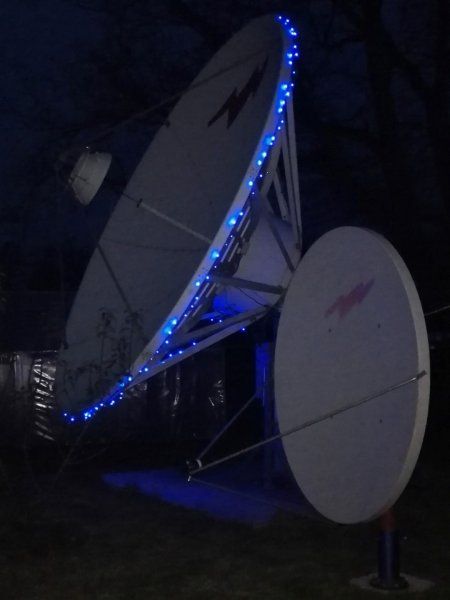

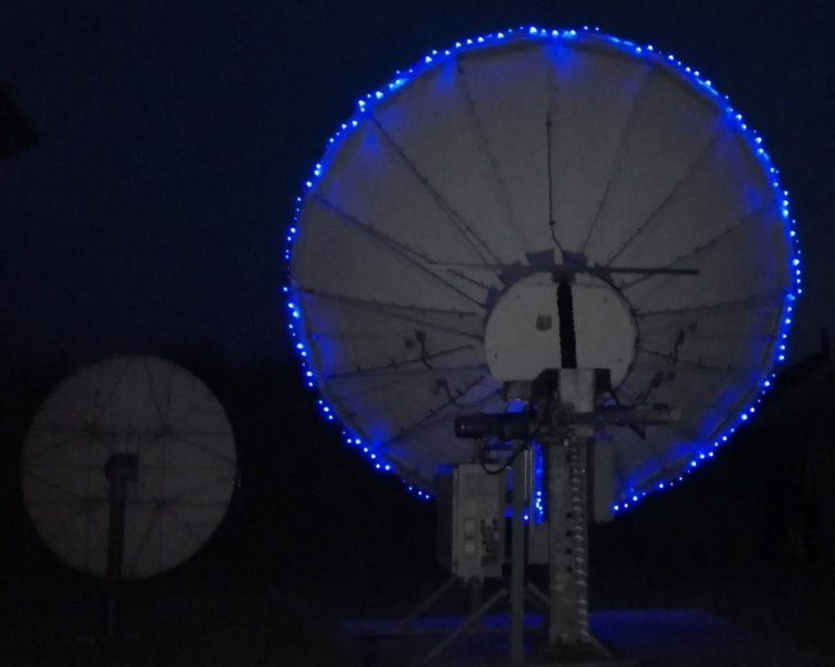

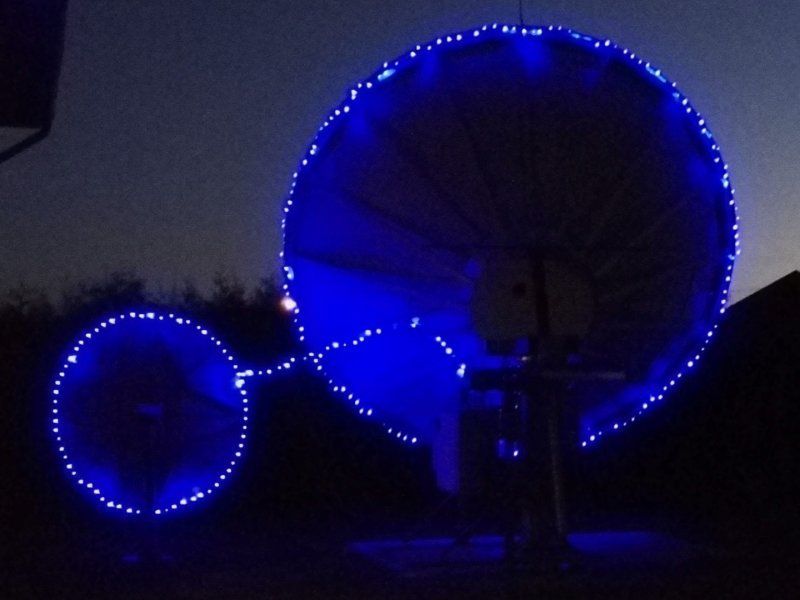

Couple of days ago added more lights to the site IMG_20171107_172635 (Large).jpg
