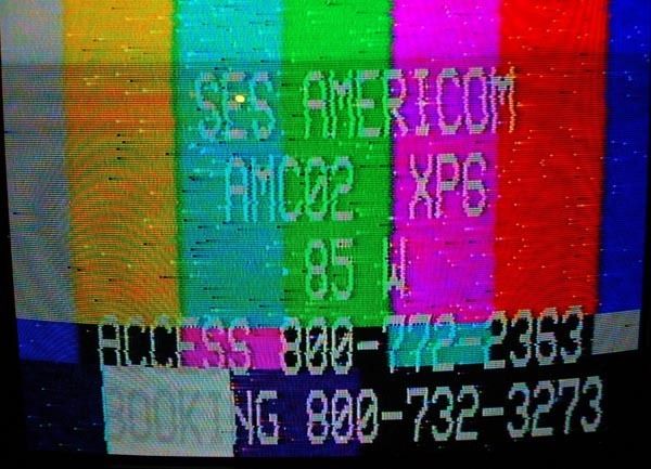

Well, a qualified success! Got the AMC 2 test card. The hitch is I got it while in "KU" mode with no sat selected but on channel 18 on the Uniden display! Anyone know why?

I can only get KU band right now-I don't have the C Band dish yet. I am just running out of my KU FTA setup to the fortec with the Uniden slaved off that. I plan to do extensive testing to get this all figured out sooner or later. Right now, all I have picked up is the test card from AMC 2. There doesn't seem to be alot of KU analog or I don't have it setup right.
cool (just as fuzzy as mine) :)
I think once you get a satellite setup and the frequencies put in, everything will fall into place. There are frequencies in there but sometimes they can be off. Using my Supra as an example, the frequency was off by a lot so Channel 8 as an example was at 19
A couple of issues. I finally have a KU sat progranmmed in now (I was right-there were none for whatever reason). I just used the first one in the list (A1) since none of them sound familiar at all. Now the AMC 2 card is on channel 17. Am I going to be able to tune KU this way? I don't see anythng about changing frequencies in the menu. The TPs go from 1 to 32.
