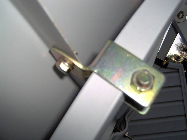

uh oh....problem
the gold pieces go between the pieces of the dish
edit: my bad. Just went outside and looked. They go on one side of a bolt
so the screw on the 2nd to inside bolt (the one 2nd from the center) goes
nut/piece/piece/gold bracket/bolt

Thanks for the info-much appreciated! I might have to back a few bolts out that I shouldn't have put in but not a big deal. Appreciate the pic too-I printed it out as I did much of the stuff on Sadoun's site.
