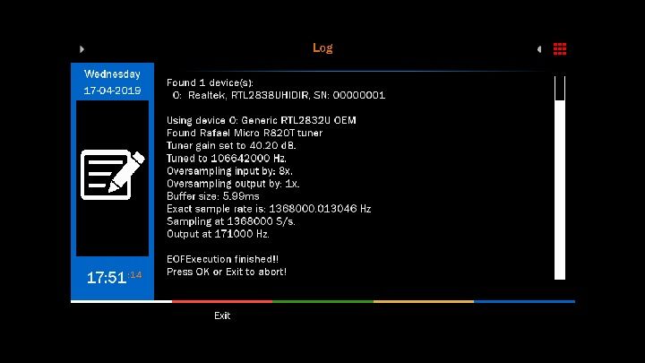

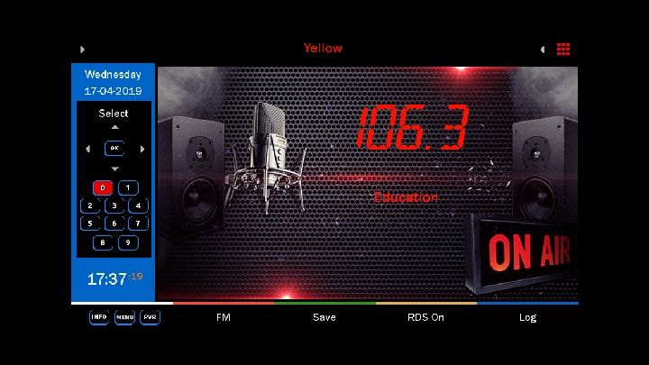

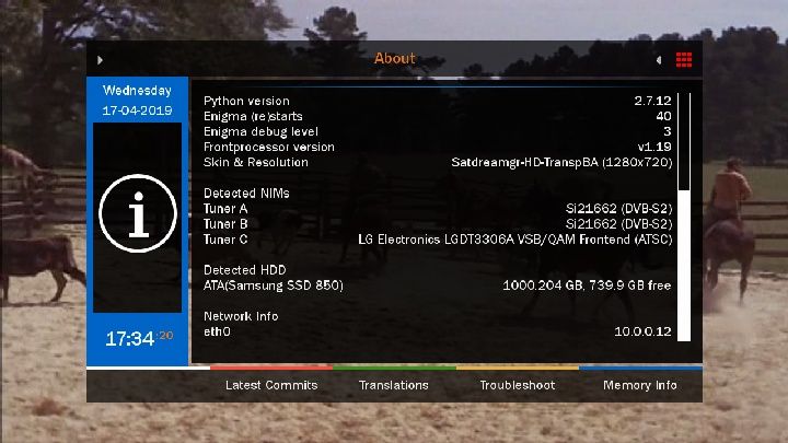

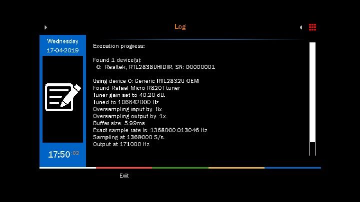

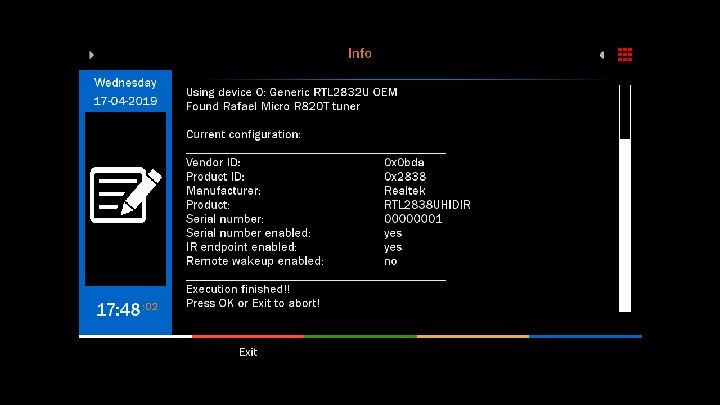

TNAP image to play with. I'm using an Octagon sf4008 with the SatDreamGR 6 image, after seeing Brian's screenshots I can see the TNAP image is more loaded than the SatDreamGR 6 image? So far I've only been able to listen to FM local stations. Here are some screenshots from the sf4008:
Plugins page
FM with RDS On
FM with RDS Off

Info page
Log page
Hope this is some use to anyone..!!!!

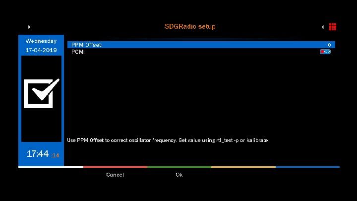

Press Menu to enter settings screen, Green to save settings.
The 6th screenshot in my above post, is my MENU page. As you can see it's very different from yours? Basically there is nothing to save, or change really?

Thanks for the screenshots. Is that 1TB solid state drive internally mounted or do you have to hang it off the back?
