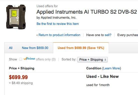

I looked and found ONE used meter on Amazon but it's AS IS and there are no photos of it at all, no description of it's condition other than "Used - Like New".... Ha...
I saw some photos on Craigslist of some Superbuddy 29 meters that people listed as "Perfect condition" and "Like New" and they were beat all to hell. It looks like they dragged them behind their truck to and from work every day.
The condition of them was horrible and there is no way I would buy them even at a massive 80% price break.
I'm totally put off by the Amazon deal not having any photos at all and zero description. The seller is not even an established seller, it says "Just Launched" and there's zero feedback.
Yeah, I could take a huge gamble to try and save $150 but I'm not comfortable with that so I would rather just go ahead and buy a brand new one that's untouched in a sealed box with a warranty.

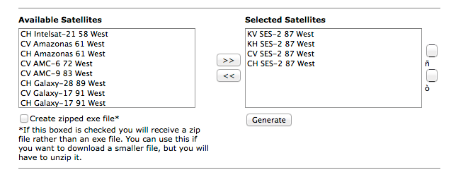

As for the Birdog, I tried to program it but you have to use their clunky, ancient website utility.
It only has 16 slots. Actually it has 32 but if you put an entry for each polarity then it's 16.
And even worse, for instance, the SES birds, it takes FOUR entries for each satellite to cover C and KU.
For the two birds I have to use eight slots in the memory.
And what's more, I have no clue if their configurations you download from them are current.
It does not tell you if you're downloading something that's 10 years old or 10 minutes old.
And we all know how they love to change stuff up on satellites, frequently. :(

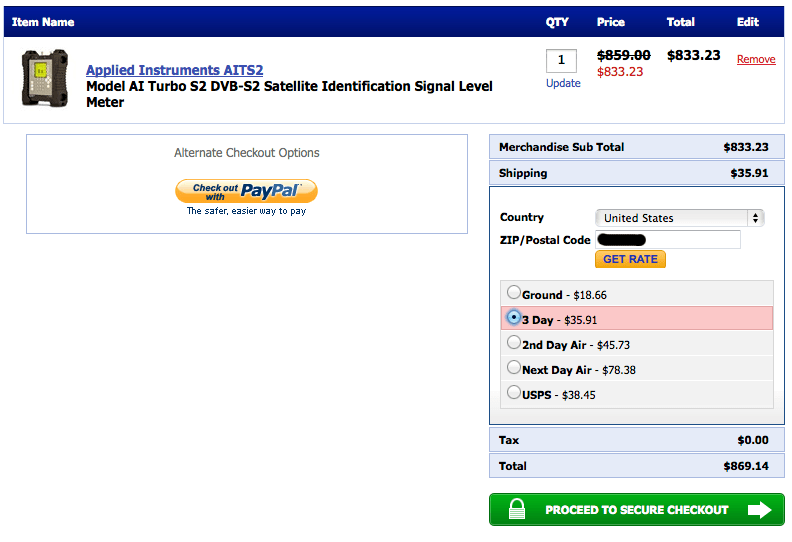

It looks like this is going to be my best deal. It's a few $$ which is very helpful, no tax but the shipping is a bit more than I like.
It looks like it's United Package Smashers which I don't like. I would rather go with FedEx which I've had very good luck with.
I don't want the cheap ground shipping because that takes f-o-r-e-v-e-r.
UPS crushes and beats the cr*p out of everything. FedEx delivers in the morning, UPS delivers laaaaaaate in the evening.
But apparently you can't choose who you want them to ship through. I'm going to keep looking for a better deal or one that's close to this
but lets me pick the shipper. If I can get it delivered for under $900 that would be excellent.

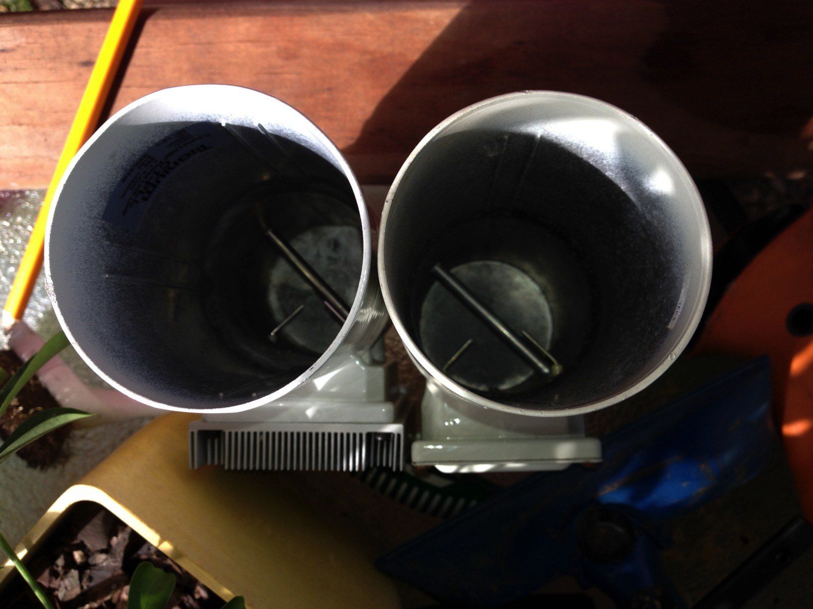

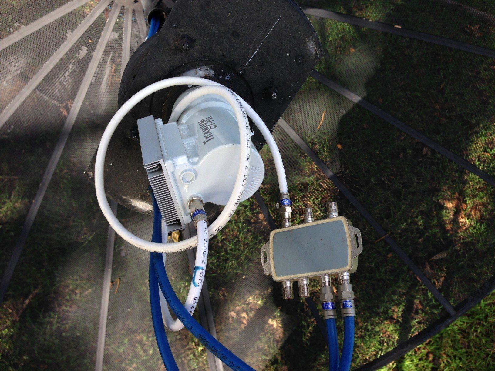

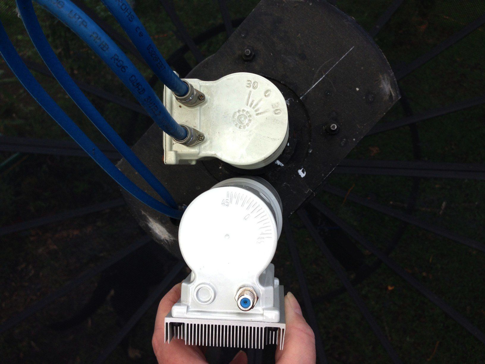

Ok, so yesterday I finally decided it was time to switch out the LNBF on my 10' dish with a new C1PLL I've had since the winter.
I bought two of them before it was ever announced that they would one day have a C2PLL.
Since I have the intention of having two C band dishes aimed at SES-1 and SES-2 and that each would stay parked there and that each one would be dedicated to just one network per dish, I wasn't too worried about limitations of having single polarity dishes.

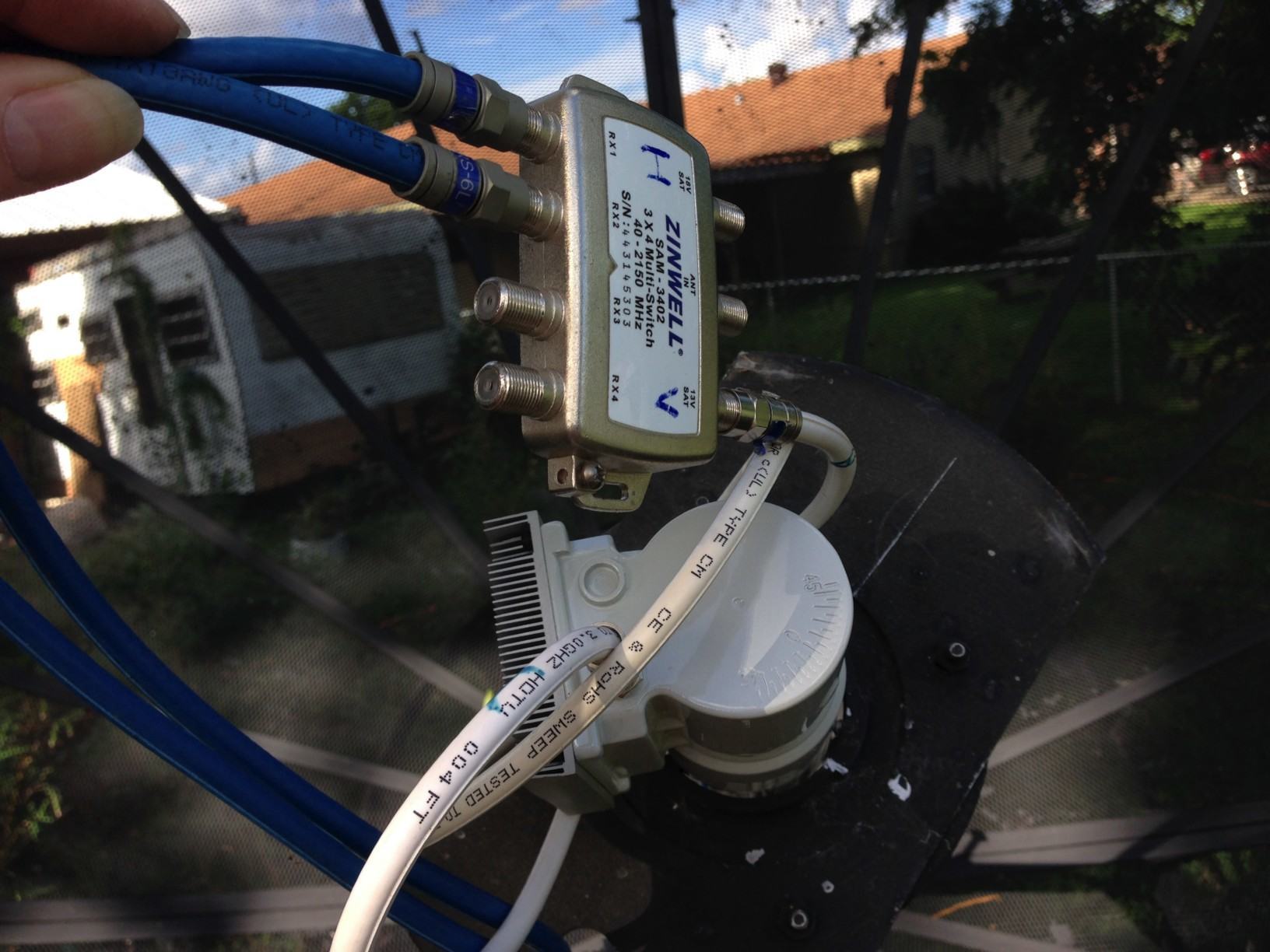

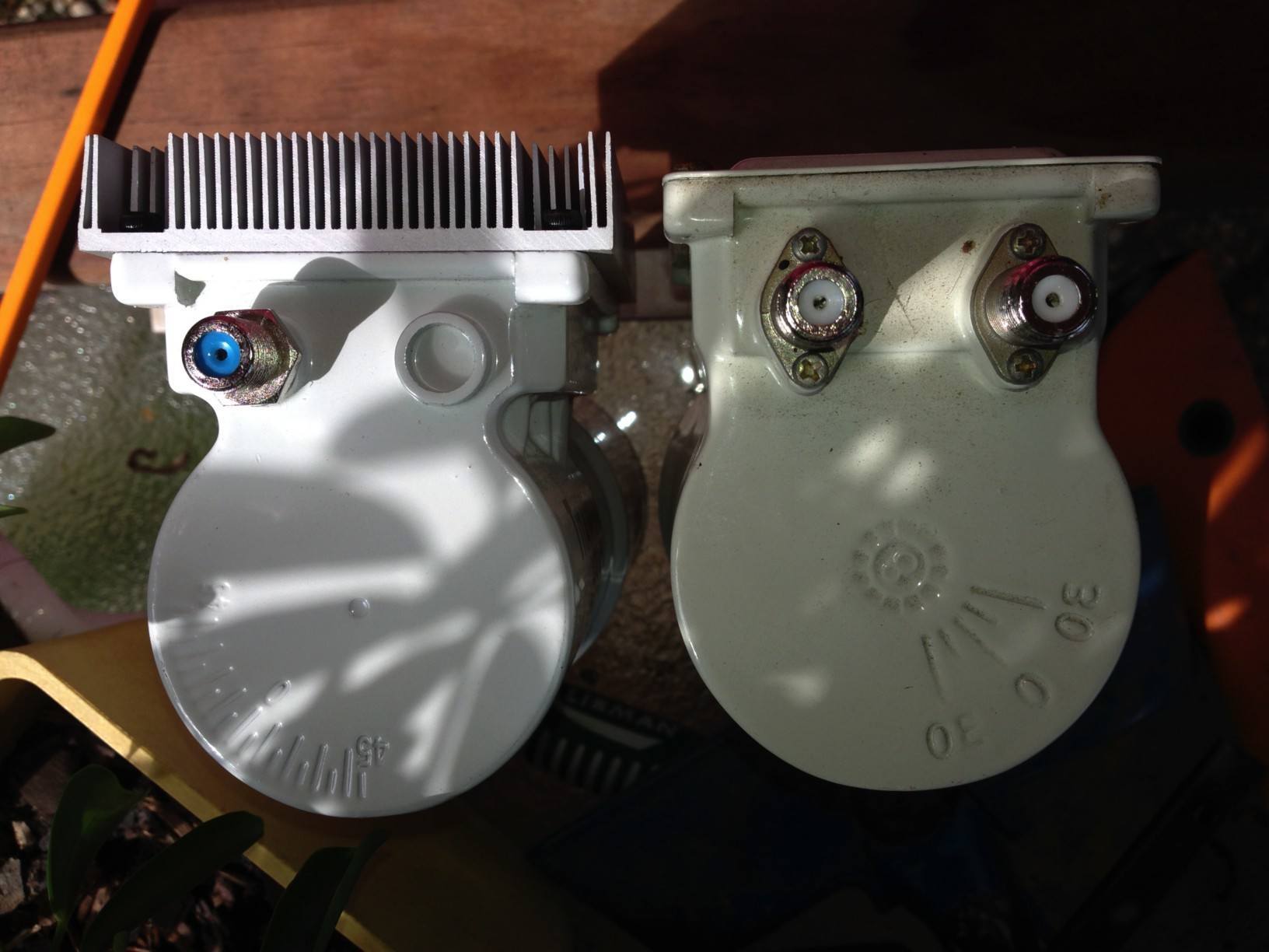

I had a difficult time with the new LNBF because the skew markings on it are not the same as the one I took out. I do not know which one is proper though.
After a lot of contemplation I decided that I would ignore the markings and put the new LNBF back in place in the same orientation as the old one.

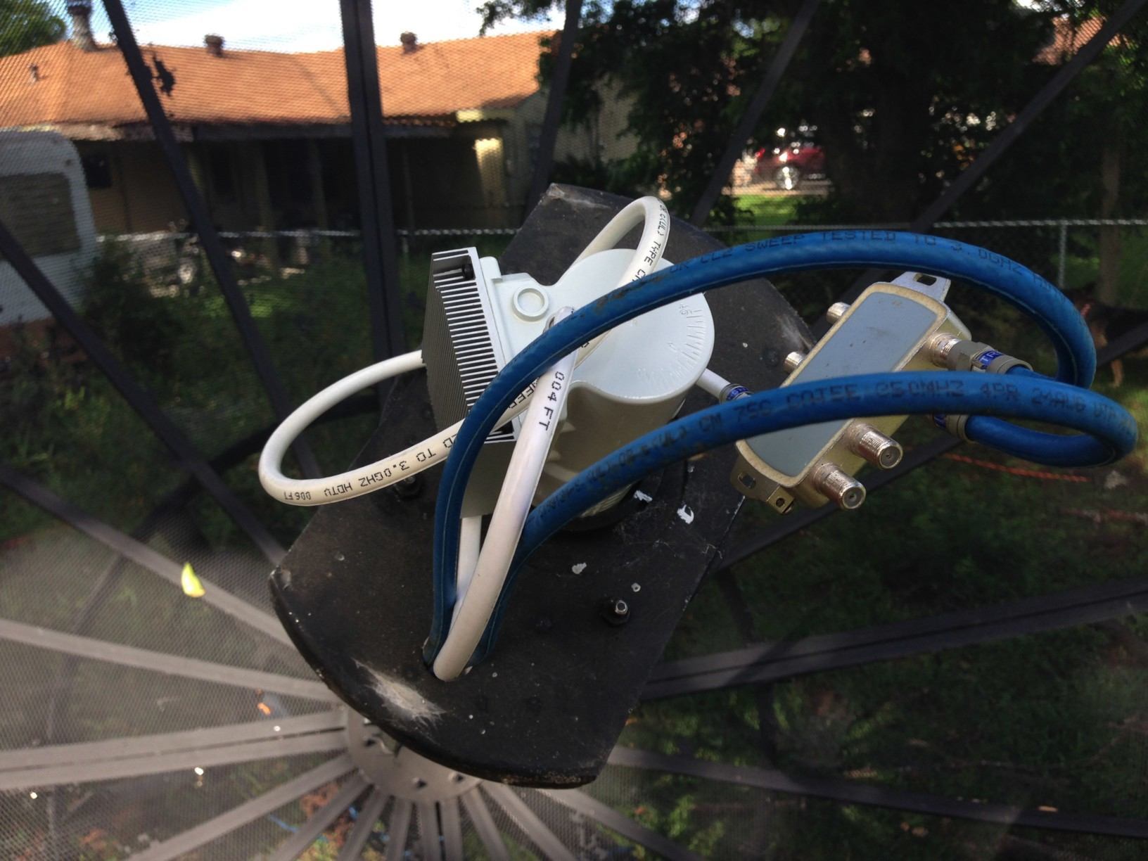

I used a 3x4 switch (or is it a splitter?) to be able to feed two wires from one LNBF. This will work just fine until I buy a few of the new C2PLL LNBFs.

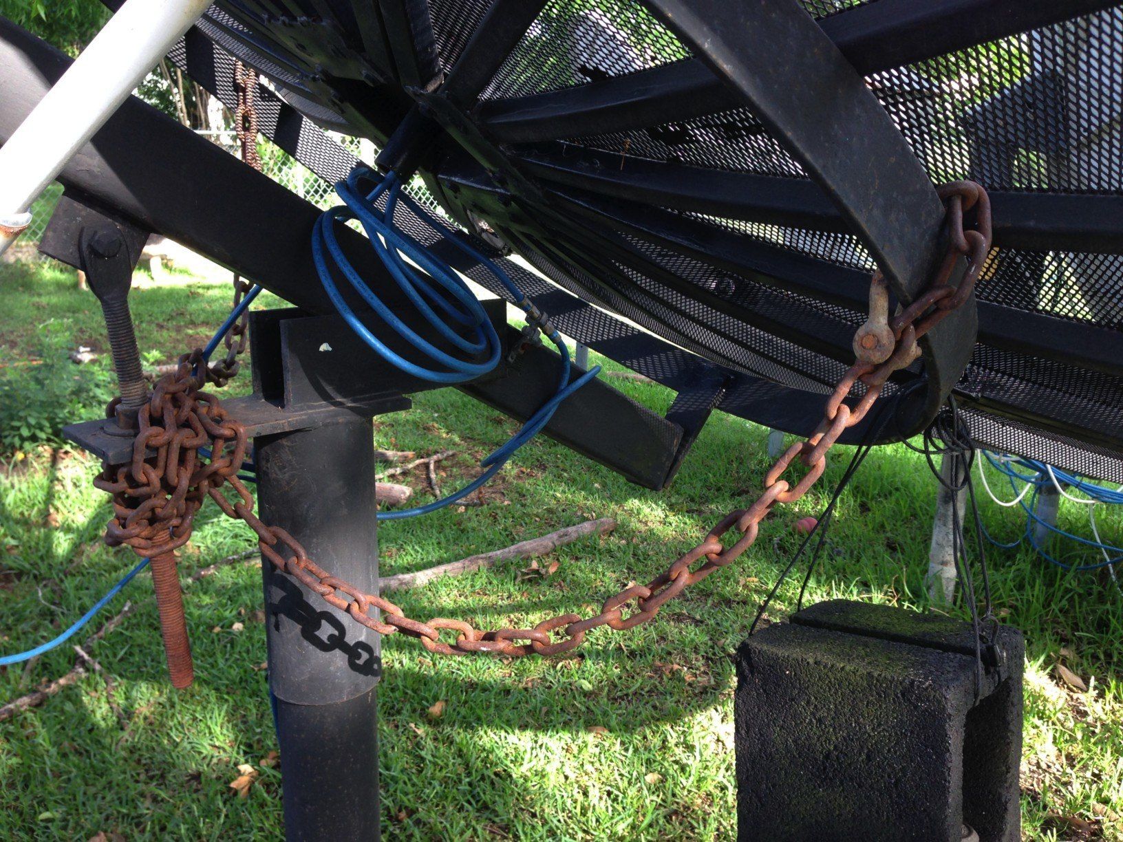

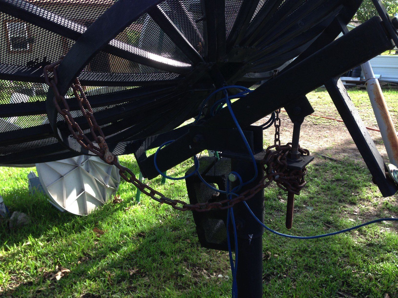

I tipped the dish waaaaaay over and got on a ladder and it wasn't all that bad, except for the miserable heat.
While I was out there, I bolted an old chain to the dish so that it's impossible for it to have an accidental tip over. I had several of those a few years back.
And if there is a hurricane coming I can pull it tight so the dish will be locked in place.
So I tried to find the Luken stuff on 87 but I had no luck.
I suspect my dish is not at all properly aligned. Once I get my new meter I'll see what I can do about it.

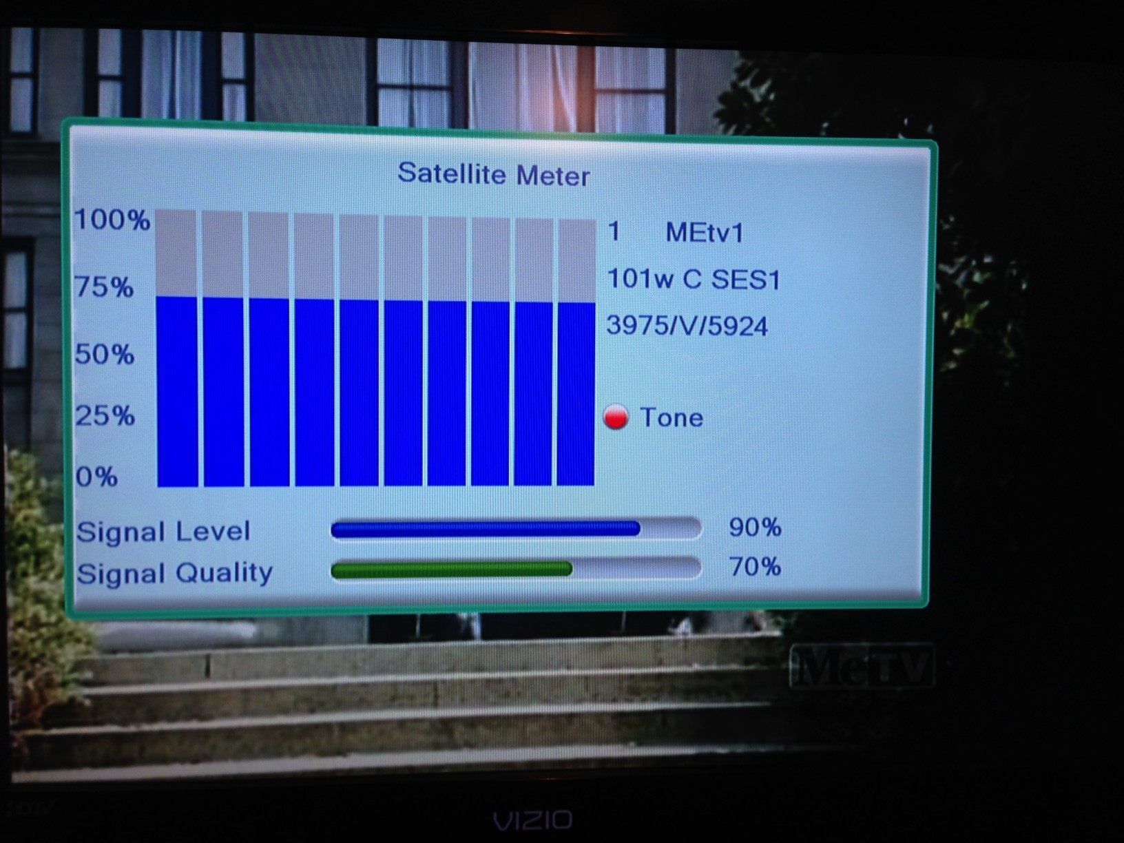

So I swung it back to SES-1 and decided to leave this dish dedicated to MeTV.
I bumped it back and forth and discovered that I can be a LOT off and still get a rock solid signal with the PLL.
I found the middle point and reset the G-box programming for this new spot.
I got a SOLID, 90% / 70% signal. It was unwavering. Previously it would fluctuate a fair bit.
Question 1 is, is the 90/70 the best signal I can get with a MicroHD ?

There is an audio transponder @ 4043/03910 H that is non S2 and fairly strong. You might also try 4148/03910 H.
"0" is in the proper place on the C1-PLL, where most are 90 deg off, and who knows why. 0 should be point to the top center of your dish at its zenith.
