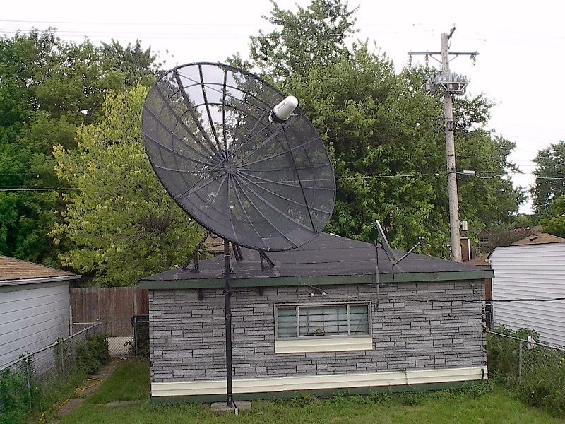

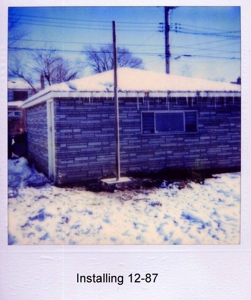

My dishes pole is 18 feet long. I have 6 feet in the ground in concrete. The pole is filled with concrete. It has supported my 12 foot dish for 20 years in winds up to 90 mph.
Here are 2 pictures from my setup to give you an idea of how a long pole works.
Take a good site survey and elevate where needed. Sometimes raising the dish a few feet or pulling back from an offending object can make all the difference in the world. I try to shoot for a full view of the arc when I take site surveys.

The picture you see is of my garage and 100% of the weight is on the pole not the garage.
