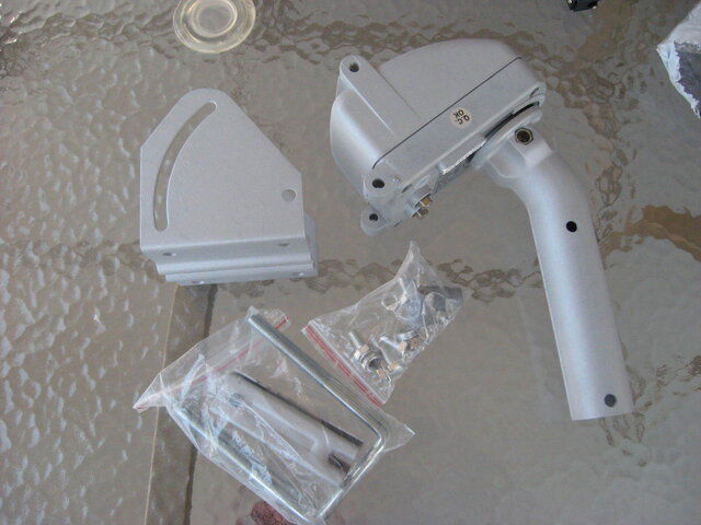

Back to the dish, a sheet of paper with a funny looking picture trying to explain how to assemble the dish… After a while I figured out which screw has to go where.

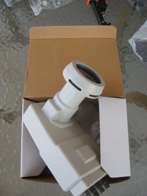

LNB on one end, motor on the other end.

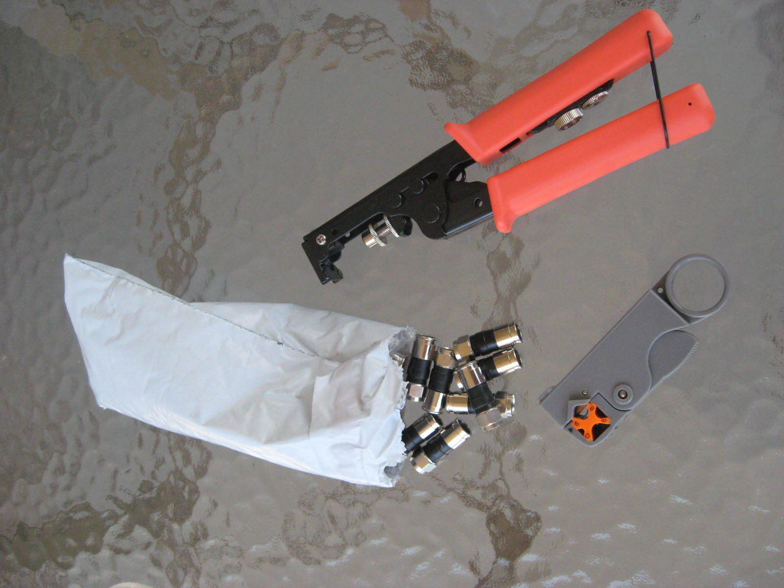

Next day, next challenge… Never used this RG-6 "press-on" connectors before. Not a problem, after I screwed up the first one, I figured out how it works. Cables are done and connected.

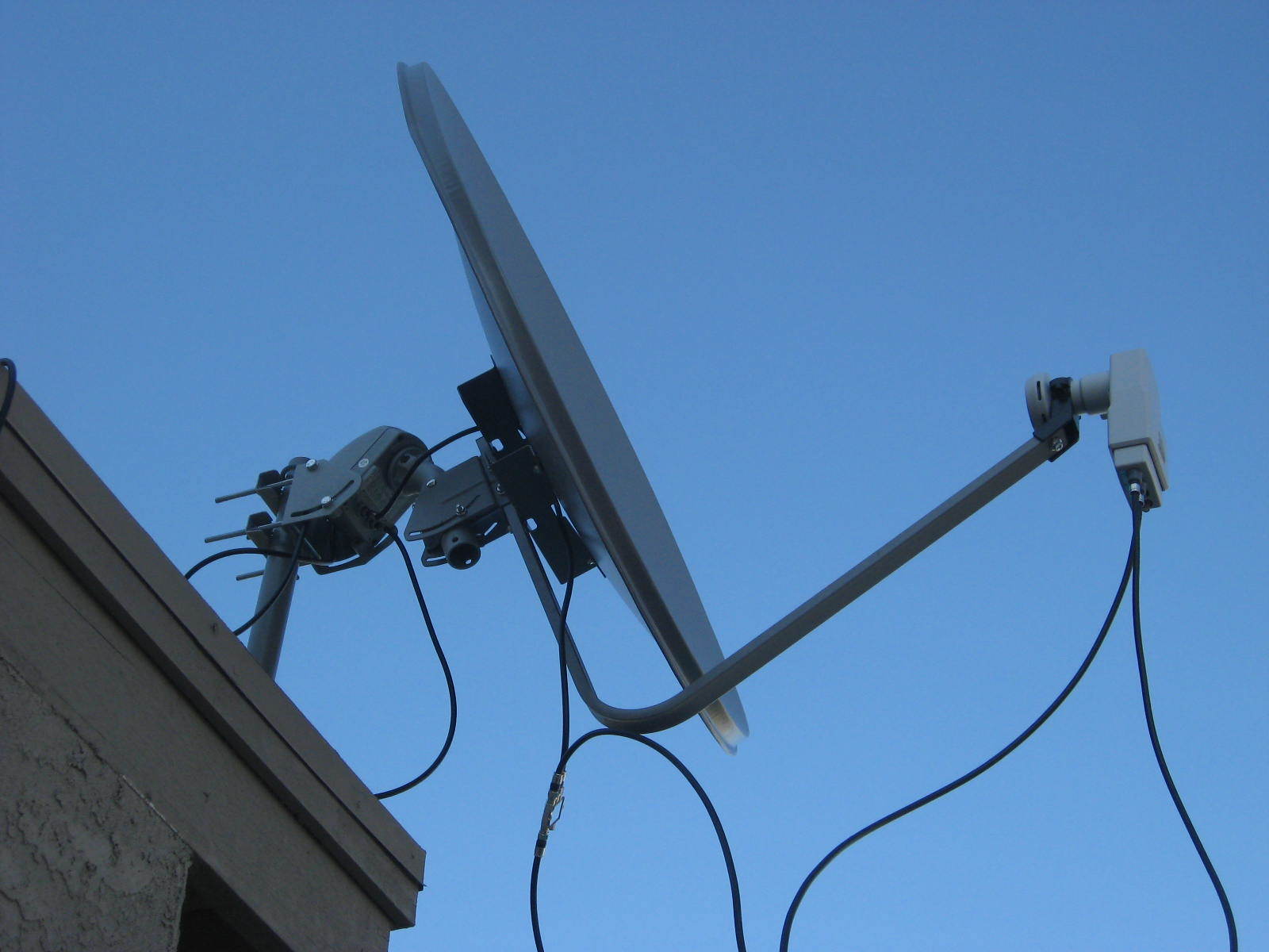

Well, it looks like I'm a little bit off, just 15 degrees. No problem. At least I had a starting point for further alignment. Went into satellite settings, changed the current satellite to G25, the dish moved and the signal was gone. A little twist to the right and the signal came back, at least the motor direction was good now. Some more ups and downs with motor and dish and after 2 hours the mission was COMPLETED.
I still have to get some cable ties and some grounding equipment, but it is finally working.

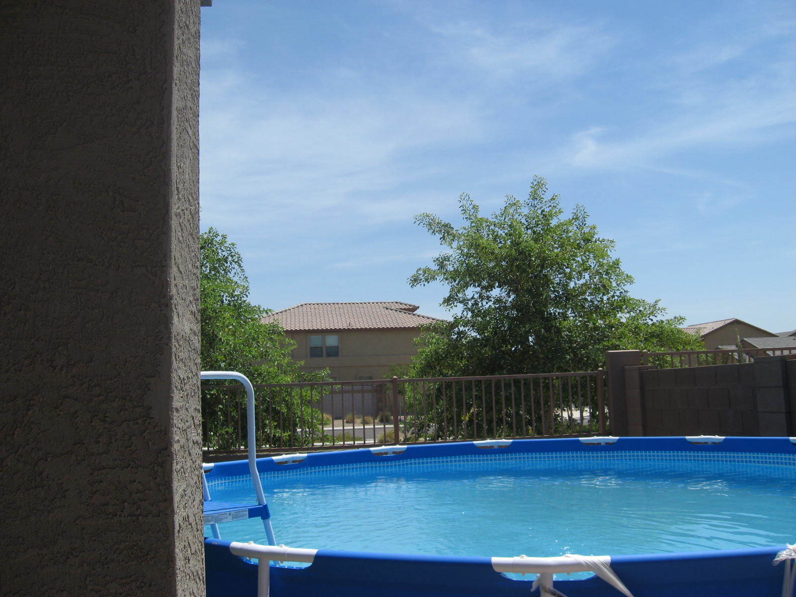

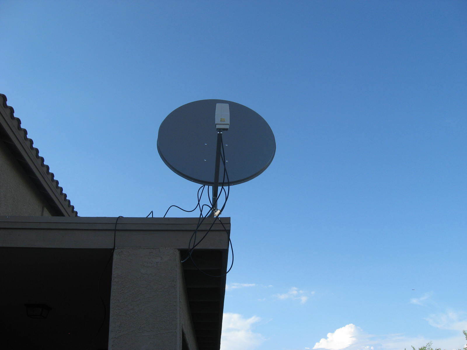

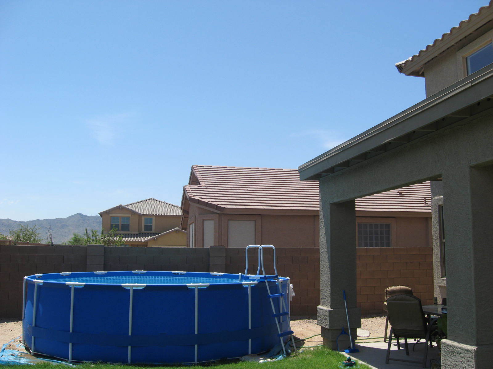

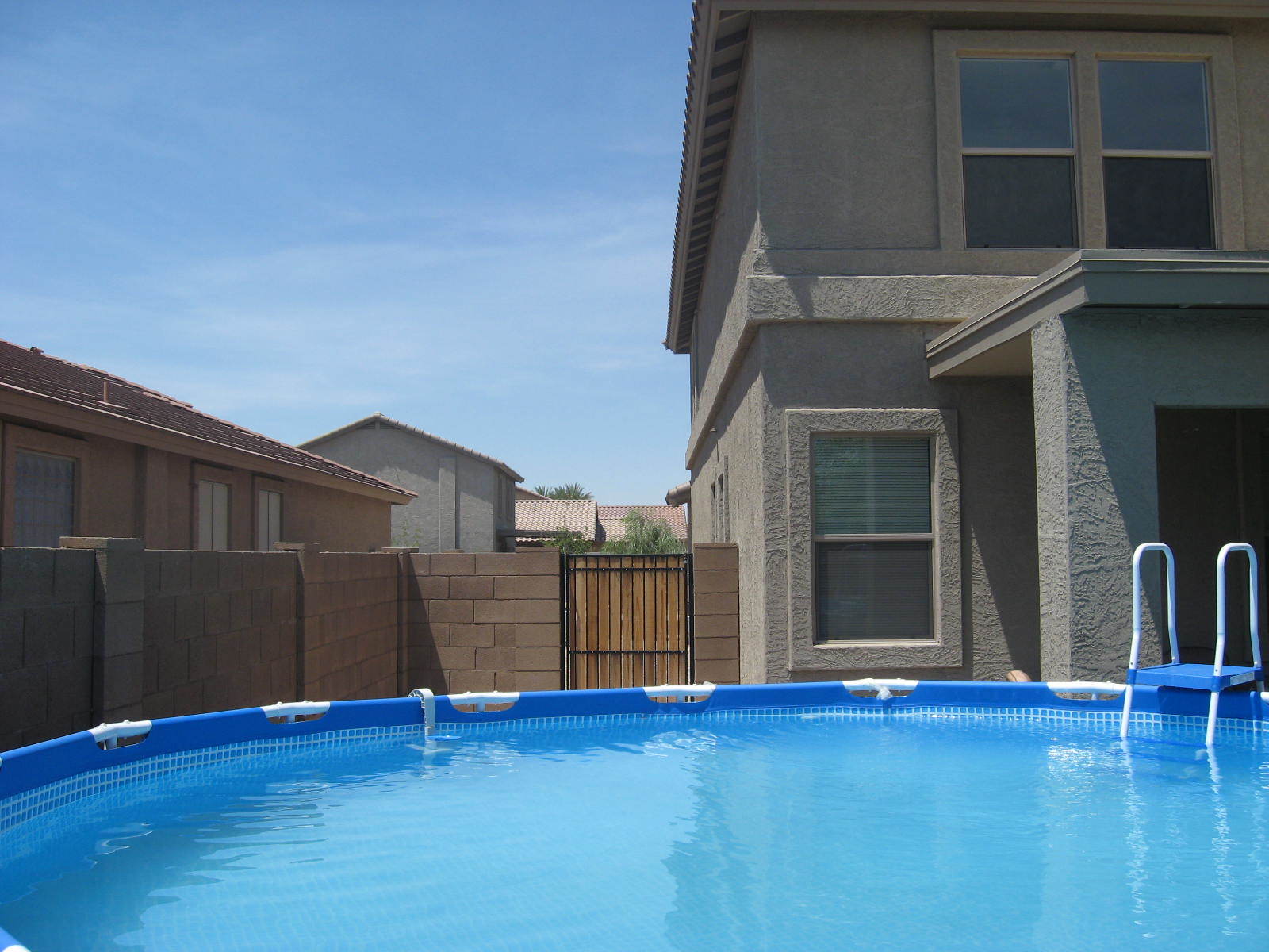

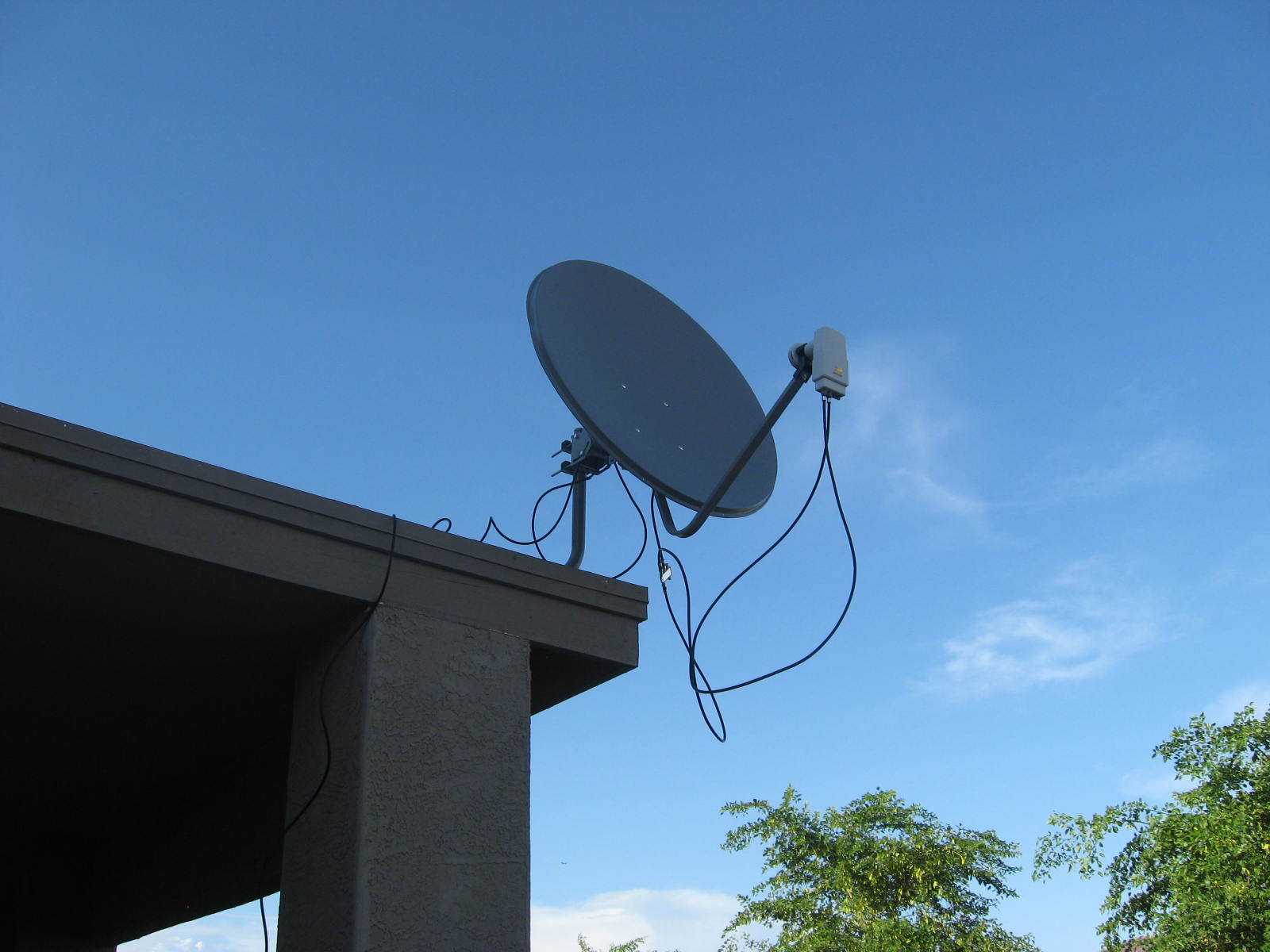

Speaking line of sight...
Picture 1 - South, a little bit to the west
Picture 2 - East
Picture 3 - West
On #1 and #3 you can see the corner of my patio deck, where the dish is now mounted.
Position... N33.34, W112.13 (within a 200 yard radius)
If i go by dishpointer.com for 43W, there is nothing in my way (at 8 degrees elevation)
but it looks like my motor is not aimed at my true south. maybe i should invest some dollars and get a compass ;)
