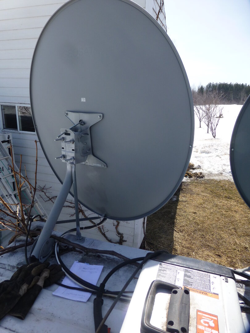

We had 3 days of major winds... I LOST 103w/99w (my 1.2meter) It rotated or something... That is also my radio station. I had to snow blow this morning, and i got two hiccups of radio signal in a 30 minute period that told me that it is an alignment issue. I also had a solar panel lift up and flip over and rip the power cord out... And to top it off, im SICK, thanks to my son... It took everything i had to fix the solar panel, and I'm shot for the day.. So, 103w and 99w will just have to wait until I don't feel like the floor of a taxi cab... o_O Luckily, i have a DW news IP stream i can watch.
Hopefully, there aren't other issues...
Sorry to hear it! Hope you feel better soon.
Reactions: iBoston
Still sick, but with it being 64 degrees outside and aspirin doing its job, i took a meter up to the storage container and manually rotated the dish through brute force (didn't take much) until i heard the signal come back in strong. Literally spent less than 30 seconds.. The only thing i cannot get is the PBS stuff on 99w. Good enough for now. Ill wait until im all better before i do a proper fine tune and re-weld of a broken support arm.
I just wanted my DW back and my radio back.

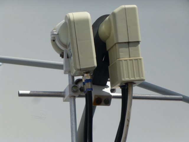

Okay, i feel much much better today.. I'm over the hump. I got outside, and fine tuned the main dish, and gained an additional 1dB and then re-adjusted the side-car lnbf for 99.5 and gained an additional .5 dB that way, and am now pulling in the PBS mux there, which i know is a hard mux to lock.
Man oh man, does it take a LONG time to lock the FSIE (11995 v 2/3 1075) mux... It is taking 5+ seconds to lock it...
The hardest part is getting the welder up there. I then painted where i welded and any rust spots that were on the dish.
