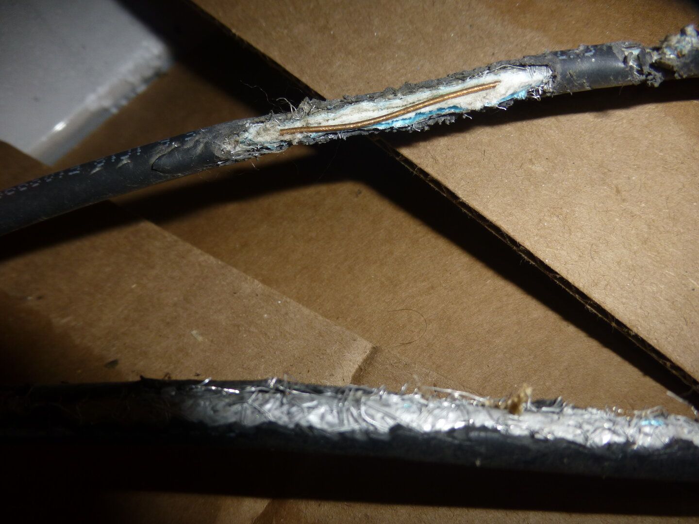

Well, i just opened a can of worms.. I have a shared RG6 with a ABC switch. One for guest room, one for office, and one for 2nd port on living room. I usually use it as a secondary port for the living room so that i have dual tuner to be able to record one thing and watch another. A couple months back, i lost my secondary tuner with regards to all KU dishes.
Today, i toggled the ABC switch to confirm its happening past the switch, and sure enough the problem continued.. That told me it was somewhere upstream, and i guessed it to be the diseqc 1.1 switch that is in the shed outside. Armed with a diseqc 1.1 switch, i swapped it and the problem continued. I then followed the coax upstream and discovered the following :
Darn varments. So, i swapped out that cable and noticed a second cable chewed through and with further discovery, i found multiple damaged cables.. :facepalm When i thought the problem was the diseqc switch, I estimated this to be an hour job, and now with all these damaged RG6 cables, this may take a full day to get it all worked out. In the mean time, i disconnected the RG6 that feeds that line so there is no power on it. Ill have to save this job for another day, which will surely be a LONG day of re-cabling and reorganization.
So until then, no Satellite watching in the office or guest room, which is rare anyway, usually during the summer when we get visitors... I still have 3 functioning lines out to the KU. Main Living Room, Kitchen and Basement/Exercise room.

Sorry to hear that. Had that happen once but only a tiny section near the dish. Cobbled a new section in and was good to go. Now engines on snow blowers, tractors, etc - love having to dig mouse nests out of the air intake, etc. Hope you can get things working again.
Reactions: iBoston
I live in a jungle in the mountains. My coax has been on the ground for 3 years. All kinds of critters her, but no chewed up coax yet. For three years I have planned to go overhead to the basement but my lazy ass has not got it done yet.
Reactions: FTA4PA
I was hiking one time and I came across some sort of abandoned installation where some 3/4" (at least) hardline had been chewed. Everything except the copper core.
The local radio club used to have porcupines chewing up the wooden walls of their repeater shack. It's now metal-clad.
Reactions: FTA4PA
My coax looked just like that. Gophers, I think. Right now I have some cables in black ABS pipe and I have more to do. I saw a slit in the pipe length so I can just slide the wires in instead of disconnecting everything. Same with elbows and couplers.
