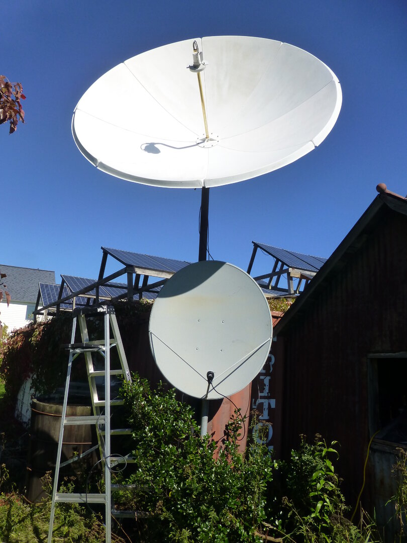

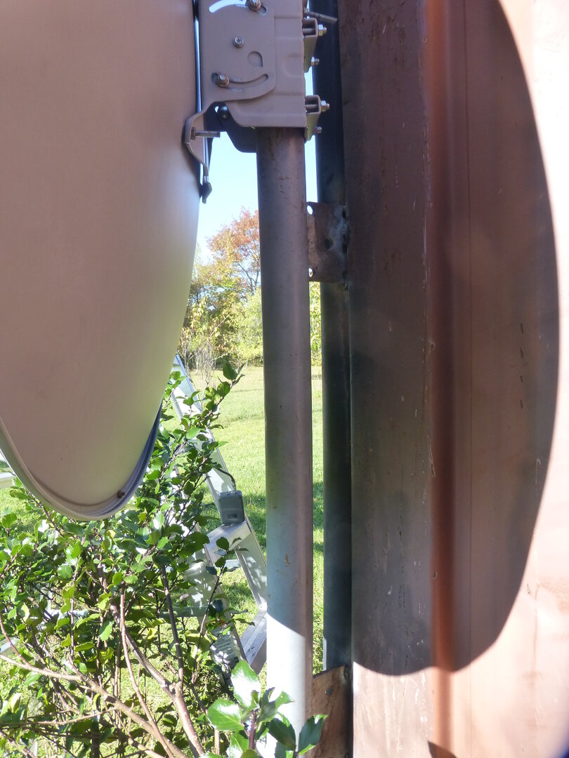

I hooked up my 4' KU under my 9' Cband dish. I welded a pole onto the corner. I attempted 117w, but was unable to obtain BYU. So, i plan on aligning the dish to 91w, and ill put my 99cm on 117w. This dish was on my other storage container and came down during a nasty storm that brought some crazy winds. It turned out to be a good thing, because the dish was in the way of my 8' cband from rotating west where i wanted to re-align it. Hence why i didn't put my 4' back in the old place, there was no longer room for it because the cband pointed more west was in the way. This is a good spot and ill be able to align anything from 89w and west....

Ps, i spray painted the weldings and pipe on the 1.2m in the picture above and properly tied all the wires.
I will also add, that both dishes in the picture above , the 9' cband and the 1.2m KU dish were freely donated by another FTA user about 3 years back, and was driven from Southern California 2300 miles to my location. It feels good to keep used dishes in service.

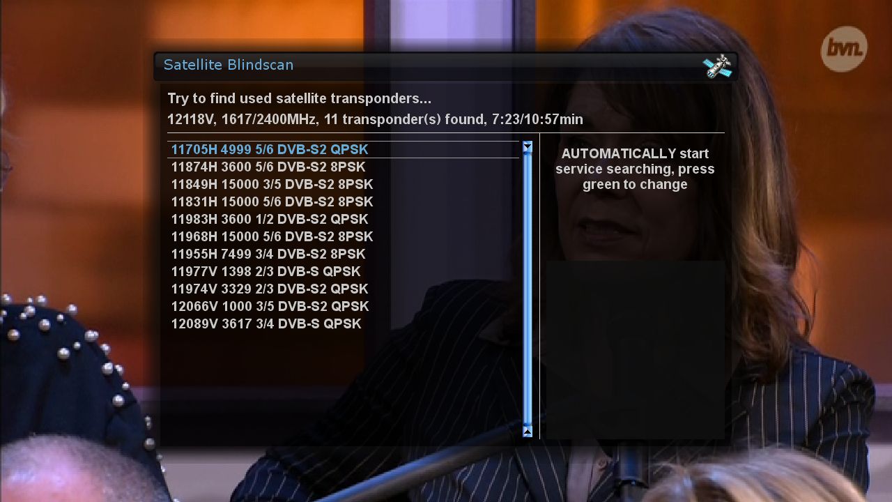

Here is my blind scan of 113w. Seems to be performing well :

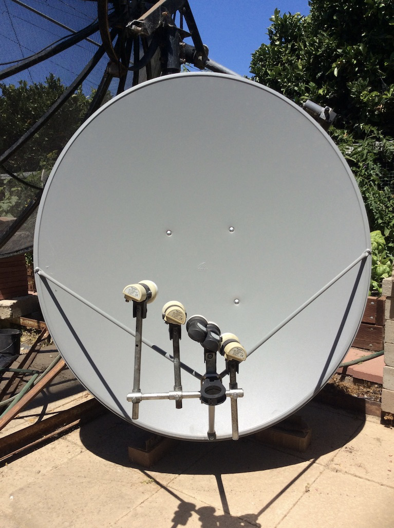

So, here's my two dish eight satellite Ku setup and experiment. The first picture is the working installation.
The white Aimsat has three LNBF's capturing 117W (Maverick), 123W and 125W (both a universal Amiko slim LNBF). The focal point is quite long so I was able to get two degree separation using the slim LNBF's.
Here's a picture of the GeoSat dish while I worked on it on the ground before moving it to the roof and adjusting the LNBF's. Two Mavericks on the left are for 87W and 91W, then my experiment with two used Avenger LNBF's for 97W and 99W and finally another Maverick for 103W.

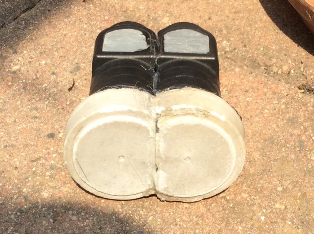

Here's how I got two degree separation with the old Avengers. I measured the LNBF distance between 103W and 91W and calculated how close they had to be to get 97 and 99. This will vary depending on your dish. I think my final measurement was about 1 1/4 inch from center to center. I got the hacksaw out and started cutting then filing to get them close. You can see the rubber band I used to keep them together while the Krazy Glue set and I had a chance to use the hot glue gun on the plastic body then finally putting the feedhorn cover back on with the glue gun too. As you can see the covers have quite a bit of sun damage and cracked upon removal so I glued them the best I could.

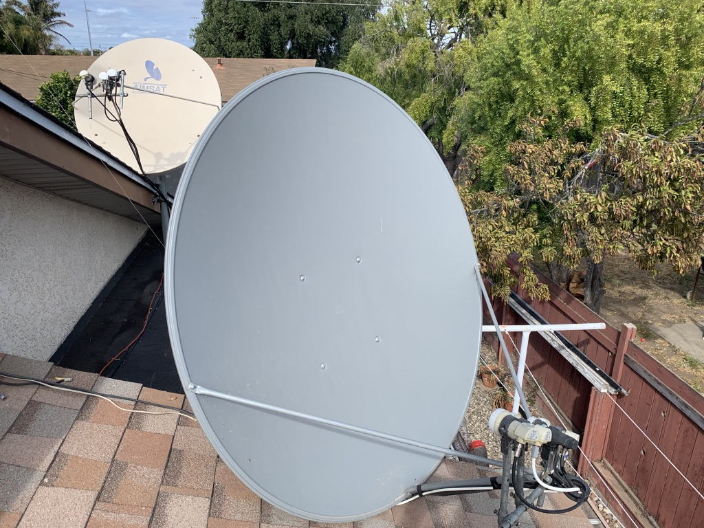

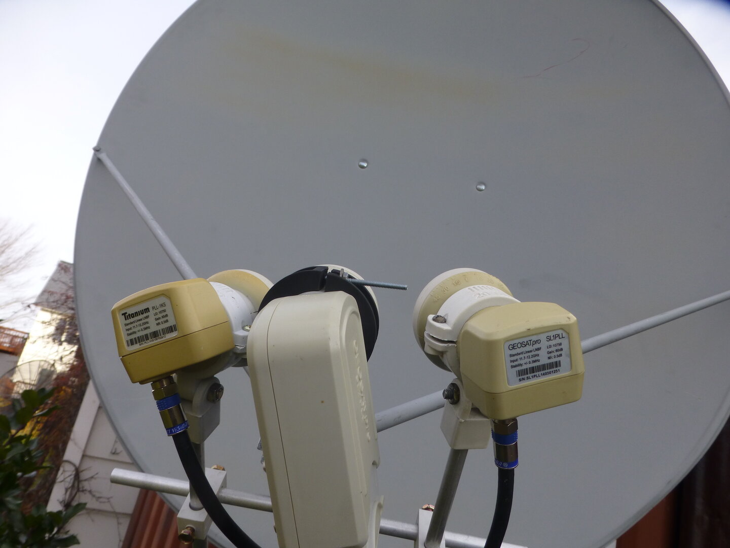

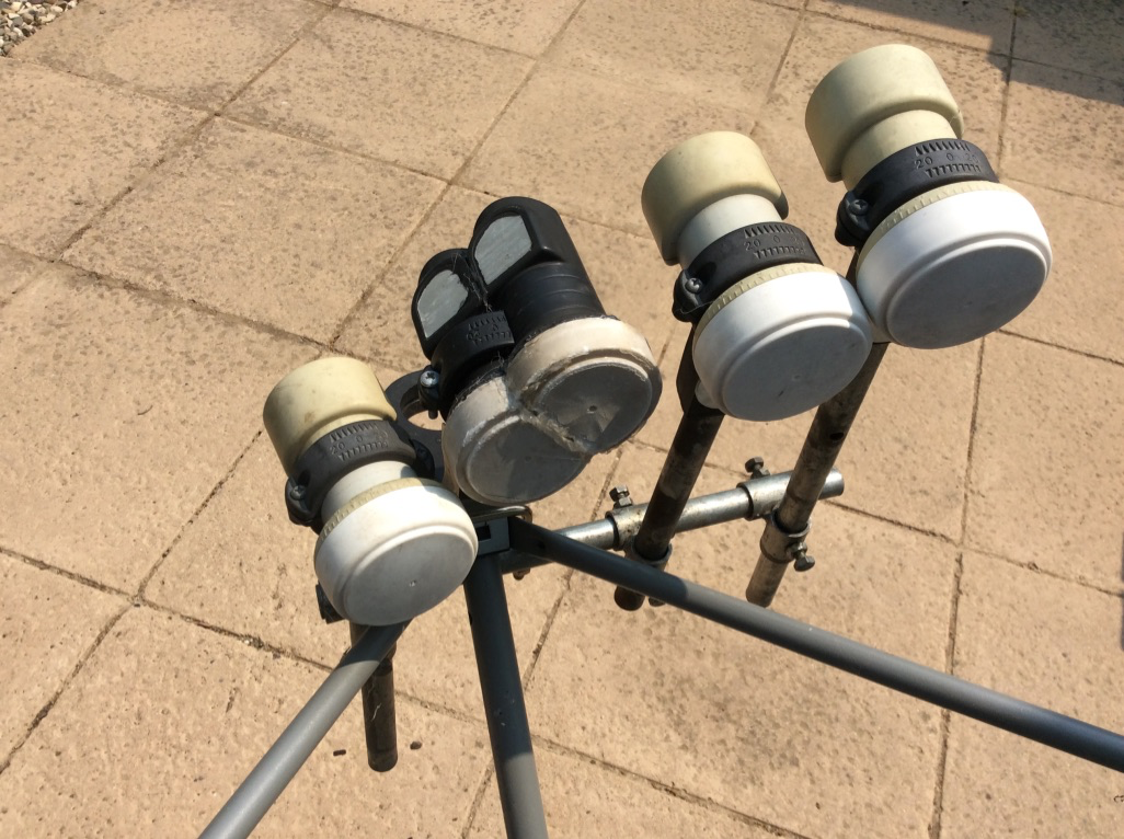

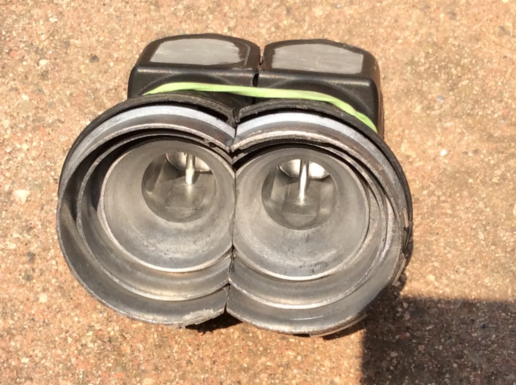

Great idea to melt the two together. I have extra and may have to try that.
