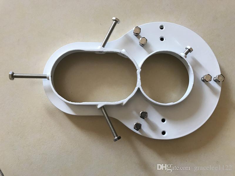

Are you using one of these? I could never understand how it is supposed to attach to 4 arms
I use one of those on my 10 footer where I get 180 on the main and 177W on the offset. That's why I wondered the setup for iBoston. I removed one of my four support arms, spread out the remaining three and drilled new holes in the dish frame to attach them.
Reactions: k.r.
I removed one of my arms, everything else fit normal. What is the minimum degree you can get on a 9 footer you think? I wonder if you could get away with 2 degree separation? ie getting 101 and 103w , And the scalar picture above is pretty much what i have.
I'm confused why they didn't design the dual lnb scalar to accommodate four arms. If I decided to get one, I'd probably just drill in new holes in scalar as I suspect four arms helps maintain symmetric geometry of reflector.
The 90 degree spacing of the 4 arm design usually prevents the offset feed from proper horizontal axis alignment. The proper position would only be a few degrees above the horizontal axis line. When I have installed this type of 2nd feed mount scalar, I have simply shortened and relocated the 4th arm to the outside of the offset portion of the conical. Less than perfect, but it works.
For a button hook, 3 or 4 leg design, I prefer to cut two scalar rings to allow them to sit closer, then bolt them together.
