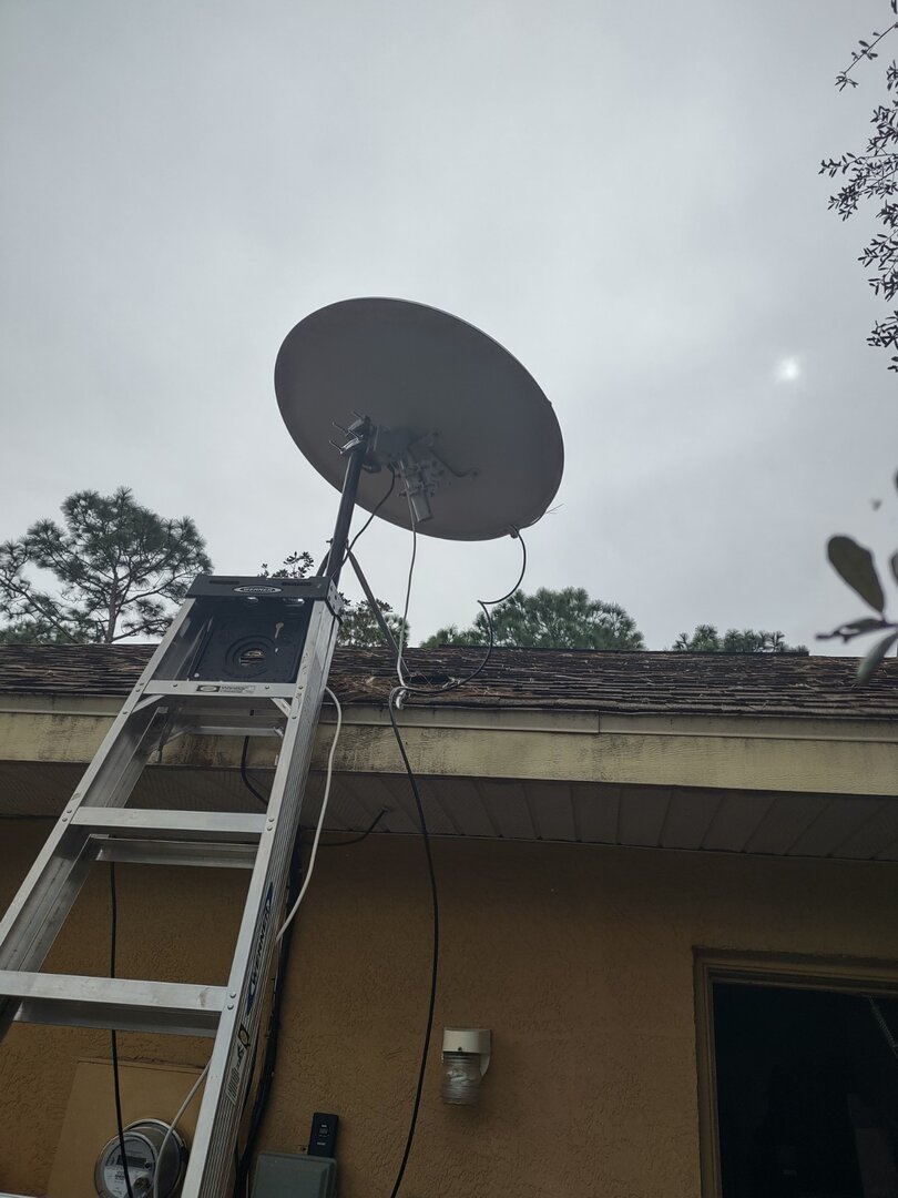

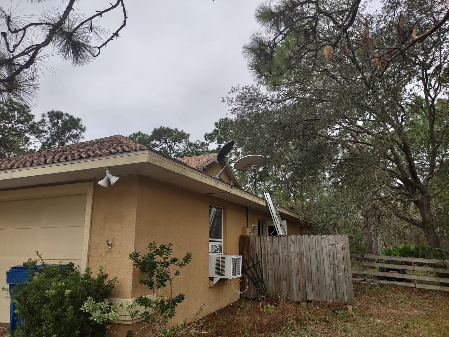

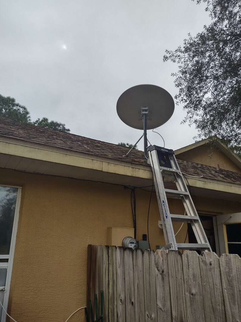

Ok here are some from the ground. I will get closeups in a little while. I found that my 39" dish has a listed offset angle of 24.62*
pics.
That's aimed WAY too high! Give us a photo showing the elevation adjustment bolt area, showing the degree markings of how you have it set.

Yeah. Rimi. Get the idea of this page. Stamped dish mount angles, motor angles aside.
Get the AR application and look at the satellite arc in the sky. If you can get the arrowed lines pointing at the sat you're looking for. At least you'll be a lot closer than your photos show. The angles of your current setup look like you're closer to the equator. Still waiting on closeups.
