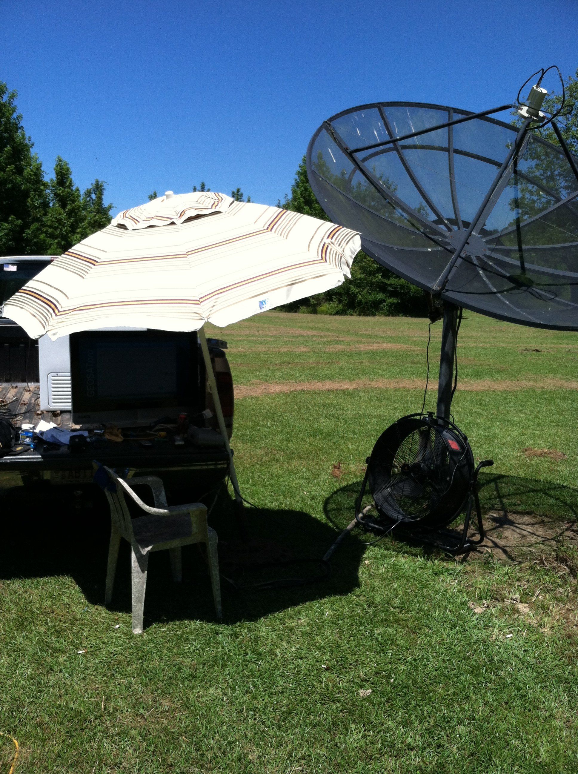

the main thing is to not get too frustrated with it , enjoy your time outdoors. bring a lawn chair kick back throw the dog a bone enjoy a brew or iced tea under the patio umbrella :) tinker with it a bit and relax :) its my main way of relieving stress , other day i was tweaking the dish and ran across lassie... musta watched 2 episodes lol
Reactions: . Raine
