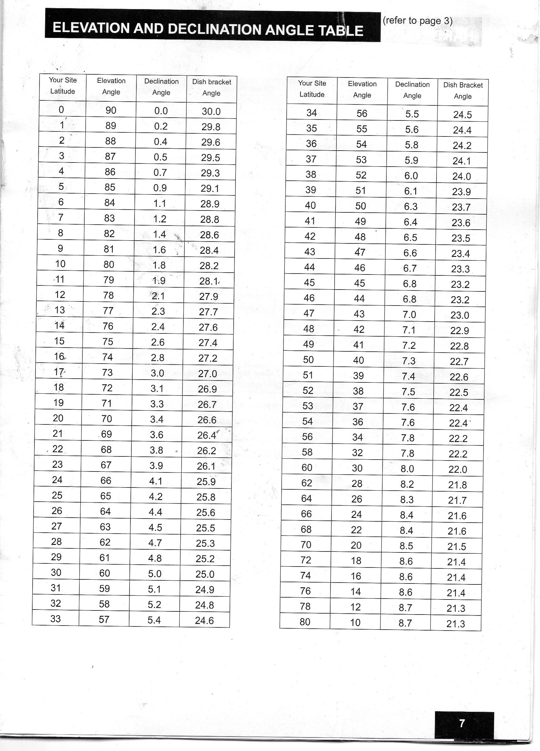

IBoston, here's the elevation and declination angle table for a SG2100, if you end up needing it.

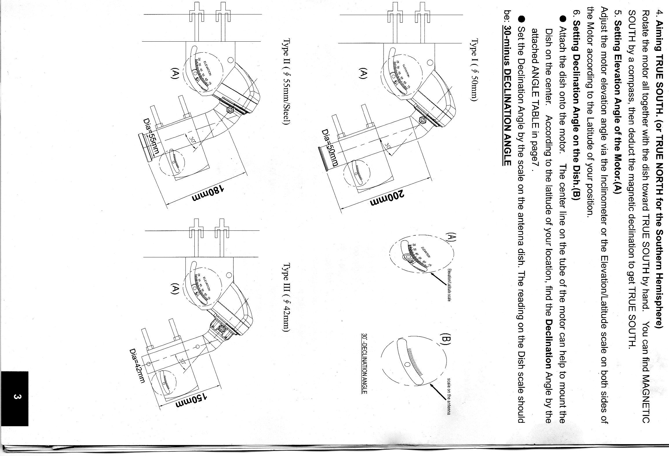

For the USALS software, it's just Lat and Long settings. With the hardware, when the dish is first mounted onto the motor, the motor elevation is set according to the chart and your latitude and then declination angle on the dish itself is 30 minus the declination angle in the chart. The motor itself has a elevation scale and so does the dish, so both need to be set. Does the Stab 90HH not have an elevation scale on it?

What is the declination angle of the DG380? For the SG2100 - I subtracted 30 degrees.
Wait until you get the dish as there is instructions on how to set the dish elevation for a motorized setup as the you have to install the elevation bracket upside down to install on a motor.
