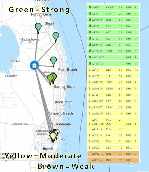

I know little on this subject, but I have read the advantages/disadvantages of directional and omni-directional antennas. I am considering an omni-directional antenna to avoid having to use a rotor, due to convenience and cost. Probably a tough question to answer, but based on the map showing the channel locations, would this be feasible or should I go with a directional antenna? Maybe it's possible to point the directional antenna south east to get the moderate channels and still receive the channels east of me (?) or it may be something I will have to find out the hard way. Maybe dual directional antennas?? Any thoughts?
If it was my installation, I would use a directional antenna. It's a hassle having to move the antenna but it would give you the best performance. You could get a networked antenna controller to make moving the antenna more convenient but it won't be cheap.

Just like Johnny says.

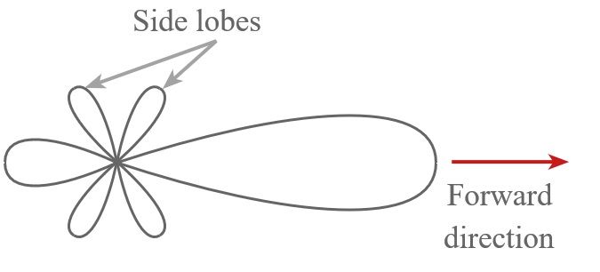

A directional antenna will pull in the distant ones. But they also have side lobes. Means that a yagi doesn't 'see' only in front.
Looking at your map and comparing a beamwidth spec. page you can pretty much see that indeed it's possible to get signal out on the sides of where you're pointed w/o having to turn the antenna. Please take the generic attachment very lightly. The more elements a yagi has, the more directional it is.
Reactions: Doorguru
*WPEC, WPTV, and WFGC are VHF High which complicates matters*
Not knowing the signal strength/distance on those yellow UHF stations... But, I doubt an omni antenna would receive them.
A multi-directional antenna similar to a DB4e (4 bowtie , UHF) should get all your green channels except possibly WPEC and WPTV. But they look strong enough to receive as well. That's with it facing NE-E. Some adjusting needed to find the sweet spot, of course.
Then point a 91XG (or similar) toward those stations to the SE. Use an A/B antenna switch to change between antennas. No rotor or rotor cable needed. You probably will not receive WFGC though. So decide if the programming on WFGC is important to you.
The 91XG needs to be mounted outdoors. The DB4 MIGHT be ok in an attic, but better outside as well.
You might experiment with only the DB4 first just to see what results you get before adding the 91XG later if desired.
From that picture you are living were I was born and lived 50 years. Anyway, been gone 11 years, but I had to choose between Channel 5 or 12, could not get both. All others were fine.

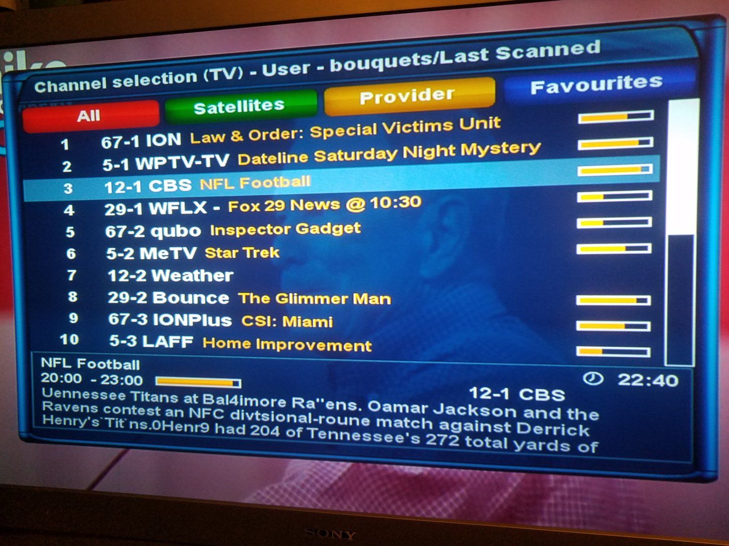

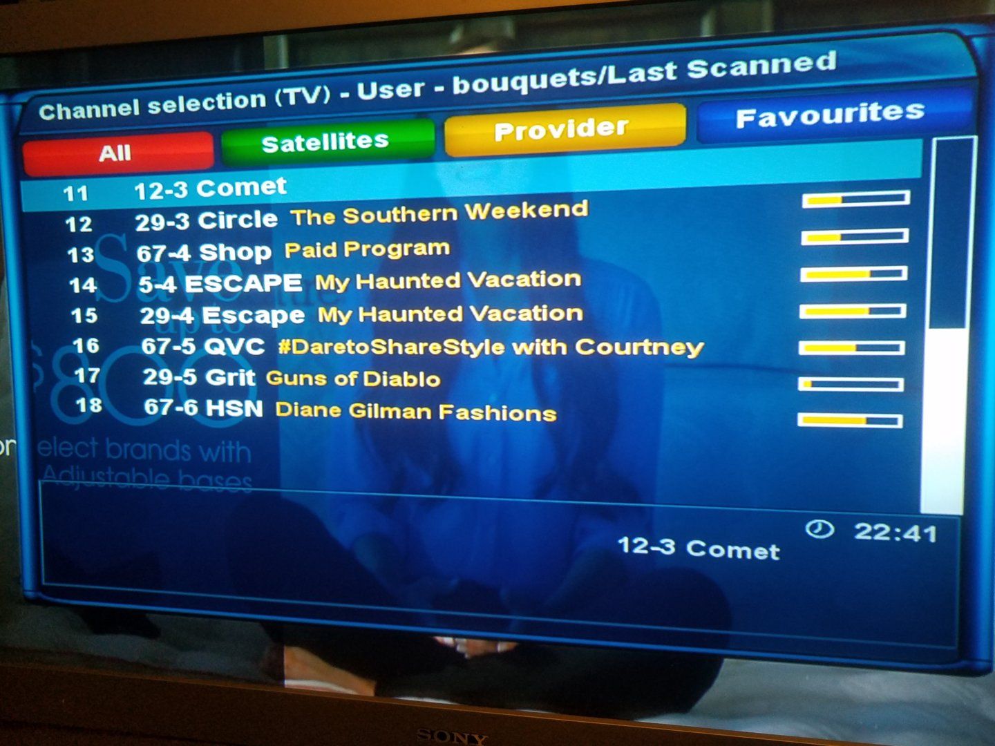

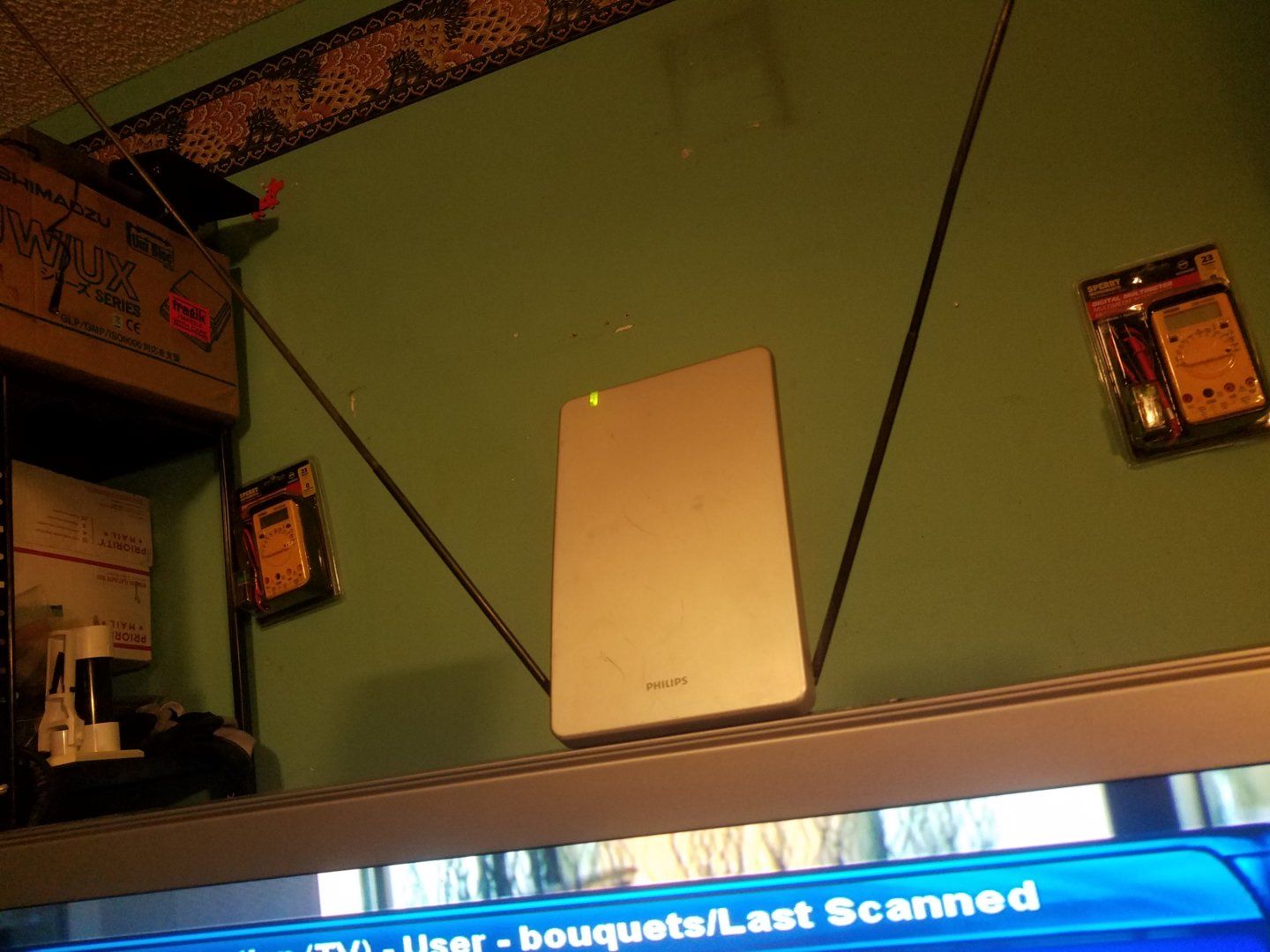

Just an update..
I'm still deciding on an outdoor antenna, but in the meantime, I found an old indoor antenna in the garage and tried it.. Receiving 18 channels.. all the local ones, all viewable. I was quite surprised! My only complaint, they are out of order..
