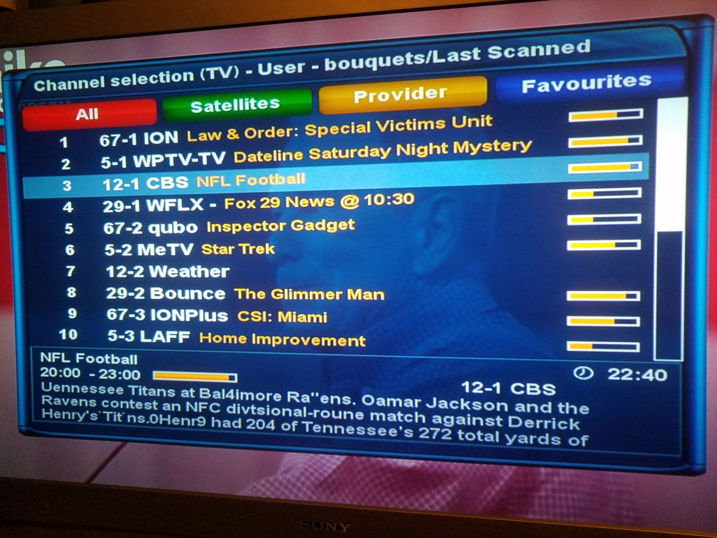

Your current display (bouquets/last scanned) is showing the servics as logged during the last terrestrial channel scan. Press the Grren RCU button a 2nd time to display a service list. Press the Green RCU button a 3rd time to select list display by services or provider.
Create a favorites list to order the terrestrial channels to your preference.

Call me stupid, but I can't see how to make a favorites list after hitting the green button a third time.
Sorry, as you were displaying your found terrestrial channel list in last scanned bouquet, I thought that you might not be aware of the other ways to sort the service lists. I was just defining the multiple ways to display your service list (channels).
The easiest way to make or manage a favorites list is with a PC on your network with native WebIF (the router assigned IP address in a browser) or using editing software like DreamBox Edit.

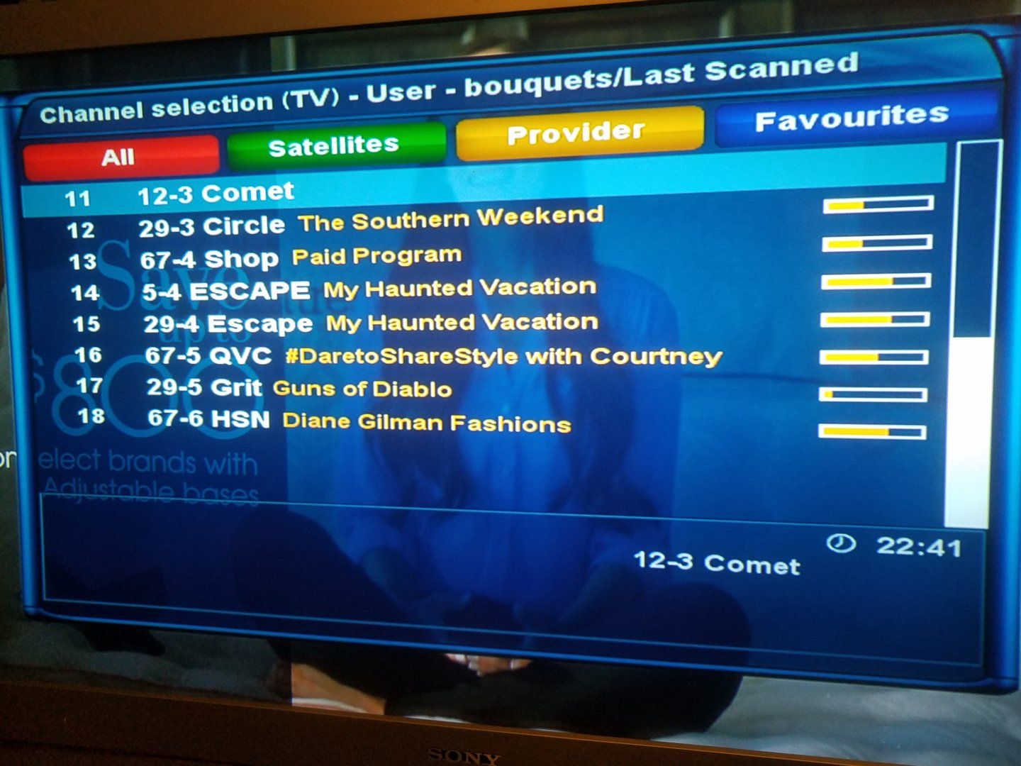

I'm still deciding on an outdoor antenna, but in the meantime, I found an old indoor antenna in the garage and tried it.. Receiving 18 channels.. all the local ones, all viewable. I was quite surprised! My only complaint, they are out of order..
