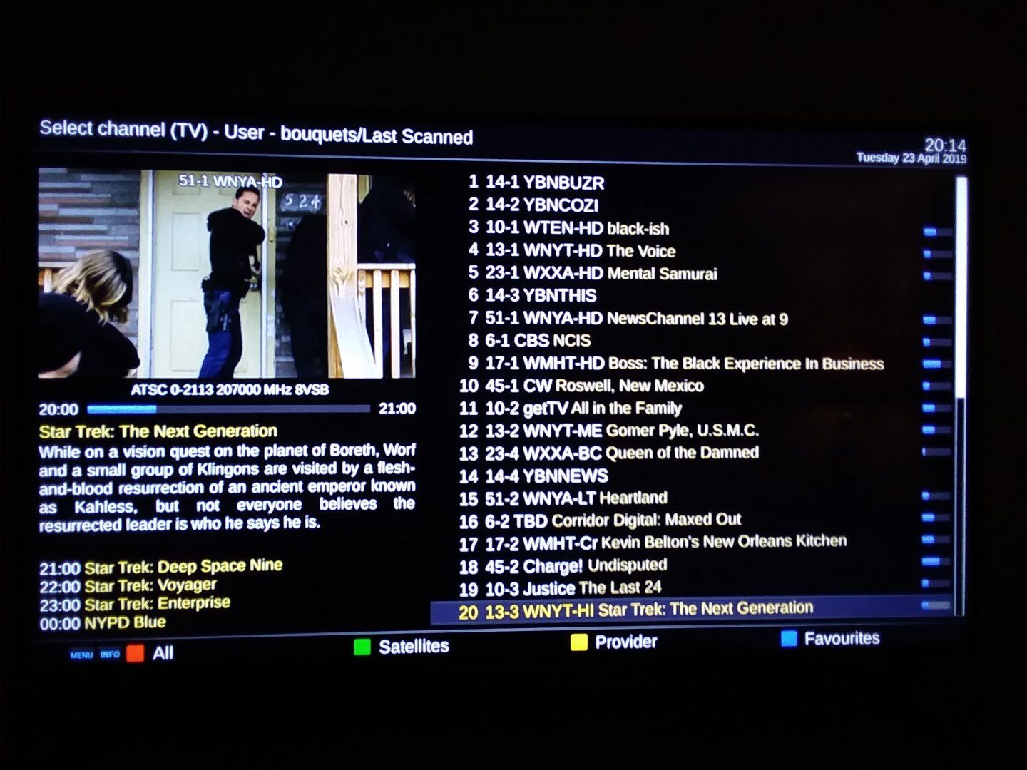

After a week of using the NA SDGr image only, I decided to try OpenPLI 7.0 last night for curiosity. I think I like the SatDream GR better.

Near as I can tell, the DreamDroid android app doesn't see the OTA stuff. DreamDroid is a little difficult to operate so I might be overlooking something. I was expecting it to see all bouquets (I hate that terminology).
I'm running OpenVIX and downloaded the 950 driver, installed the 950 and had to reboot before the Edision would see it. Scanned OK. Works good.
I'm not 100% certain but it appears that I had to install 2 drivers on all images: atsc-950q-usb-hauppauge and atsc-usb-hauppauge
I was expecting that all I needed was the atsc-950q-usb-hauppauge but scanning turned up nothing until I installed atsc-usb-hauppauge also.
