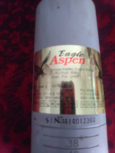

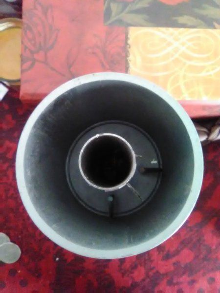

Searched through my goody box and found this.
It's an Aspen Eagle V4000.
I don't see an actual noise figure number. It says Noise Grade "Gold"
64db gain on C-Band, 56db gain on Ku
Dual Polarity C/Ku
The scalar got separated from the feed, but it should fit any standard scalar. If memory serves me, I bought this, stuck it on a dish to see how it worked, and took it back off. Wasn't really that much in those days to watch in Ku. The paint's a little skinned up and dirty from being carried around in the truck box, but I'm sure it still works fine. I have no use for it and if you're interested, let me know. It's yours for the shipping if it suits your needs. :)

PM sent! And Thanks!!
Wvman I got that LNBF today and I'll have to say it's a good looking well built piece! Now if it works as good as it looks we'll be in business and I'll be looking for two more! ;) Think I'll do an internet search and see what I can find out about them.
