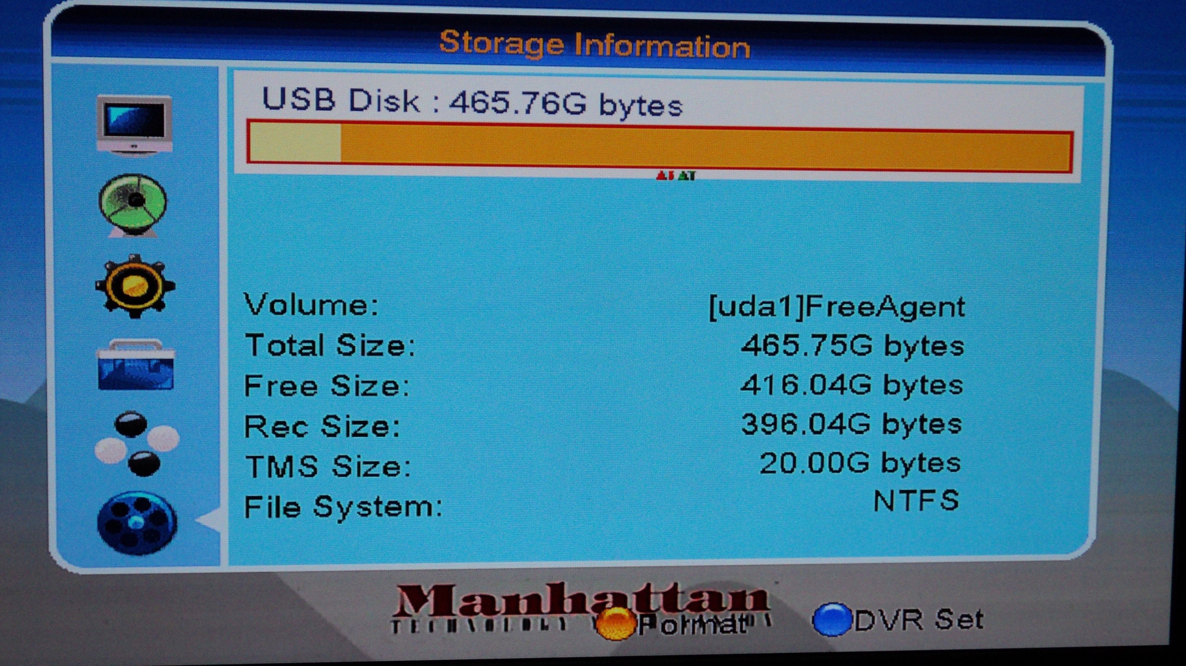

Some machines are finicky when it come to drives I agree, but I am using a 40g USB powered scan disk @ fat 32.. you can use free software -HPUSBDisk to format fat32 to larger than 32gb.

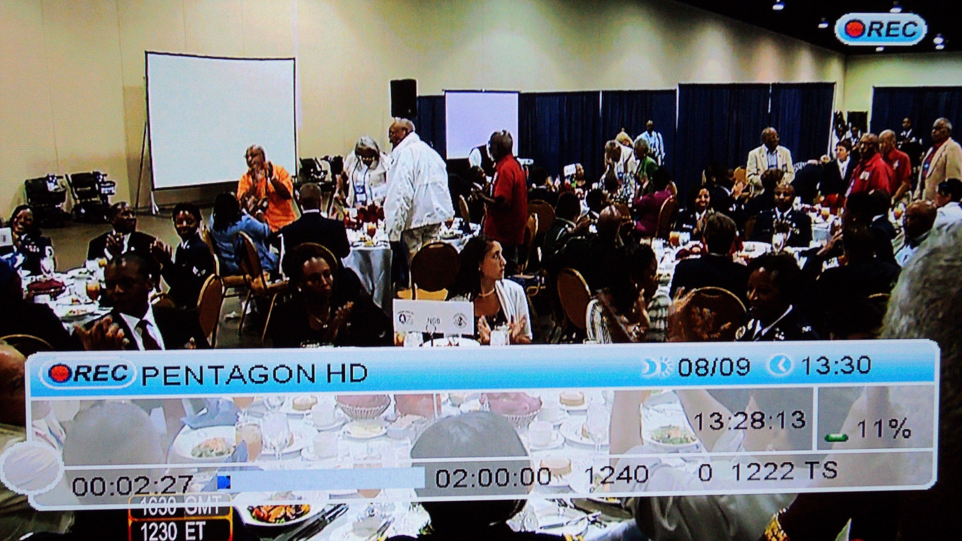

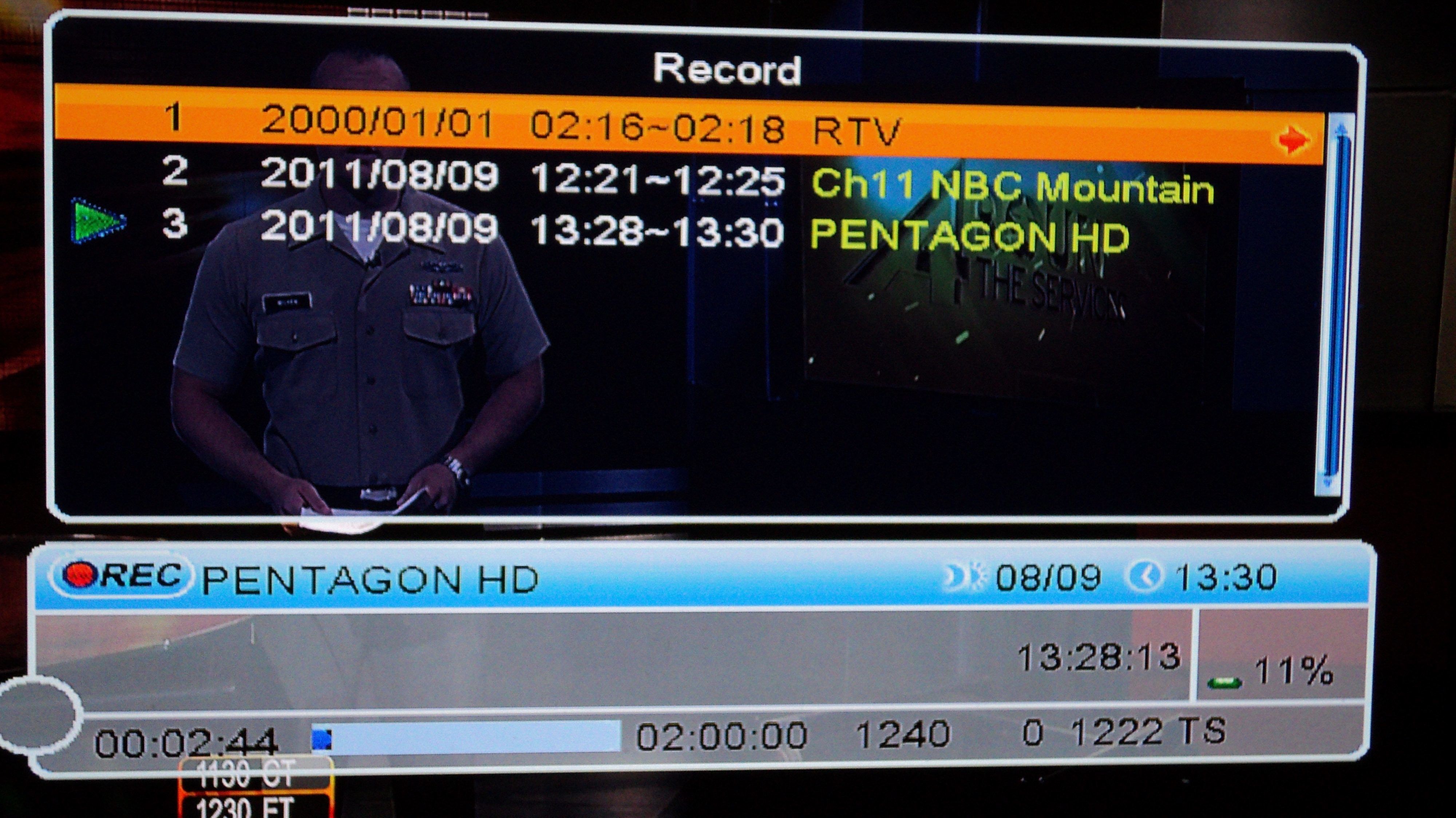

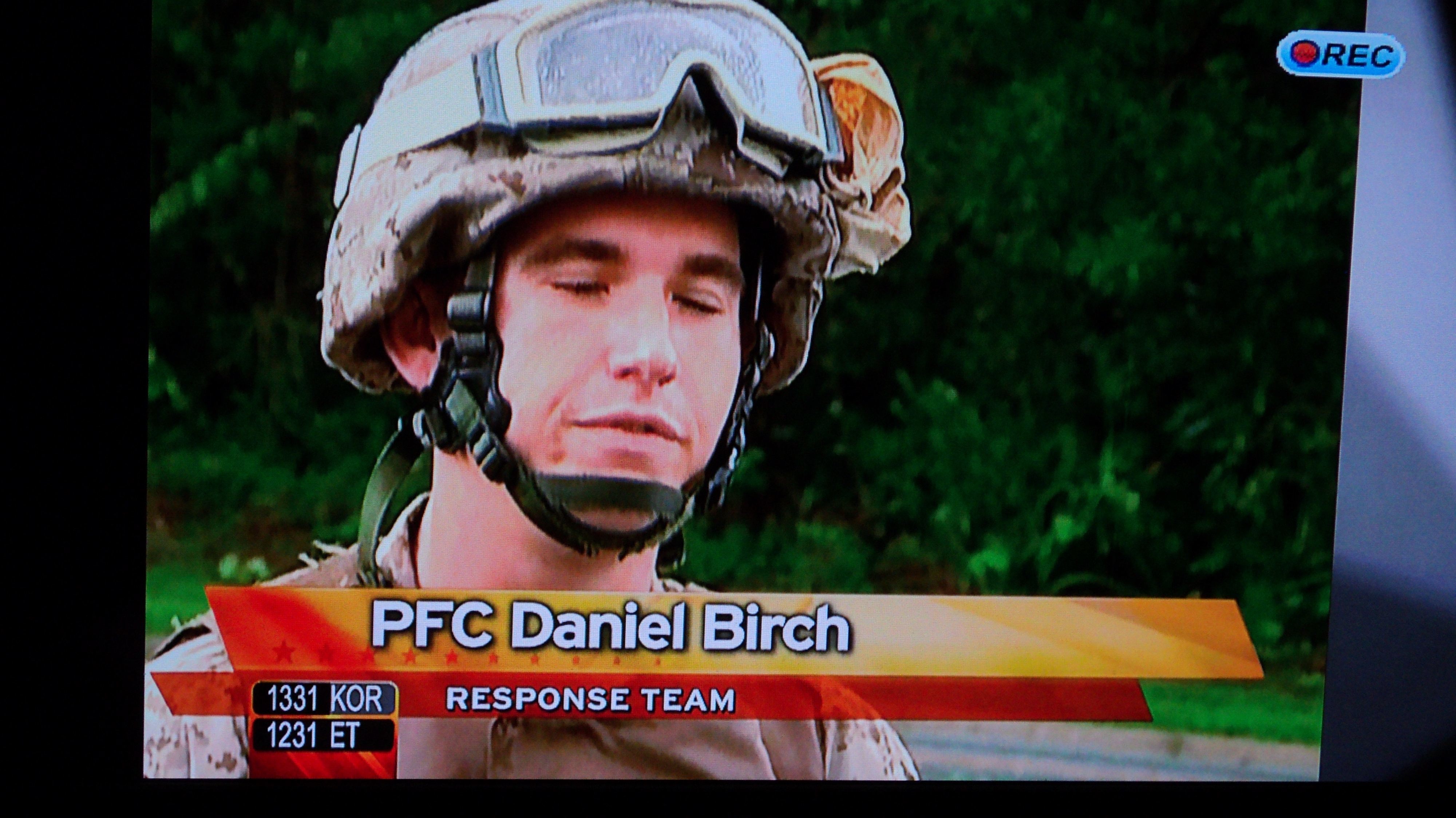

I also use a FreeAgent 500g USB powered hard drive with no issues with NTSF with all space available. I will attach a few pictures so you can see.
As far as the screen when recording press the info button a few times..If you have more than one recording on the drive you will see that, and can select right there what to view.
Pressing the info button again will clear the info bar. you will just have the small rec logo on the top right corner. It's just showing you that you are in fact in record mode. Myself I don't see it much different than viewing many channels that have the logo showing in the bottom right hand corner..Such as RTV and others.

First I did not notice the Yellow Format button... that will help out greatly! Thanks!

You must of completely missed the post by woofy above........ The Manhattan does NTFS.... I use NTFS on my 500 gig Westerndigital. Click on the pics that woofy posted to see for yourself.
Now to make an observation... There seems to be many that are reporting trouble that is actually nonexistant. As an example I will use the post a couple above where the dish was moving to true south alot. As it seems now that was an isolated problem with a certian setup... Not the fault of the receiver. And again with the NTFS question.... People seem to pass judgement if something isn't right with their particular setup when the answer is right there in front of them. Everyone needs to be a little patient here and let the legitamate problems, (Like the 22khz not working right for example,) get worked out. Then with a little more time everything should fall into place. People might say "We don't have any info so we don't know what we are doing! Don't blame us!" Well my friends the fact is that with new firmware being worked on at the present, so we've been told, It kinda puts the kabash on any further tutorials as the implimentation of new firmware can change the way the receiver is operated. Maybe it won't but chances are it could and if that happens then the info posted at this time on the operation of the receiver will be obsolete. Maybe people will disagree with my view, but I tend to do things once, not two or three times as that simply wastes time and causes more confusion. Just my little ole humble opinion.....
Now back to the hard drive.... Last night I erradicated a drive and plugged it in.. Didn't see it. Just like any computer. My computer didn't see it until I went to the "Disk management" area. I gave it a quick format in NTFS and then plugged it in and the receiver saw it straight away. It has been my experiance in the past that some drives that say they are "pre-formatted" simply do not work until you format it for your machine weather it is a computer or a receiver. Have a great day!
